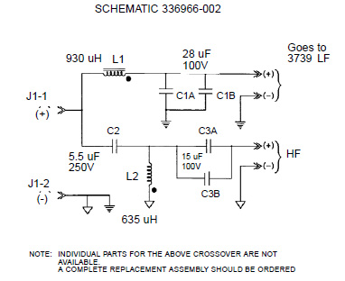

However, if it's just for assessment, then you could use the curves/data from JRX115/215. The 3722 cinema speaker also has the same driver (twice, called 3739LF) in case you're looking for a network diagram. Hope that helps.

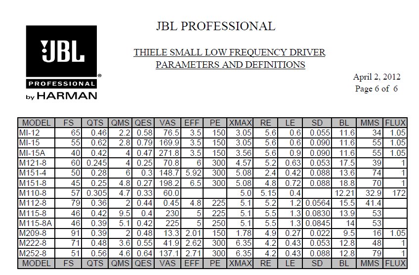

From the T/S parameters, the main highlight in case of this driver seems to be its 50g Mms. Expect all kinds of breakup-related issues along with the resulting mid-range extension of the paper cone.

Thanks. Yes,, the driver I have is the same version - M115-8A
I came up with very close TS specs so it must be the same one.

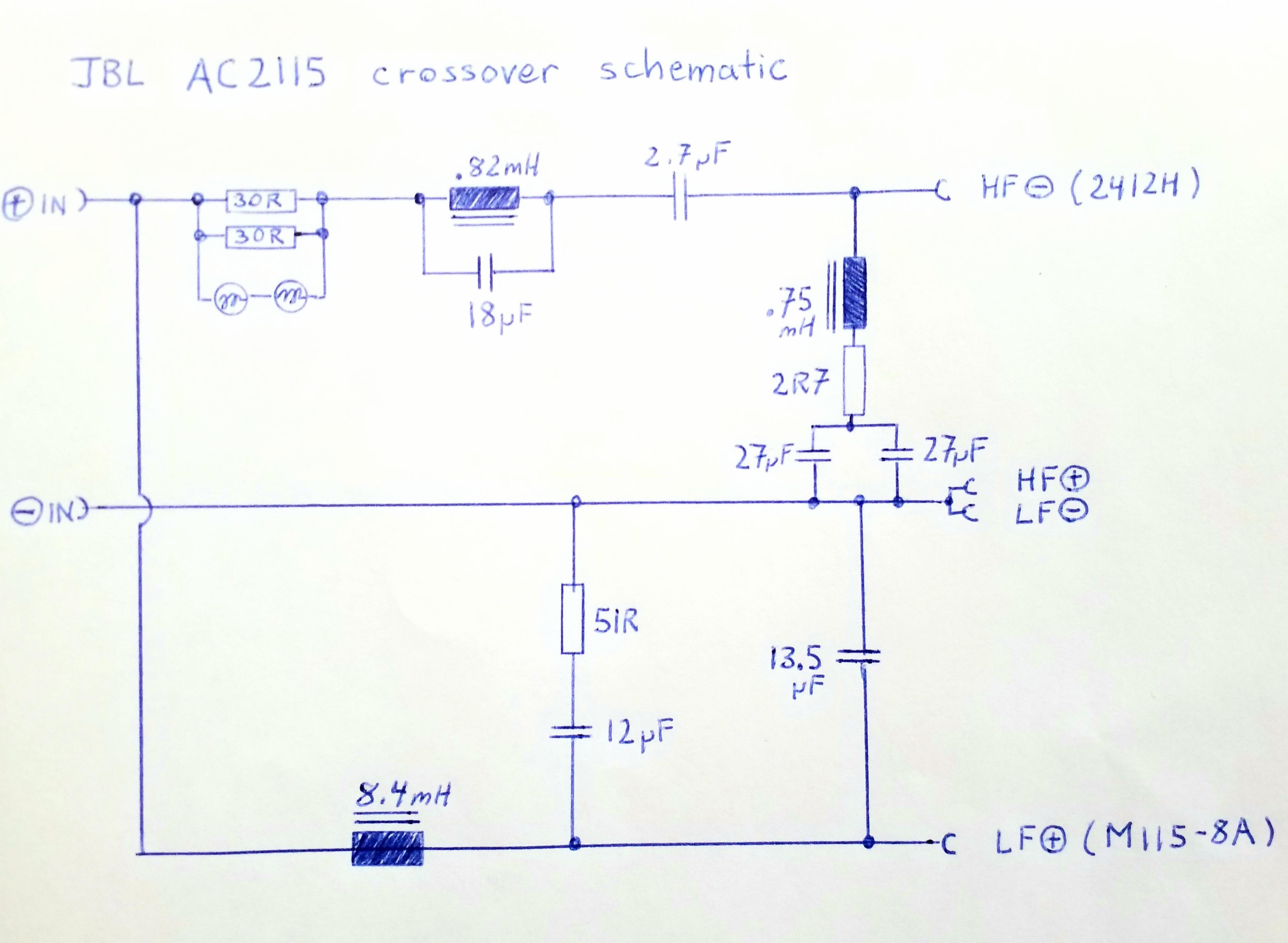

You have the schematic for the original crossover?
I have to decipher it from the assembled crossover. I'll get back to you on that...

Here's the schematic.
The 8.4mH inductor and 51 ohm resistor aren't a typo. I measured the inductors since their values weren't marked.
The two round symbols under the parallel 30 ohm resistors are protection lamps, so they should be around 1 ohm insertion resistance cold.
JBL states a 2100 Hz crossover point, which is high for a 15" LF driver, but the 2412H HF driver is so wimpy that it can't deal with a lower HP frequency.
A B&C DE 250 would work well here and even the cheaper Selenium D220TI. Both would be a massive upgrade to the 2412H and would need some amount of padding. I've run the D220TI in the JRX115 with good results but its definitely not a drop in replacement if you want a reasonably flat FR. The M115-8A doesn't sound half bad for a cheap woofer, but it lacks definition and clarity (sounds a bit fuzzy and veiled to me) compared to the middle of the road 15" drivers I'm accustomed to.

Looking at the huge 8.4 mH inductor in the LF LP, I would think the woofer had some serious rise in response, requiring a lot of BSC to flatten it.

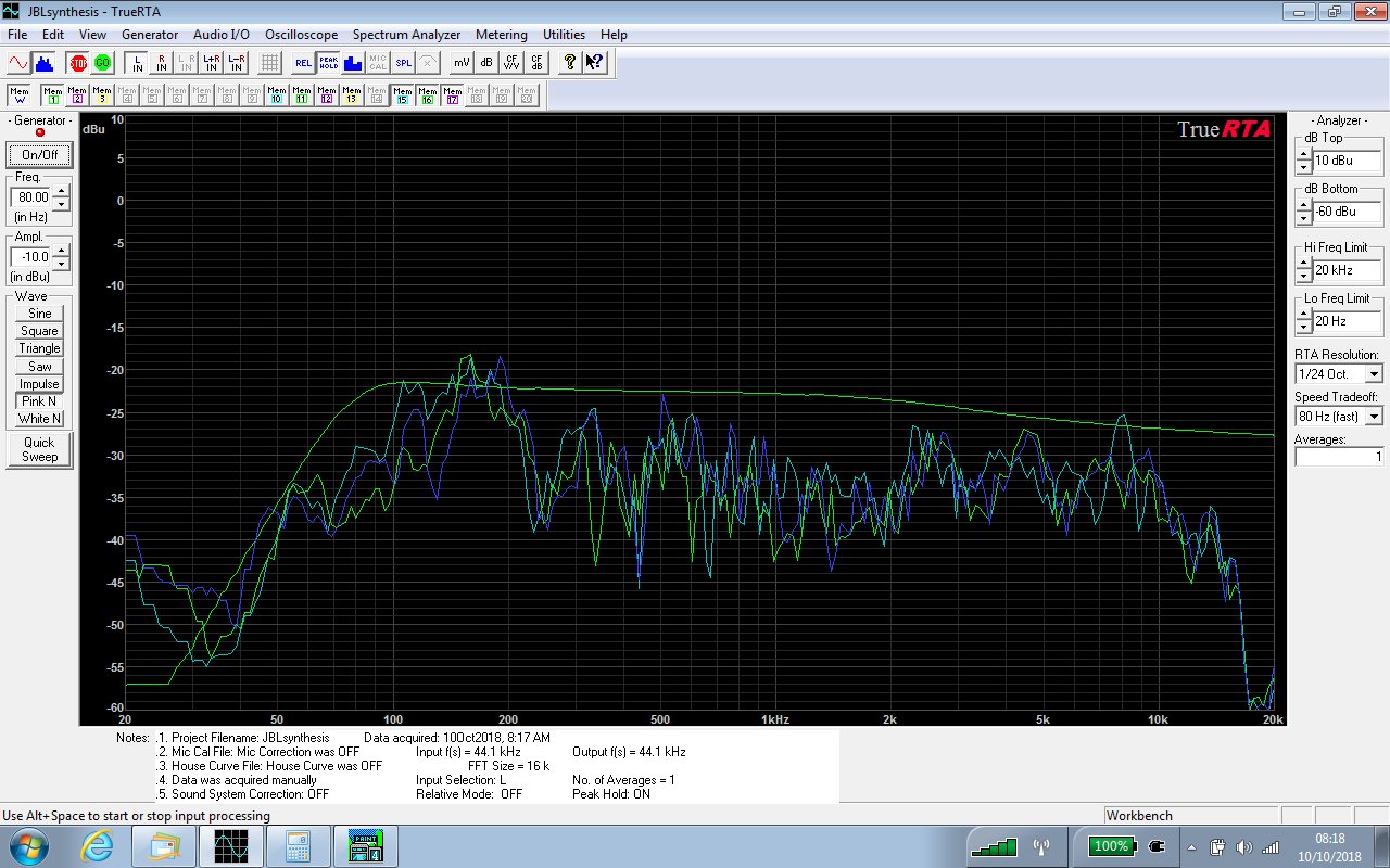

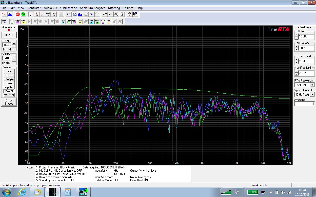

JRX in room with an 80Hz high pass. Measured at 3 positions across a couch, left speaker then right speaker.
The smooth line is the Harman curve.
Looks like the original just needs an L pad to bring down a bit if a little harsh.

The crossover is really simple though. A 2nd order electrical low pass plus zobel. If a driver can be controlled with this then it's well behaved.
You need a primary inductor as large as that for baffle-step compensation when you've got a baffle as wide as a 15" driver requires. Not to mention the low crossover frequency that JBL will be using.
