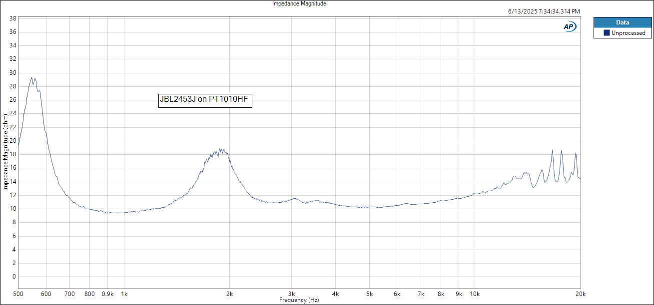

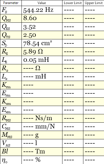

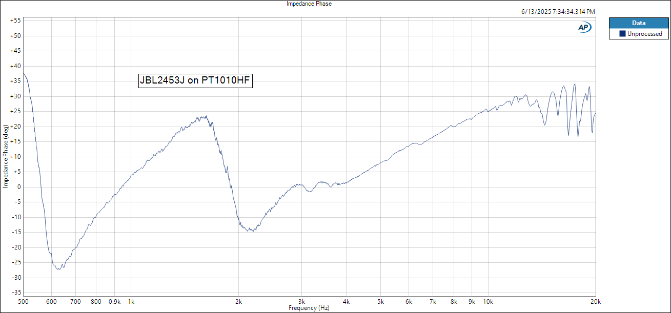

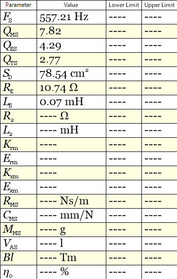

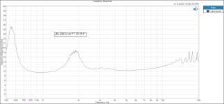

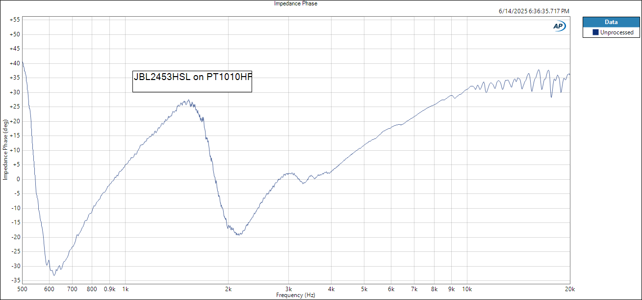

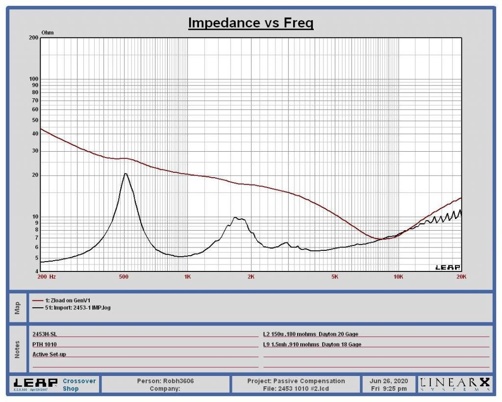

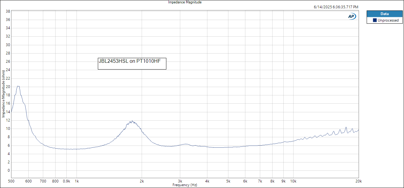

Hello DT
I cross them at 1.5K 24dB active crossover. They are in a 4 way so the driver below is a 2123 10". You should have no issue at all say 1K or a little lower if needed depending on the upper response of the 2204. I posted a measurement which shows the extension even on the 1010 you might get better loading on your waveguide. In case you don't have it I attached the driver PDF. Unfortunately we don't have an actual measurement on the LH site.
Rob 🙂
Rob 🙂
