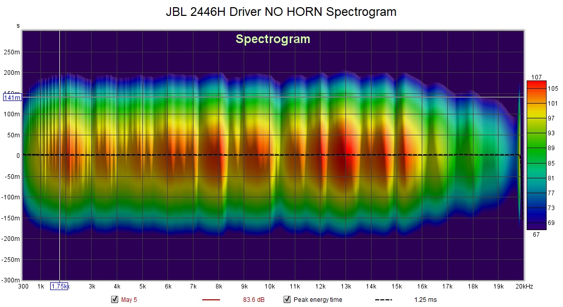

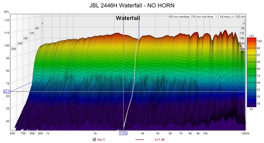

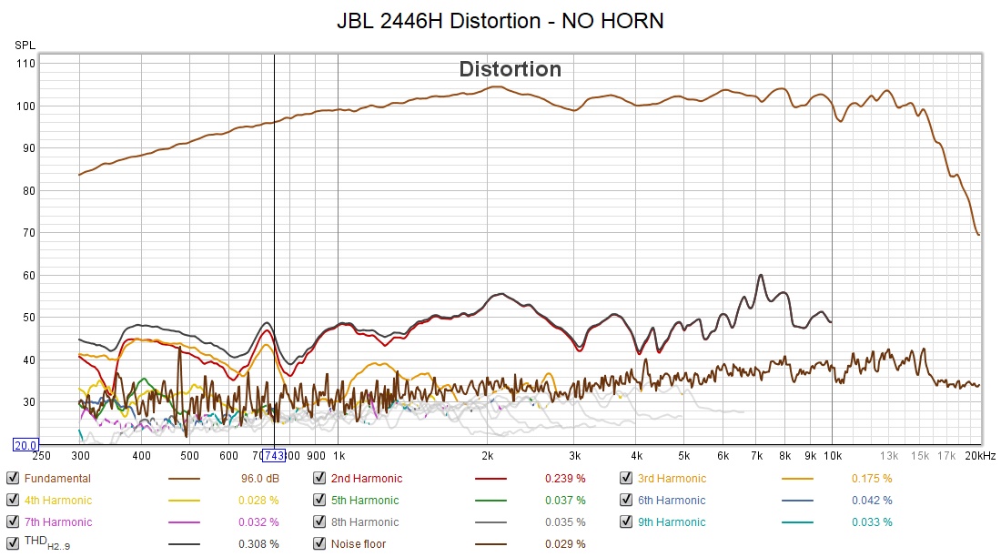

For the last year or so I have been building a multi cell mid-bass horn, purchased two, used JBL 2446H drivers, along with putting together a measurement system. The horns are built, and have tested the JBL drivers
and have some data to post to inquire about interpreting some of the graphs. I have a fair driver knowledge, but lack the interpretation skills on the REW graphs
All the graphs are just the JBL driver alone, no horn. I used REW software, with a Mini DSP mic, the mic was positioned 2 inches away from the driver exit. Below are .jpeg graphs and data files

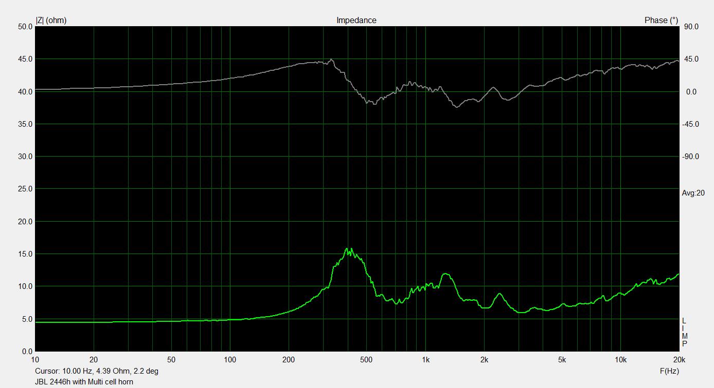

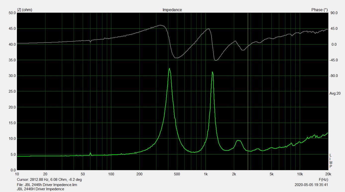

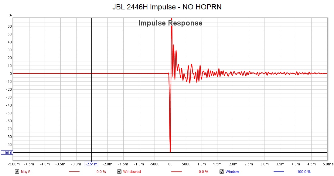

My concerns are the spectrograph and impulse graphs, along with the impedance graph with the large second spike at 1300 Hz, as this is in the mid-range being reproduced by .
Does the spectrograph look normal, or is that proof of a damaged diaphragm?
Does the Impulse file look normal, or does the graph show ringing ?
The Impedance rise at 1300Hz will need some suppression?

Now, to the graphs you've posted, I don't see anything jumping out, though I'm not as experienced reading spectral graphs. The response, distortion and impedance look ok to me. You might spend some time looking through other threads of measured 2446's. They wont be exactly like yours of course, but should give you bit better reference.

I went through this last year and I would like to find out more. Youtube had limited information, I think I spent some hours over a couple of days looking for procedures.
I agree that the impedance shows an effect similar to what Tom shows. Is the buzzing necessarily related to rubbing on the pole piece or also just the diaphragm not being centred?

That's a good question, I was told that it has to do with centering in the gap. I've certainly had some buzzing from rubbing as well.

First things first, there is nothing that presently suggests your diaphragms need alignment, or are defective.

Having aligned HF diaphragms for over four decades, I can say there is no particular frequency that is "good" to use, as often just one narrow frequency band, sometimes only a few Hz wide, may trigger the “buzz” distortion. For that reason, misalignment distortion may not be at all evident except with certain musical passages, making music, pink noise, or even specifically spaced sine wave tones near useless for alignment.
In most cases, low frequencies of several octaves below the usual pass band will make the harmonic distortion most audible. After determining a reasonable mid pass band output level, slowly sweep from 200 Hz up, listening for "buzz". Most times the range between 200 Hz to 800 Hz will reveal the "buzzing", but I have found a few diaphragms that only buzzed when driven at anywhere from 800 Hz to 5kHz or so.

I'll repeat: There is nothing that presently suggests your diaphragms need alignment, or are defective.
There is no reason to open up your drivers if you hear no buzzing when doing a slow sine sweep. Don't "fix it" if it ain't broke 😉
