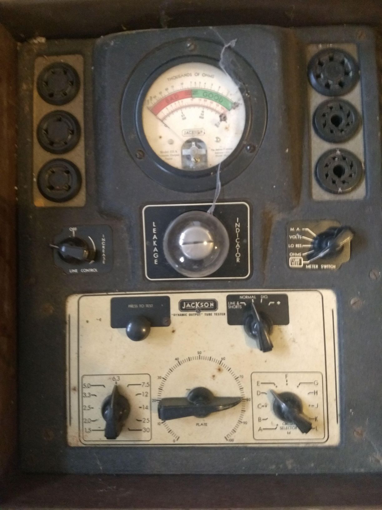

It is a Jackson 535A which as near as I can tell was made between 1935 and 1940. I haven't been able to find any information about that model online so I have started emailing people who use, collect or sell vintage tube testers asking for help. In my searching I came across this forum and after reading some posts and threads it looked like a place that might be able to help me find information as well as pointers for working on old tube equipment.
I have no literature for this unit. I would like to rebuild it to working condition simply because it was my grandfathers rather than any practical use I could get out of it. I am hoping to get some leads on where I can get the instructions, reference chartsor schematics. Any help would be appreciated, so far this particular model had been very elusive.

This one is an emission type tester. It's a great idea to rebuild it, just don't trust it for service work. If a tube measures bad on it, it's bad. But a tube that measures good may also still be bad.
It's a good brand. I might have the same tester down here somewhere. My plan was to rebuild it as well.

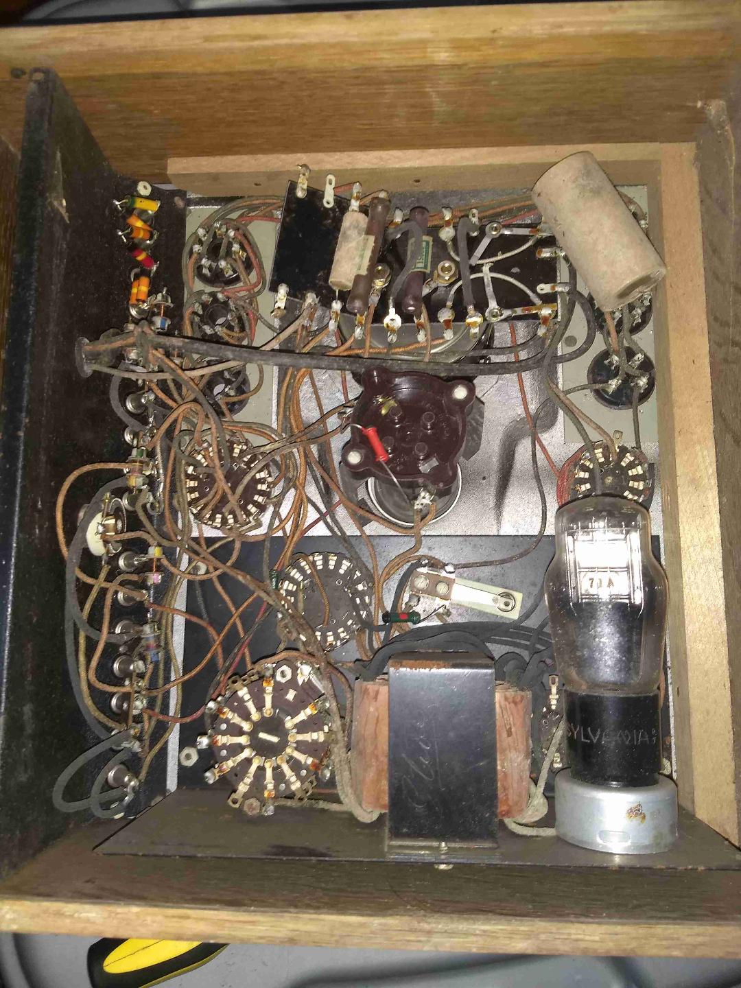

I took the back off of it the other day, doesn't look too bad. I removed the old 71A tube on general principal and my local electronics store had one in stock. Before I go much further I plan to trace the wiring and make a schematic as I haven't been able to find one. I also found a large 1uf 200V capacitor loose inside, it had come off on both sides. If you do happen to have a 535a in your collection could you please send me a picture of the inside so I can see where the replacement needs to go?
I'll try to upload a couple of pictures of mine. I haven't tried that yet so I might not get it to work.
