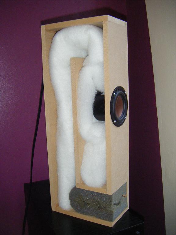

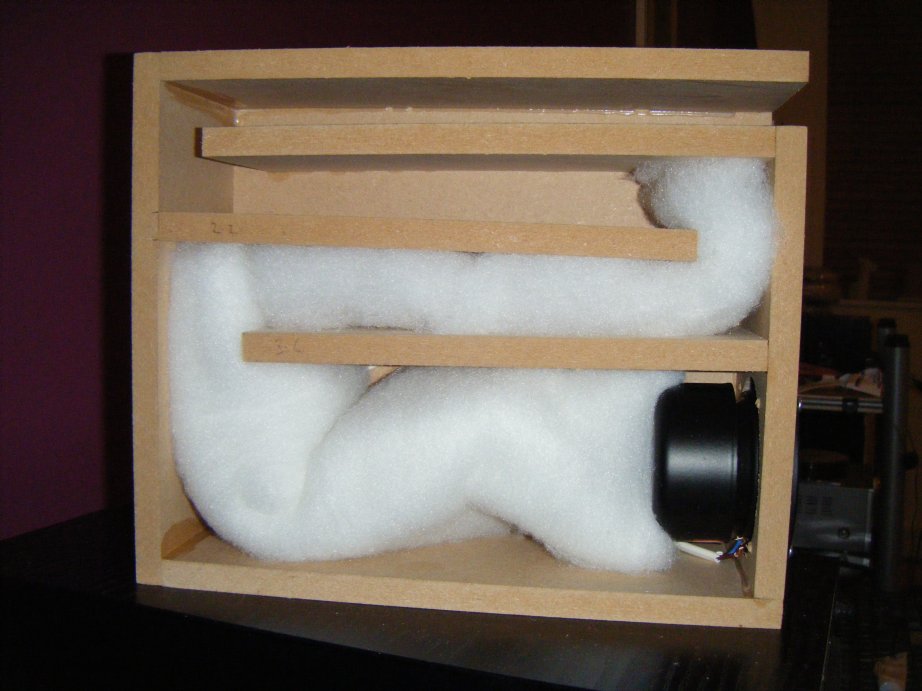

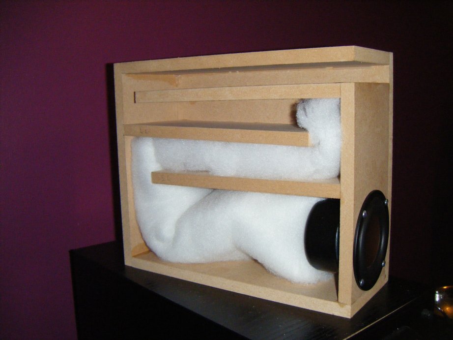

Driver is a B3N from IPL Acoustics, do you need the specs? Fs is 77, Qts 8.6, I didn't take anything else into consideration, but since making I've learnt a bit more about Qts and the BL too
TL is small, tried to upload a pic but they are about 3meg in size, tuned to 77Hz which is the drivers Fs, line length 1.05m folded into 4

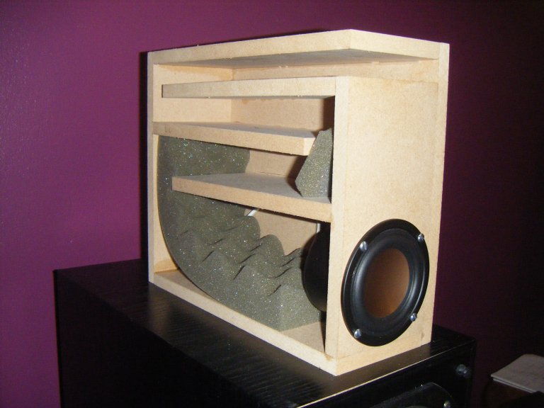

Yeah thats the one, xsection goes from 39.2cm2 to 14.7cm2
I messed up a bit with the xsection as I read from the speaker above on the chart, and I used my own measurement of the speaker area and put the area at 19.c when it should have been 30cm2, though I dunno how they come to that number, it doesnt curve that much.

Ah! I don't believe there's nearly enough stuffing in there, and of the wrong density too, I'd imagine. I have larger TLs, and note the same thing as you - I'm going to go into them next week with some (more) old pillows and see what's afoot, measurement mic will arrive also soon and so I'll see if the over-powered low end is coming from a) the TLs themselves or b) just a room resonance.
You might try to stuff it more like this :
The line is too long even un-stuffed for a 77 Hz tuning, it needs to be around 87 cm long, so once damped it basically has a large sealed cab's response.
That said, its Qts is high enough that a ~89.5 Hz tuning yields the widest ~flat BW, so you may want to consider building new cabs.

I've gone off the usual 1/4 length and lopped off a 5% that I read somewhere to do with the way the port interacts with the room?
Tapering the line as you have means that it needs to get shorter to maintain tuning, and to get max bass you need to tune a bit higher than Fs, and then there is end correction (the 5% would be a simplification of getting that).
You could always cut the top off the box (the end that the last fold is in) and see if it gets better.

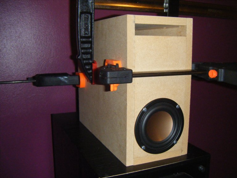

Fair play, I will give you that one, taken from the AlphaTL I take it?
This has a much better sound, straight tube, tuned to 89Hz ish, about 91cm long, 2x Sd all the way, PMC type design
Almost prefer this to the RTL3s
Not such a big fan of the height though, I dont like speakers that are 75% cabinet
