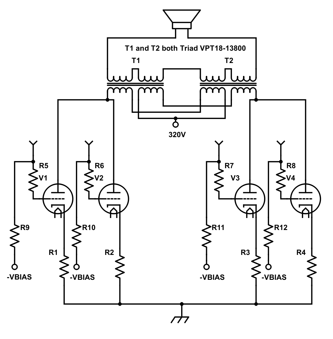

I get flat response from ~25Hz to 50kHz with the Triad toroids... Use two, and wire them series interleaved.
Here's an example using push pull parallel 6P45S tubes wired in triode. This output stage makes 112W @ 30Hz.
In this way, you don't need to overspec the transformers as much. If you want 50W, use two 50VA coils. Using only one of the coils, you get 112W at 50Hz, but only about 15W at 30Hz before saturation.

Beautiful cross-symmetric primary design. The VPT 18–13800 has (as shown) 2 primaries, 2 secondaries, costs $60 apiece, and is 200 VA max-rated. Nominally, 115 + 115, 9 + 9. The net, connected as these are is (in voltage terms, which is aggregate turns-ratio terms) 230-to–36 or 6.38 to 1. Recalling that
ZPRI = ZSEC • ratio² …
ZPRI = 8 Ω × 6.38²
ZPRI = 325 Ω​
Which got me scratching my head. Not exactly sure that's what you intended, right? I am probably missing something in regards to the cross-hooked primaries.
Or maybe not! The +320 V supply (in diagram) will only realistically support ±295 V of swing in the push-pull configuration. This corresponds to what, 209 VRMS. Stepped down 6.38× to 32.7 VRMS. Which by P = E²/R … = 32.7² V / 8 Ω = 132 W…
Basically within 'shooting distance' of your claim.
Nice work.

The primary is connected in series, so ratio is 460-to-36 or 12.8 to 1. Z primary is about 1.3k for an 8 ohm secondary. To get 112W, Kodabmx must be using a higher B+ or lower load impedance.
112W at 30Hz (or 1 kHz) was tested using a load of 6R. It uses 6P45S triode connected.
Also VPT18-13800 is rated at 250VA, not 200VA :)
Here's the full schematic:
