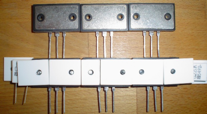

aluminum oxide insulators are the best
I've used AlO2 insulators from the mid '80s (thick ones) till a few years ago (thin ones from Avid Thermalloy).
There's better nowadays, and it's pretty in pink :clown:

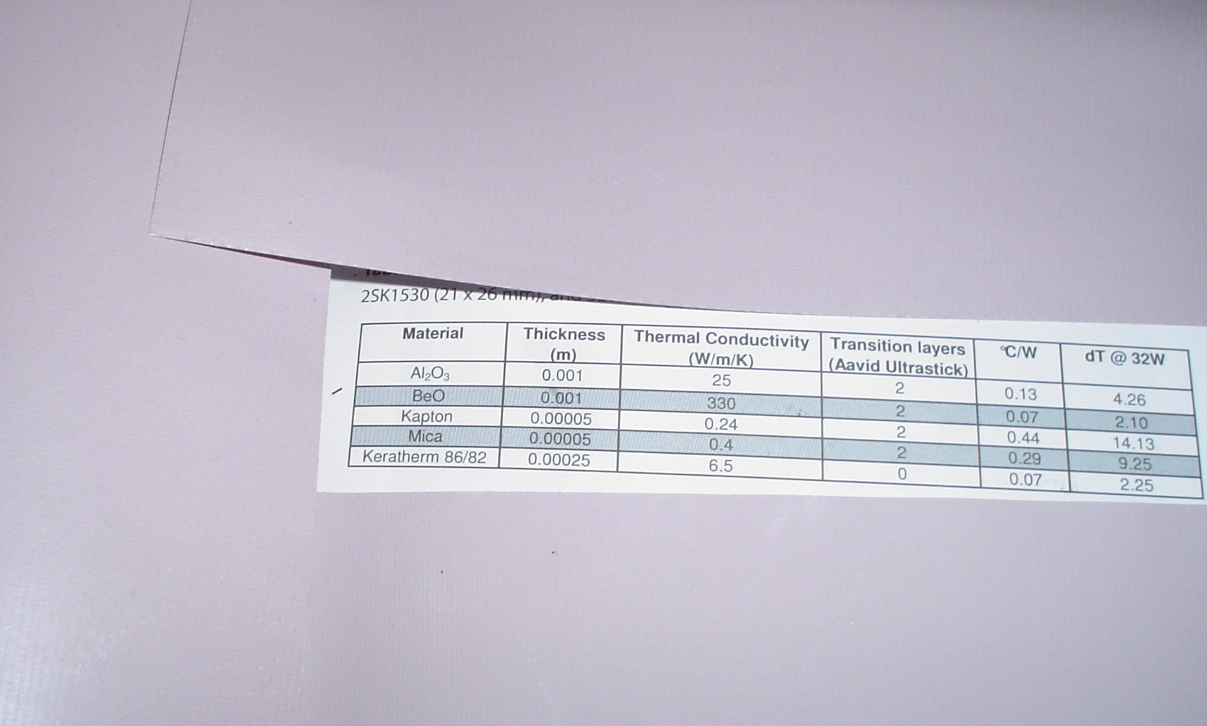

(compliments go to EUVL)
Very intereresting, Jacco.
So this means this time ESP is wrong recommending Kapton ( I believe they also sell a tape of that material).
BTW what about the source of your numbers?
a) Scientific paper subjet to peer review (i.e. IEEE)
b) Commercial (then, most probably biased)
c) Own measurements
EUVL's article in Linear Audio -Volume 3 by Jan Didden.
Patrick's formal education and experience level are just about the best credentials to have for this kind of thing, i'd think.
Folks have been wrong about Kapton for quite some time, Kapton vs Mica has been discussed on this forum several times.
Mr Elliott can't been right all the time. :clown:
As Patrick/EUVL, i've tried just about every insulator material over the years.
I have mica insulators in every size, including plenty of very hard to obtain MT200, still have some Kapton Bergquist K-10 sheet, AL2O3 insulators in several sizes. (+ oldy AL2O2 in 4.5mm, 2.9mm, and really expensive silicon sheet leftovers from the '80s)
Aluminum oxide insulators are not manufactured in MT200 size, to still use AL2O3 insulators i resized TO-247 ones with a diamond blade to reach a higher dissipation level than with mica.
=> http://www.diyaudio.com/forums/atta...25d1133198612-krell-ksa-50-pcb-thermalloy.jpg
The Keratherm red 86/82 is so much easier, i cut sheets accurately to size with a guillotine paper cutter (as it's so thin&flexible, the Keratherm on top of a sheet of paper).
Holes are just as easily punched, and the best part is that the pink stuff does without thermal goop. (thermal paste makes it perform worse)
For some devices, mounting bolts/screws still have to be isolated from the package.
I check for conductivity after mounting each device just the same, whatever the package, no matter whether the insulator is mica, aluminum oxide or Kerafol.
