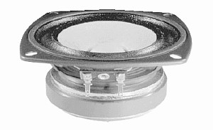

Here is the Fostex FE-103, around £26 in the UK.
Here is a "4 inch mid-range" from a place called Cornwall Electronics, selling for £9.99
Look at how similar they are. I wonder if they're actually the same driver, but just differently coloured. Maybe I should order a couple and see how they sound?

That is a Radio Shack 40-1197 which is no longer available. It is not identical to a FE-103. I understand that the cone and frame are different but that the magnet is the same. The FE-103 is said to have a touch less bass, but more extended and better highs.
I recently picked up four of the 40-1197. I am thinking of trying them in horn configurations.
There is quite a bit of information available on the 40-1197.
Just like most driver manufacturers, Fotex will make OEM drivers for other companies. That looks very similar to one that was sold by Radio Shack here in North America under the model number 40-1197. On the back of the magnet was the RS number and also the Fostex number FE-103. If you could get your hands on one your question may be answered right there.

If it is a FE-103 variant you could possibly have a diamond in the rough.

That is a Radio Shack 40-1197.

bigwill said:Oh well, it's a shame it's not the real thing. Is it considered a good driver anyway?
When modified it is a very good driver for the money. Add one of Planet 10's phase plugs along with damping the frame and coating the cone to get the most out of it.
