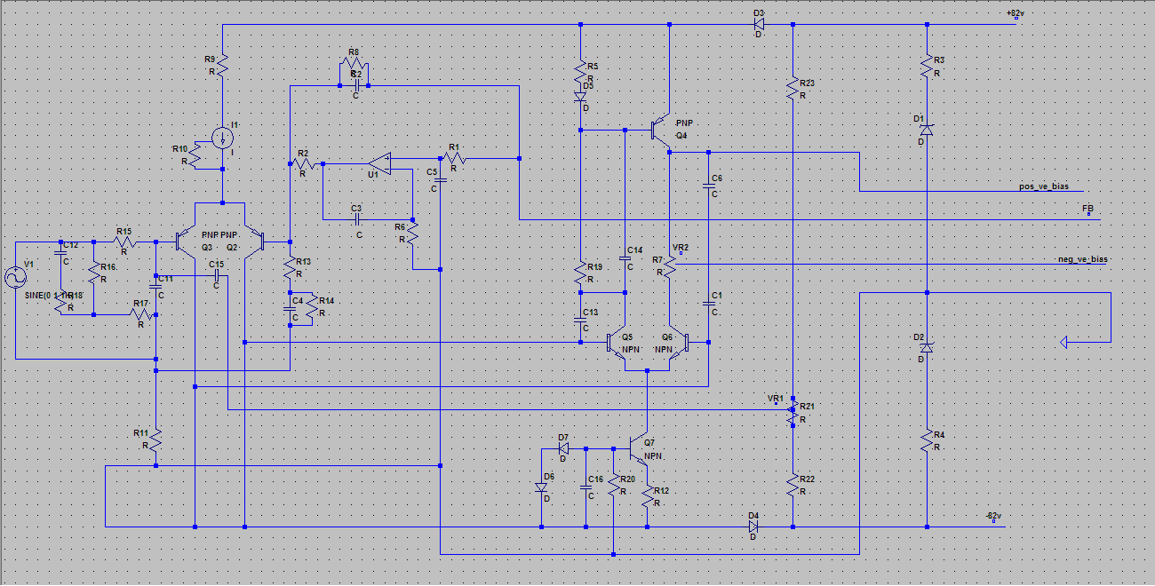

This whole circuit looks strange to me. Whats VR1 doing there?
Anyone familiar with the design?

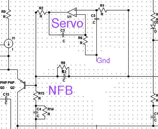

The servo seems normal. The pot may be for hum or noise balancing.
You have the balanced output of the LTP, Q2,Q3 collectors, both connected directly to the negative rail. Consequently, so are the bases of the balanced VAS transistors, Q5,Q6. Are there not a couple of resistors needed there?
The servo is straightforward, once you separate the essential NFB parts from the added servo parts.
Bottom of your diagram, V- and Gnd seem to be connected and is likely drawn wrong.

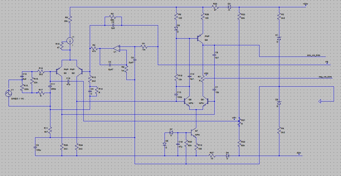

Ahh... thanks 🙂
You are quite right. I skipped some components that diddnt relate to the servo or pot-circuit.. but ended up drawing most of it. So I might as well finish it.
