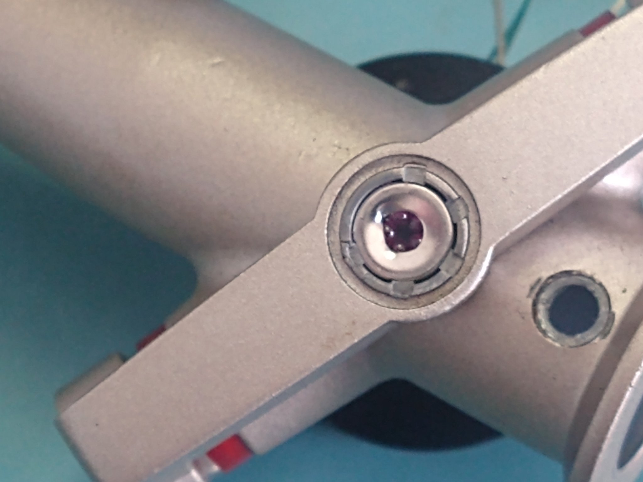

Technics SL1200 tonearms use a double gimbal with spring loaded pins. If the TT has been dropped with the counterweight on the arm the pins may have damaged the cover over the balls. Dismantle the tonearm and massage the cover so the balls run freely, I'd also check to see the pin has no damage. These tonearms are hard to beat at the price.hi Hugo,

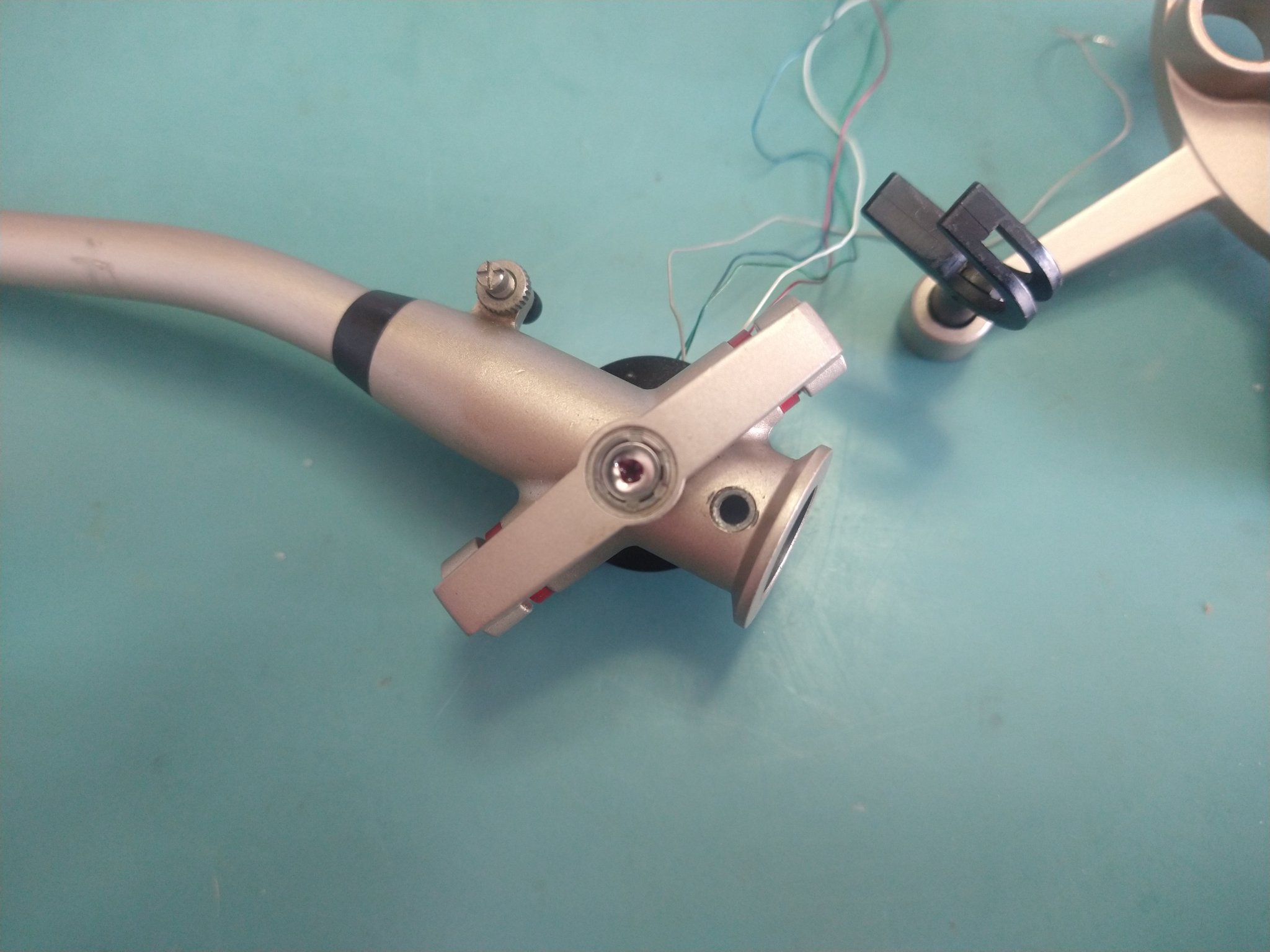

This is an EPA-100 but the bearing setup is the same. The bearing is the top on under the top screw. You can see the bent cover over the balls, in this case they are ruby balls which are badly damaged. Your arm uses steel balls they should ok.

Thanks for sharing the pictures. So the idea is essentially to remove the top set screw and massage/move the bearings inside a bit? Should this also be done on the sides as well? Also, should the tonearm be removed from the tonearm assembly before this is done?
Be prepared to intercept all the bearing balls that will fall out and plan for a way to get them back in place. 😉

Good point, I put a bit of solder into the opening this prevents the balls falling through the bottom opening which is a PITA and very difficult to get them out.
