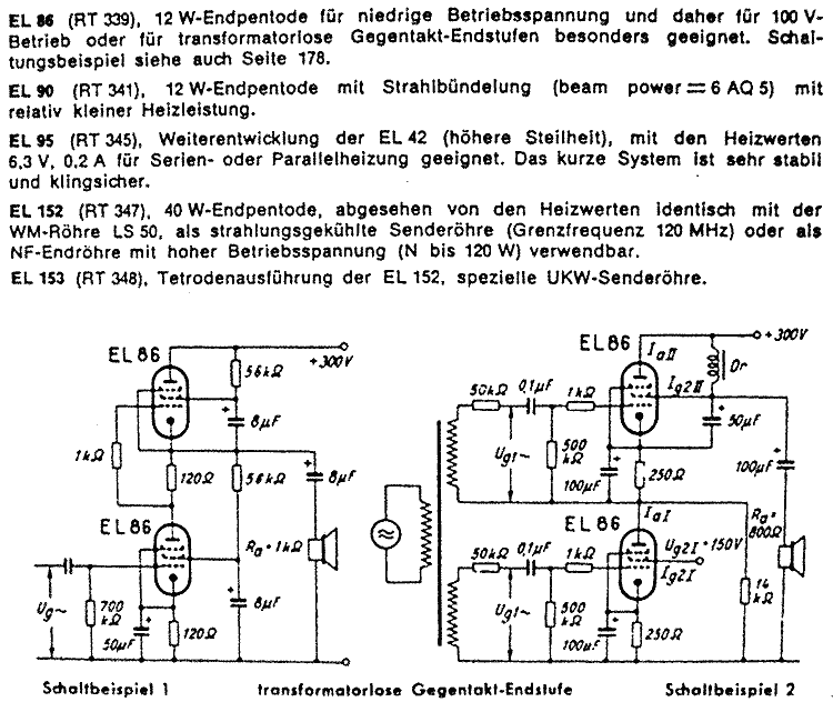

These are definitely C-cores probably pull-outs from a Philips OTL.
These amps allowed for either low-z OPT couplig or C coupling to a 800R speaker.
I modded a few of those (in my less lazy period) and you can actually get pretty good sound from them even on more conventional speakers.
The circuitdiagram shows how they were operated with a pair of
EL86's.

Frank's picture is attached. I put these up on eBay and an astute bidder has informed me that these are double chokes for a Philips OTL. The amp, which had unquestionably had the smoke let out, is from a Philips organ and drove a 2-way 800 ohm speaker (12" + 6x8" whizzer cone mid-tweeter).

P.S. Headphone fans and SRPP afficionados take a good look:
very first SRPP used in an output stage!
