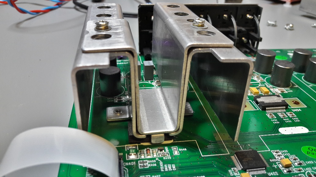

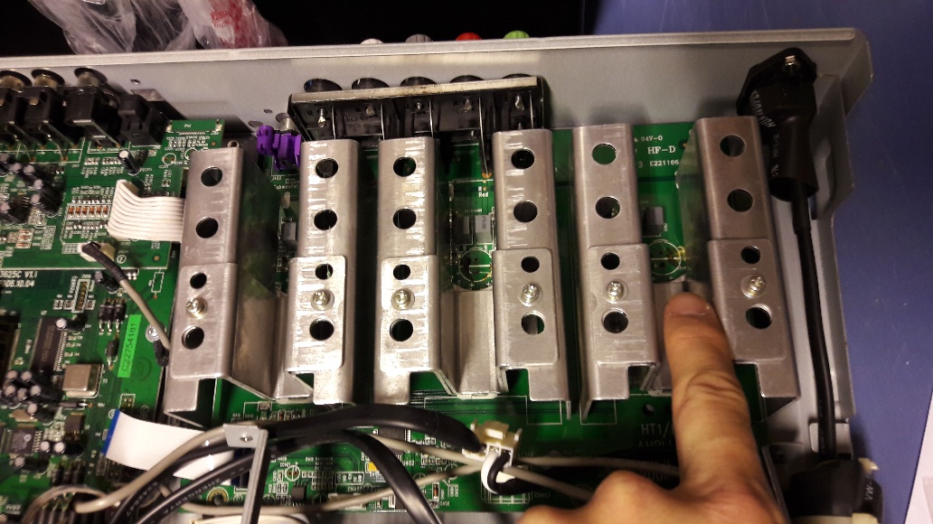

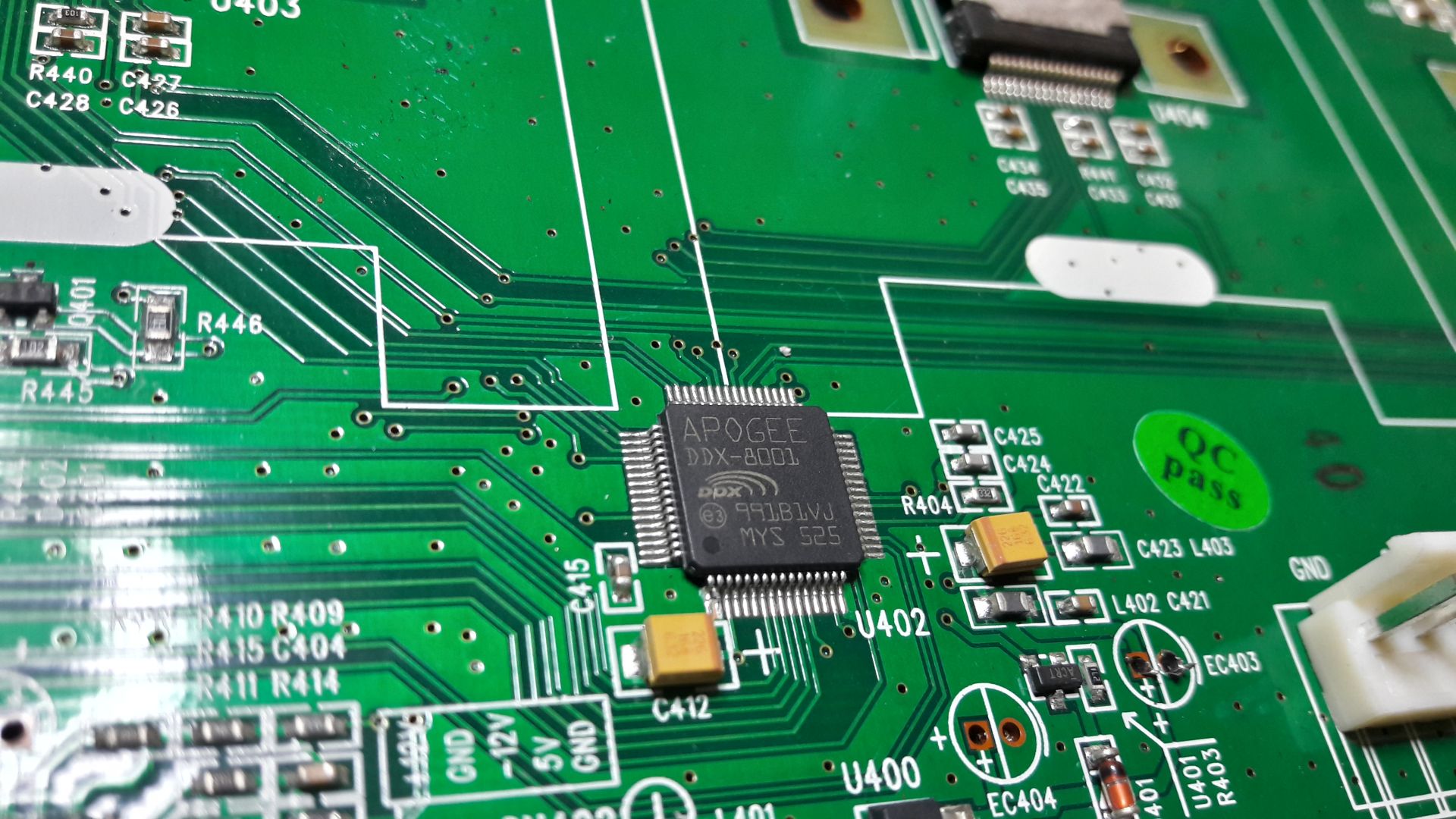

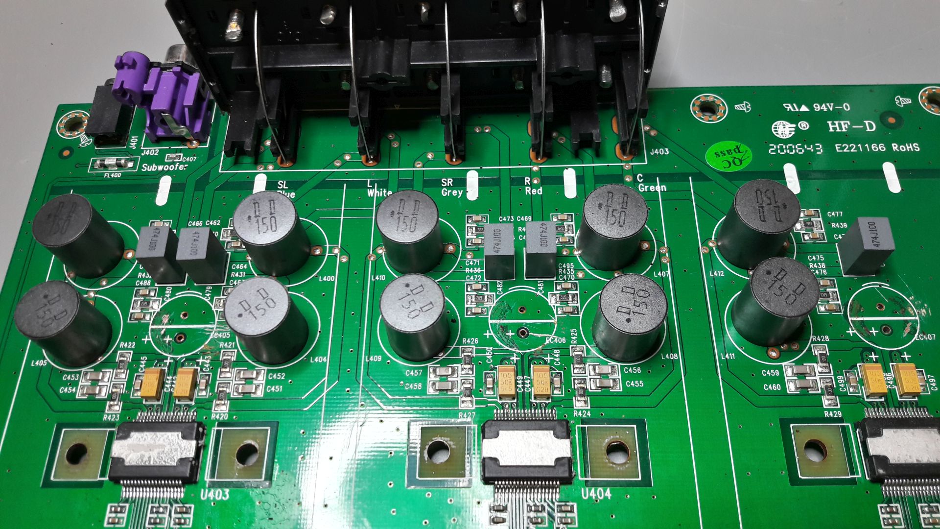

Harman Kardon HS500 + HS200
Hi
I refresh (hopefully...
an HS500)
On the amp boards i see this Power AMP DDX2160, and the DSP chip DDX-8001. According to the datasheet it is a very good combo. (2006
at the HS 200 model (stero model -2.1 channel) is the STA508 power amp and the STA308A as DSP.
Question 1
Which configuration sounds better?which experience do you have?
Which modifications make sense if you look at the pics:

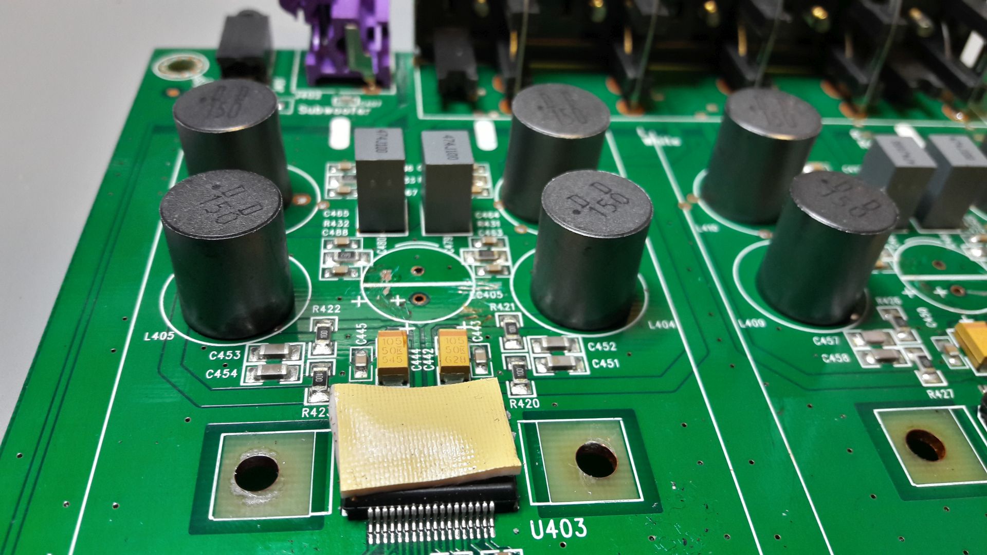

Q2 the original inductors are silver collored and magnetic shield and according to both service manual (HS 200 and HS500) 15µH..the power of both chips are about 4,5 amps so are the too small?
Q3
the original sticker to fix the colling plate to the chip is a double side sticker! is that a joke ???!!...i will replace this with washer in respect to don´t push to hard the screws for the cooling fan.
Q4
In the datasheet of STA508 (should be similar to DDX2160) is the Cap near to the chip recommended as 1000µf with 50V. but the power supply is 34V. so is that because of return energy from the speakers? or could i use a bigger size e.g. 4700µ with 35V???
the only topic is that the room for the cap is limited at 18mm diameter and about 40mm high.
thanks
