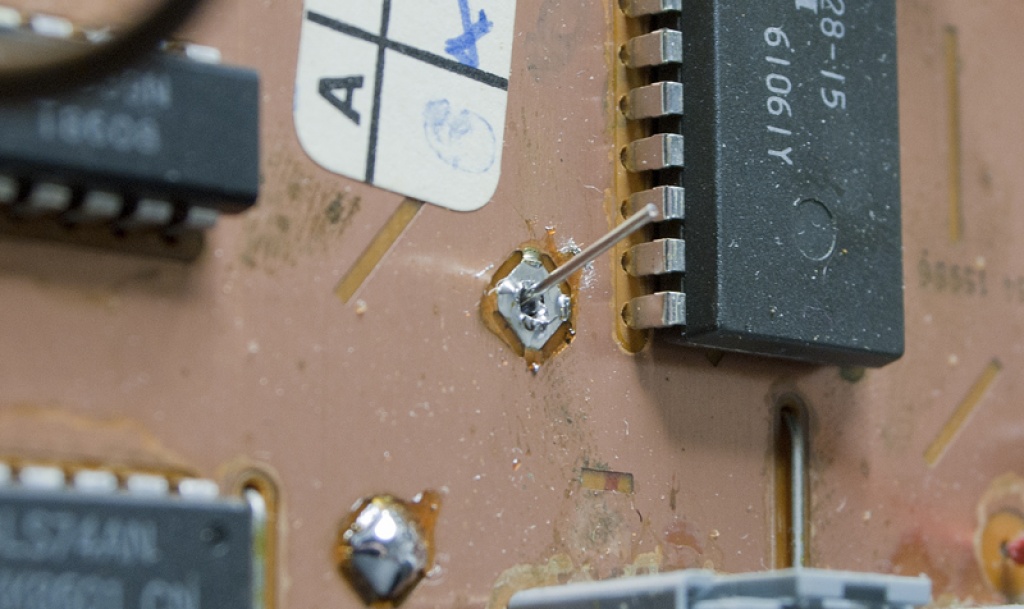

Attached is a better image showing what they physically look like (wire sticking through an unsoldered one)..
I just see a pad on the groundplane using thermal relief.

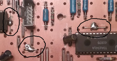

Could someone please tell me what these are? My board has 12 of them.
Also, there are 3 components on the back side...one is labeled TDA8808T and has the Philips logo.

The picture seems to show 2 griplets .

I found the circles on the page of the SM, saw that they are listed under mechanical parts, saw on the schematic that some traces terminate under the circle, but cannot find that symbol's description. Googling the part number did not reveal anything. I'm ready for my next clue!
I can only supply you with more information on griplets!
Griplets (also known as 'vias' or 'through board rivets') are used to connect the ground planes on stacked pc boards together.
A multimeter should confirm continuity between the griplets themselves and to the ground plane as well as the trace side where the griplets connect.

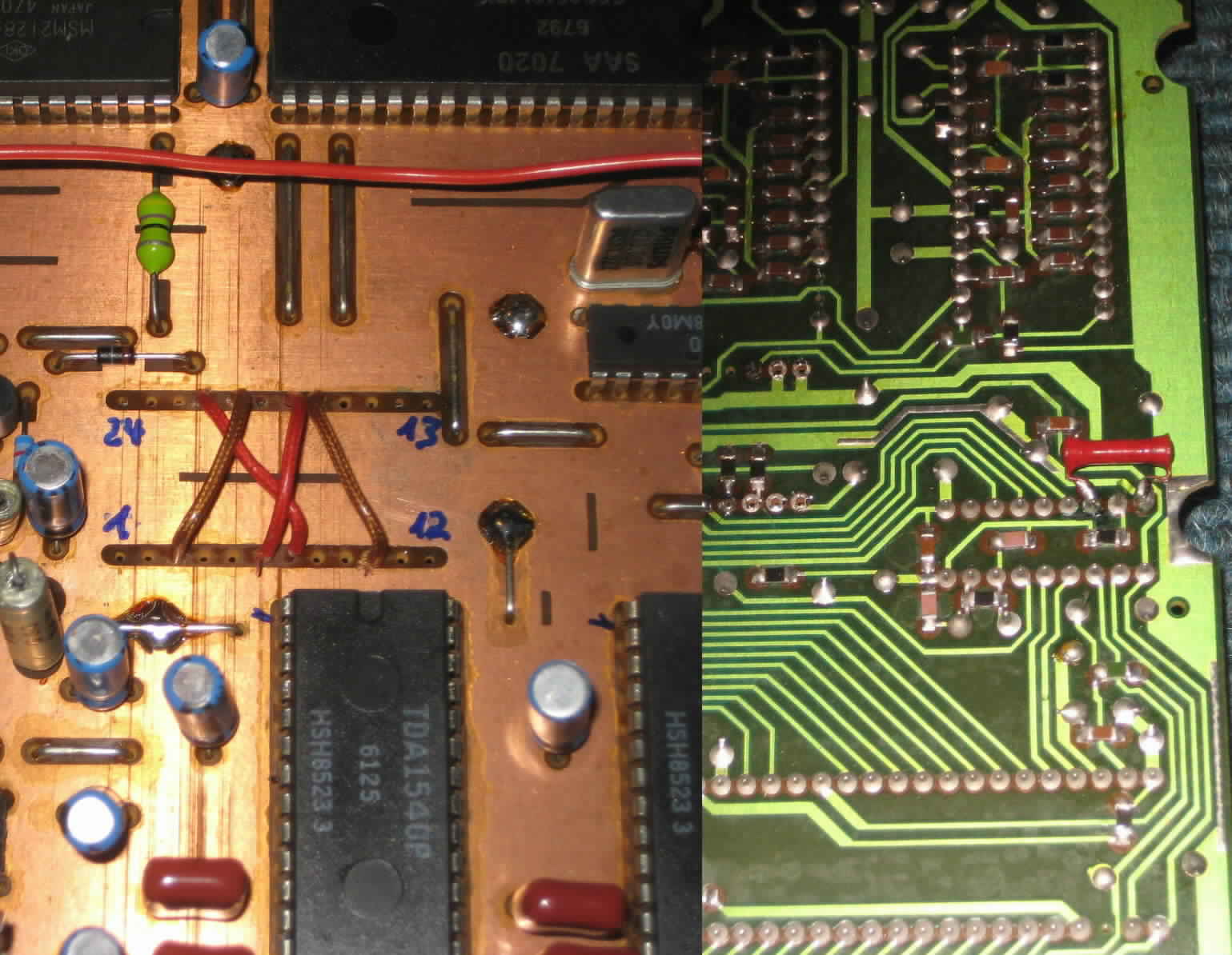

The whole thing is curious. There are jumpers all over the board, yet it's a 2-layer board. So why the jumpers, instead of just traces? Maybe it has no plating in the holes or something?
Anyway, the blobs connect the jumpers to the ground plane. Again, why not use a via directly to the ground plane?
I appreciate the help, but I'm getting lost.
1. Is the ground plane on both sides of the board?
2. If the back side of my board has 3 components, one of which is a SAA7310GP, does it qualify as a double-sided or stacked board?
3. Do need to drill a hole through the blobs and solder the ends of a wire to each side of the board?
Thanks!
Thanks!
No, the ground plane is only on one side (the one with the blobs).
Double-sided just means it has copper on two sides; the location of components is another matter.
There are traces on the other side of the board under the blobs. Drill through them and you'll short those traces out.
