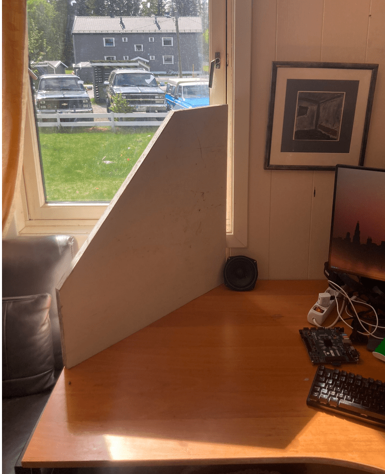

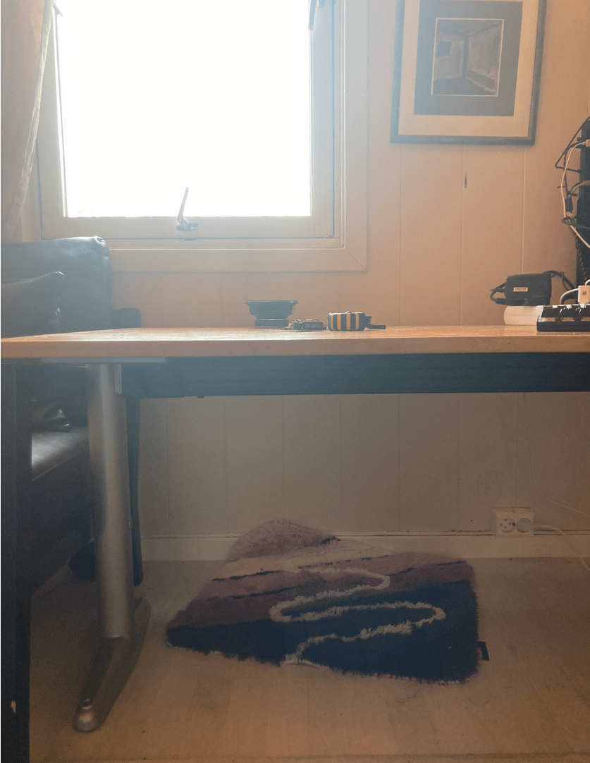

My first idea to test is to see if i can use my coumpter desk as part of a horn.

You are on the right track in the 2nd picture. In order to meet your goal, radical measures is needed. I suggest a corner on the floor position and the driver mounted in a triangle shaped (all 3 sides = 63cm) baffle - closed box and EQ. You need to make room in the corners and see to that the direct sound is not obstructed. Enjoy the best speakers in the world. Good luck!

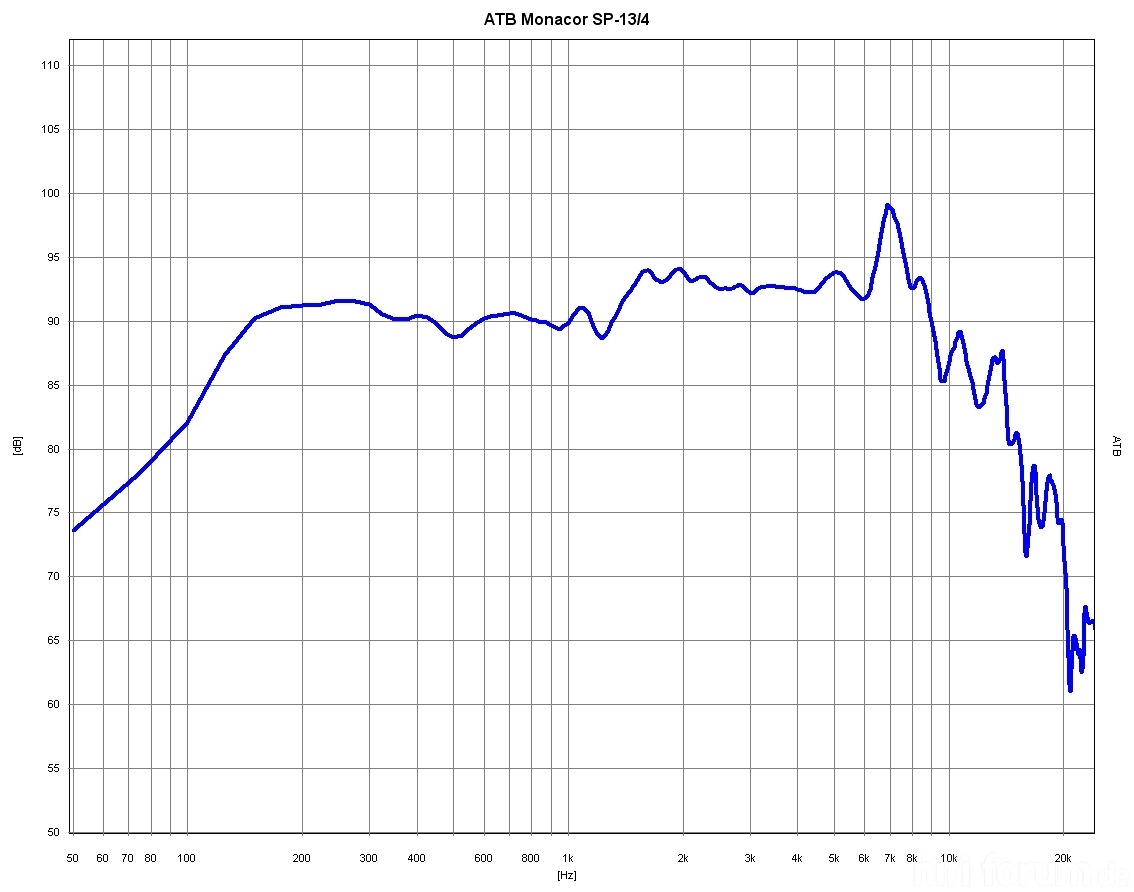

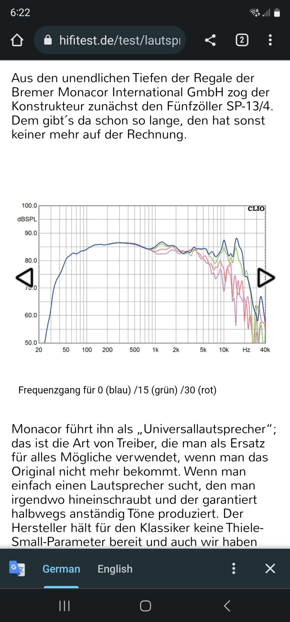

No curves, no useful design specs. The f3-8000 frequency spec. Nowhere do they say what f3 is.
dave
There are arrows on the image of the 'best sounding speaker in the world'. Just move it to the fr response. Even crossover is partly shown. Which is rather complex for 2way.
