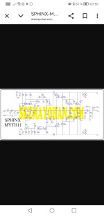

I am aiming for low distortion and nice soundstage, but reliabilty is first on my agenda for now. I now have 4 pcb's and am waiting for more components before I can continue the build. I plane to change 2 boards to look more like the Sphinx Myth 11 just to see if the different driver stage would make a difference. The Sphinx circuit is very similar and has different compensation in the VAS. These are good boards to experiment with. I not sure of Golmund's naming but they have a good reputation so to seem to a goid project for diy.
Your goal is good. I've looked at the Myht 11 circuit and wonder who cloned it from whom. 😉 I'm looking forward to your tests and feedback on the changes. As for the circuit board, I'm almost inclined to etch my own. What's holding me back is the lack of time. I'm too creative and full of audio projects. I'll be busy with them for the next 10 years. That's why I'm sticking with the Hm3s. They're really versatile, inexpensive, and the amp doesn't sound any worse for all the tweaking on the circuit board. No, quite the opposite.
