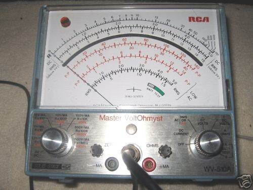

I've got a couple of these RCA (VIZ) Master Voltohmyst's which have FET inputs with a 21 megohm input impedance on DC and a nice 6" meter. You can find them on eBay often at reasonable prices.
edit: Model WV-510A
