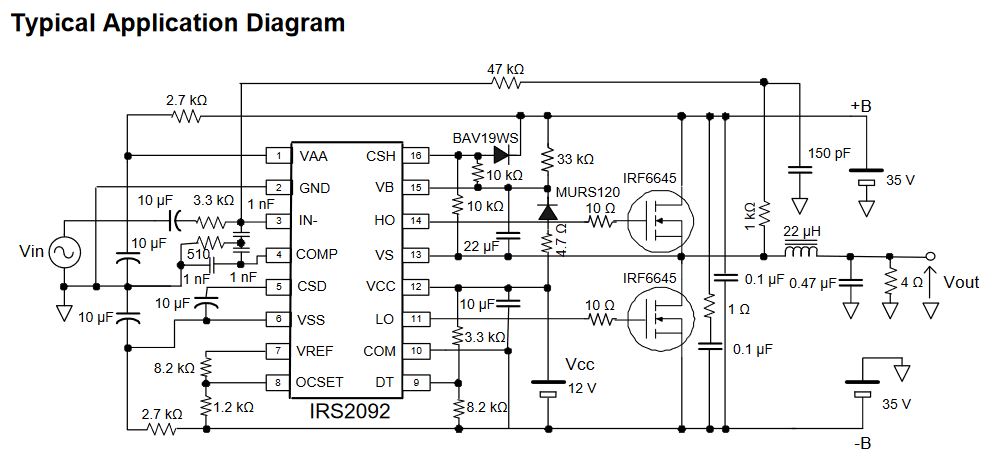

I want to design an amplifier with +-300V supply rail voltage. I need this as a voltage amplifier (ac) and not for audio proposes.
Is there a way to do this with the IRS2092? The shematic shows that it can handle +-100V, so the mosfets and other parts needs to be adjusted.
But which parts? Sure the fets itself, but that can't be all.
I only have experiences with zvs shematics, so please don't blame me
When someone have another ideas - you're welcome to sho it to me

I think you need to find a class D generator chip that can drive a generic MOSFET gate driver - there are 600V rated gate-drivers.
However +/-300V for a MOSFET circuit is tricky - the high voltages and dV/dt values(*) can wreak havoc if the protection circuitry isn't upto snuff. Layout gets much more critical, and almost any fault will vaporize MOSFETs - you should wear eye protection with such circuitry for instance.
(*) 10^10 V/s is possible, which will induce significant currents through capacitive coupling
particularly to the gates which may have several amps induced which the driver chip has to counter to prevent gate-source voltage breakdown.
