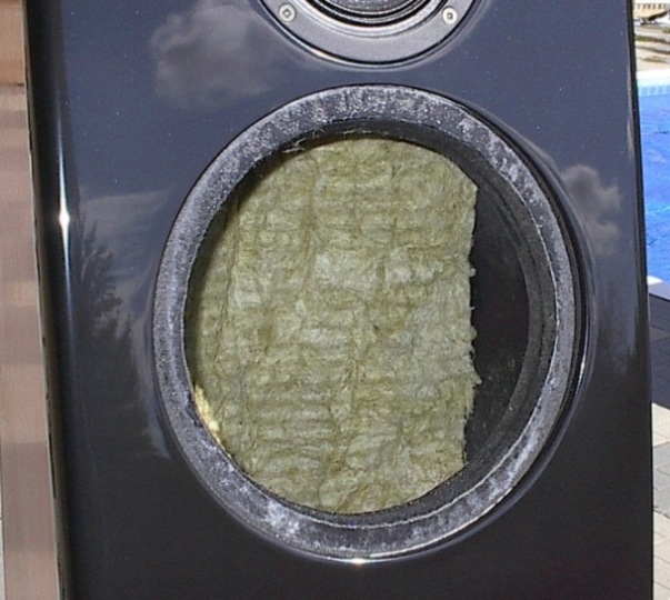

To be sure. And I almost always wear eye and respiratory protection. But in truth I do not wear special protection when picking up such materials at the supplier. Perhaps I will begin to do so.
Got a local source for me please? My new speaker design will be *ahem* large and sealed.HiFiNutNut said:Natural sheep wool also makes your speakers think your box is larger and has some ability to absorb the sound, even in lower frequencies (of course, less effective at low frequencies than higher frequencies).
I have used and compared polyester, purposely designed open ceil foam, and sheep wool batts (80% wool and 20% polyester to hold the wool in place), and found wool to be the best (by quite a large margin).
Davide82 said:rockwool and fiberglass are hazardous through the vents not only handling.
I would like to question that. Ok, that when you insulate a whole attic with fibreglass you should use a breathing protection, but for the small amount that is used inside a speaker I'd say there is no risk at all, not even during the construction.
...or do you know of any scientific work that would support that the small amounts of fibreglass leaking out through a vent would be hazardous?
I would have been dead long ago...
Insulated quite a number of houses, including my own, using both pink fiberglass (for thermal) and rockwool (for sound deadening).
I'm still alive and healthy.
BTW, I like rockwool.
