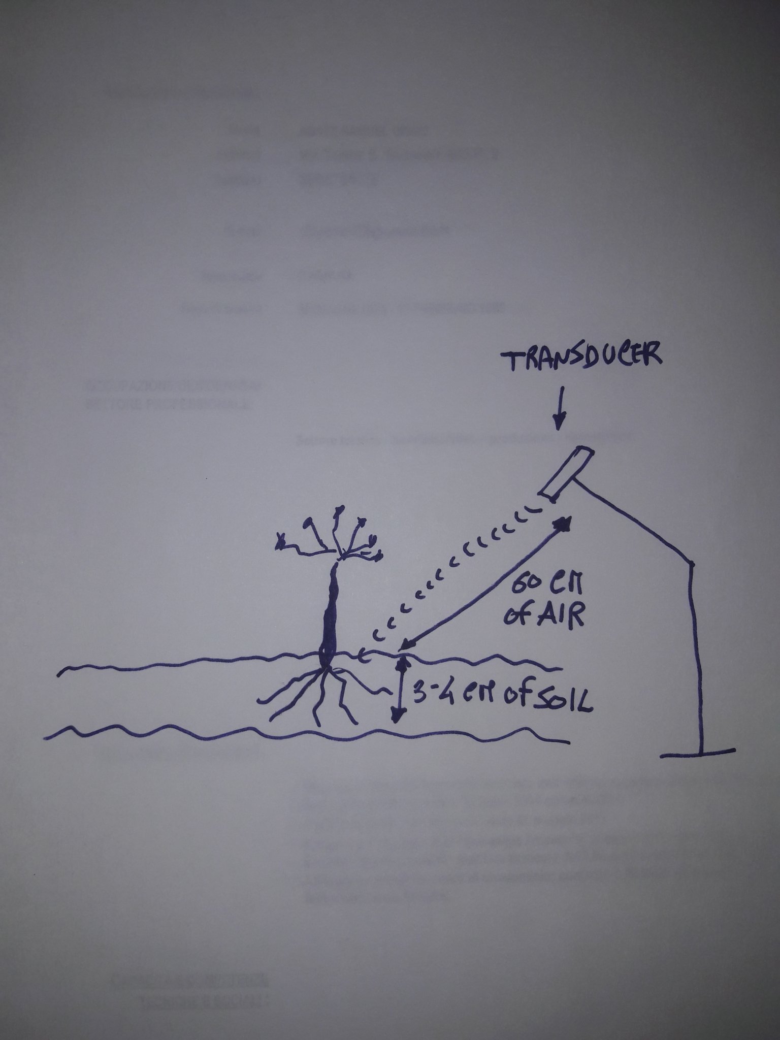

guys so for now let's leave the question of formulas aside because I can't find them either. therefore I would like to know how to focus as best as possible a sound beam with a frequency of 5khz which is equivalent to approximately 6 cm of wavelength. they told me to use a parabolic reflector, I want a 6 cm "wide" beam that can remain 6 cm wide for at least 40 cm of distance in the air, how can I do it? I'm talking about directives

That's a narrow beam. Beamwidth is about the angle, not the width.that can remain 6 cm wide
Measure at the surface and at the wanted depth.
We can't quite seem to get across to Rabbilo the obvious requirement to measure the sound intensity at the surface and at the required 4 cm depth in the soil.
He should consider how the measurement may be undertaken - what measuring equipment would be required for the task?
P.S. For the baffled or simply curious:
Rabbilo's goal, as I understand it, is to investigate the use of ultrasound to break down pesticides that have been absorbed by the roots of a plant.

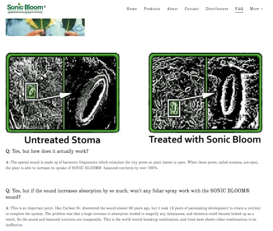

Using multiple piezo drivers focused using either a parabolic or hyperbolid projector like Curt Graber's HyperSpike, SPL (sound pressure level) at 5kHz-30kHz could reach the 160dB range at the soil surface. in the set up above.
An estimate of the penetration and propagation level of the VHF into the soil is impossible without knowing the soil composition.
The effect of the airborne sound on the plant compared to the tiny fraction of that energy that would reach the roots at 3 to 4 centimeters below the soil surface won't be known.
Using ultrasonic transducers coupled to the soil on one control group and airborne transducers for another group would be useful to document.
My opinion would be ultrasonic transducers coupled to the soil will be impractical, even if they prove more effective than airborne response.
The effect of a VHF "chirp" on plant stoma has been documented by Dan Carlson/ Sonic Bloom, small arrays of piezo tweeters can be effective at over 70meters distance, the SPL at that distance would be well under 90dB.

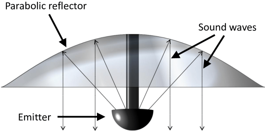

It appears to be a rule of thumb that the parabolic refector should have a diameter (D) twice that of the wavelength (λ) of the lowest desired frequency, i.e., D/λ is suggested to be 2.
That means a diameter of 12 cm in the case of your 5 kHz sound wave.
The emitter, of course, must be placed at the focal point of the reflector, and pointing in at the reflector.
This would create, in effect, a flat emitter the size of the reflector's diameter - 12 cm in your case.
P.S. Using this calculator, the wavelength is 6.86 cm using the speed of sound in air at 20 degrees C:
https://www.omnicalculator.com/physics/sound-wavelength

One (major) problem is most VHF "emitters" have very narrow dispersion, so the emitter shadows a good portion of the greatest output, and the outer portion of the reflector is not "iluminated".The emitter, of course, must be placed at the focal point of the reflector, and pointing in at the reflector.
In actual practice, the VHF output of the parabolic reflector using conventional transducers is more of a "hazy torus ring" than a planar wave.
At the short distance the OP suggests, the losses in the reflection would probably be greater than the limited planar wave benefit.
Thanks.
Looked at simplistically, it was apparent to me that the emitter(s) would have to be extremely small to suit the confines of a 12 cm diameter reflector.
