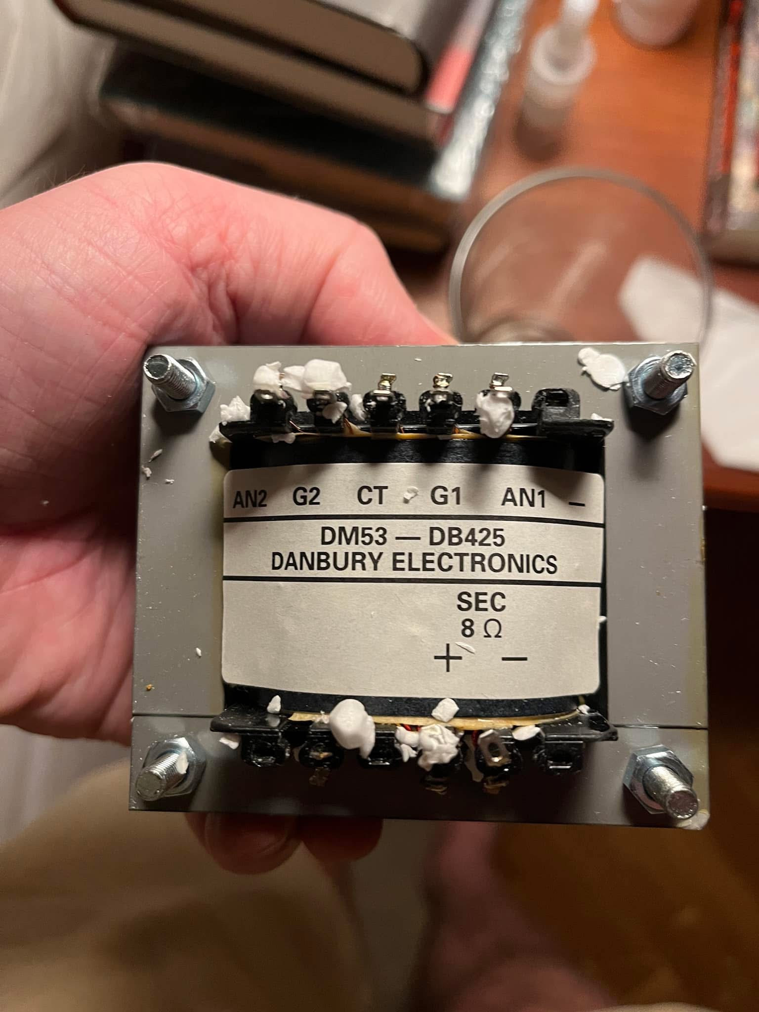

I’m leaning to triode strapped 807’s and have a pair of Danbury OPT’s 25W, 6.6K/8ohm and a pretty massive PT 330-0-330V, some 10H chokes (one Lundahl massive choke that might be sufficient for the whole power rail in both half’s and of course a chassis.

Your transformer will give between 450 to 500 VDC, and the g2 of 807 does not like it. It works but premature failure could be the consequence. You can expect around 10 Watts in triode mode.

Your power-transformer calculations are about right, I think. With cathode bias your 807s will only see about 360 volts from plate to cathode. The 807 grids will tolerate up to 400VDC without a problem.
The issue then becomes triode vs. pentode, also feedback vs. no feedback. 6.6K is a bit low for triode-strapped 807s or KT66s. The typicaly load in a early triode Williamson using those tubes was 9-10K, but that also assumed feedback was used. Your output transformers are, as has been pointed out, much more suited for an ultralinear amplifier with feedback. I'm a huge fan of the Williamson design myself, but the Mullard topology, like the Brimar amp referred to, certainly has its attractions--it's generally easier to stabilize.

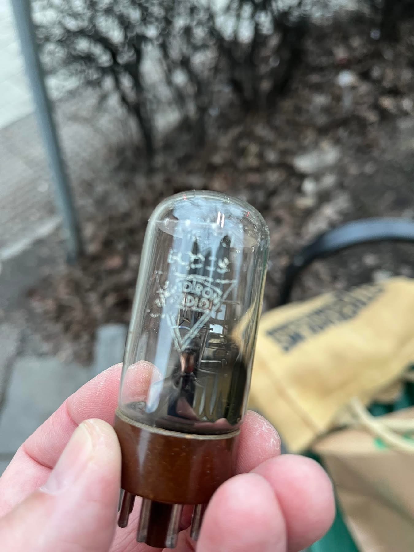

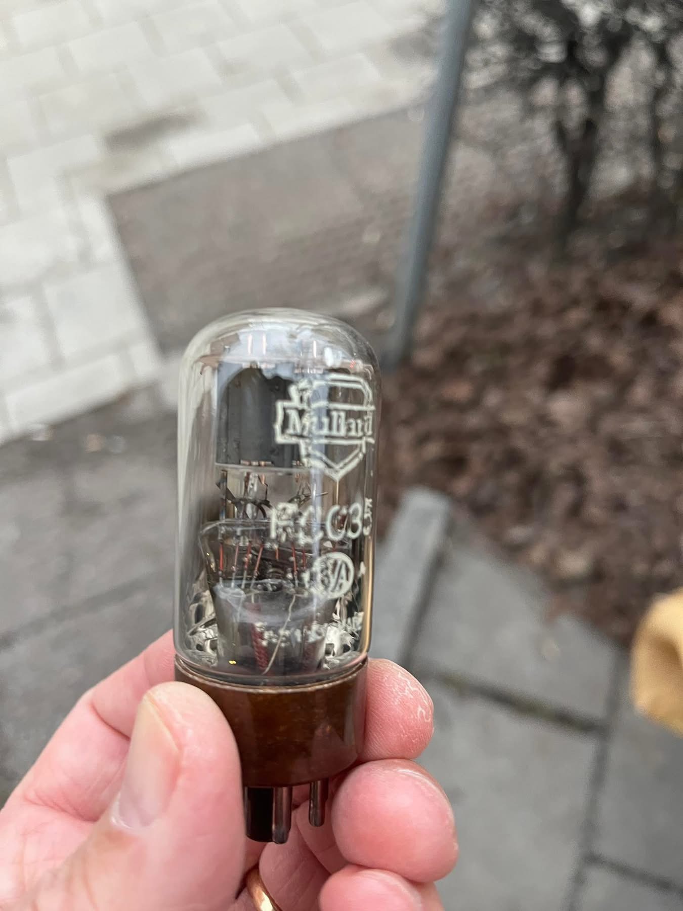

can send pictures of ecc35? please..
I have some matched quads of 807’s, eight matched 7193’s, 6SN7’s, ECC35’s and various pentodes.
