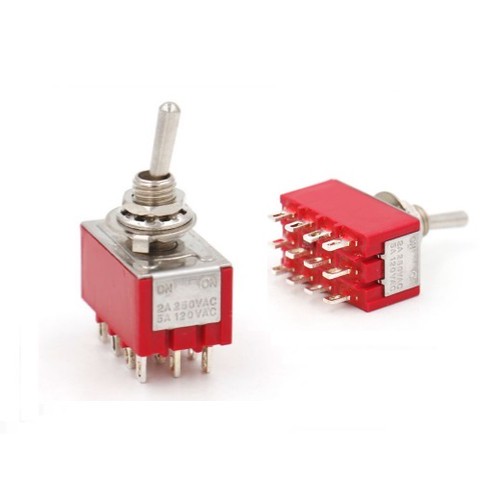

Switching between two balanced stereo sources passively requires at least a 4PDT switch, or even a 6PDT if you want to be switching the shield connection as well. Internal wiring would be unshielded twisted pair in the former case and shielded twisted pair in the latter.

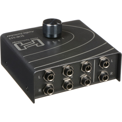

I found an exact replica of what I want to make 🙂 This is it... I just don't want to pay the 80€ ...
Link
Here you go ... 4 in, 1 out ... For 10 Bucks

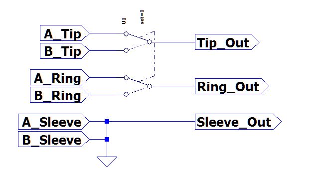

It's not complicated... a DPDT switch will give you two inputs. If you need more just expand it to a Dual Pole rotary switch with the number of stops you need.

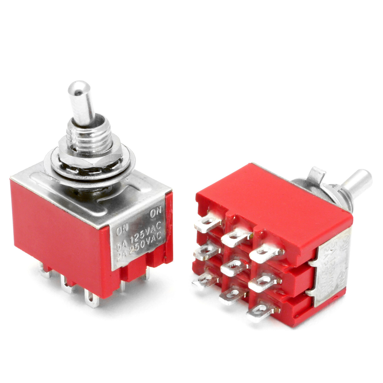

For stereo, you would use 4PDT for wired as twice what's in the thumbnail. For more than two inputs you would need a 4 pole rotary switch with the required number of stops.
The switch itself won't be all that expensive. It's the box and connectors that will get pricey.
Construction is easy... it's just a wiring job, inside the box.
This would be Soooo much simpler if you were using RCA interconnects.

A 4PDT is insufficient - you're going to need a rotary switch as Douglas has indicated.

Actually, with two stereo inputs and one stereo output a 4PDT switch would be perfectly adequate... It's balanced so it would simply be two of my DPDT examples for stereo.

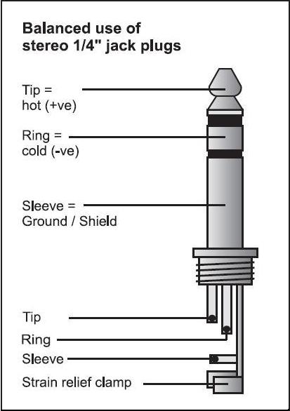

Easy:
High Quality Electronic Machine 3P4T 3Pole 4 Position 2 Deck 15 Pin Rotary Switch-in Switches from Lights & Lighting on AliExpress
Just jumper the ground of your unbalanced turntable preamp to pin 1.
It would be better to maintain the balanced capability throughout, just in case he decides to hook up something other than a turntable...
It would still be balanced. Presumably the monitor speakers are balanced inputs so youd have to convert the turntable from singled ended to the balanced input.
The switch has 3 input pins per selection and 3 output pins. So on the turntable input pins youd need to connect the ground with cold input.
Youd have extra selection inputs for expansion.
I think it's a nifty solution tbh.
Check this out for me Douglas, I think the OP needs a wiring diagram.Actually, a 4PDT switch would be perfectly adequate.
Inside the TRS jack at the end of each of the left and right cables from the turntable, the shield should be connected to the ring (R) and not the sleeve (S) - am I correct grahamgraham?So on the turntable input pins youd need to connect the ground with cold input.
