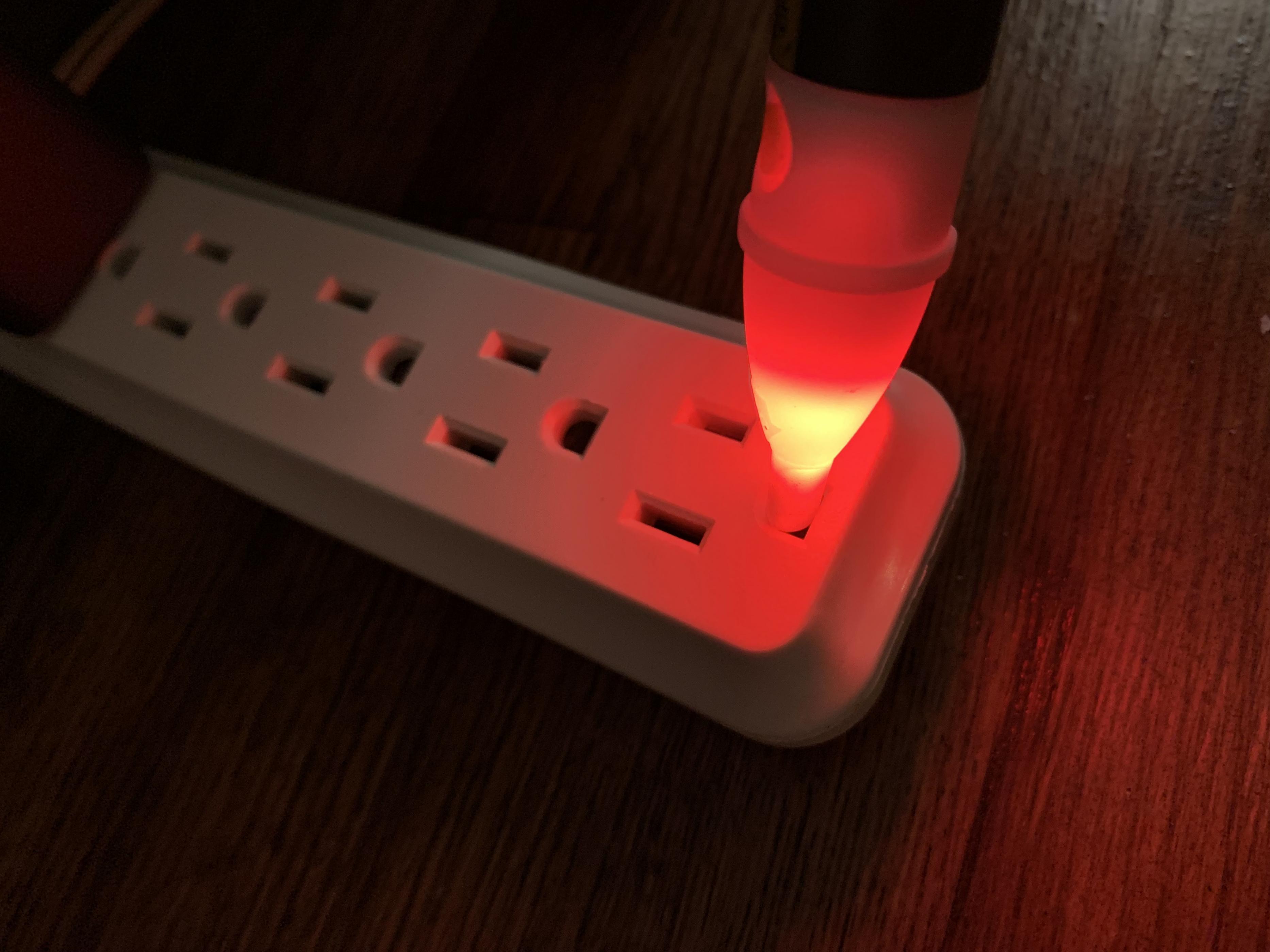

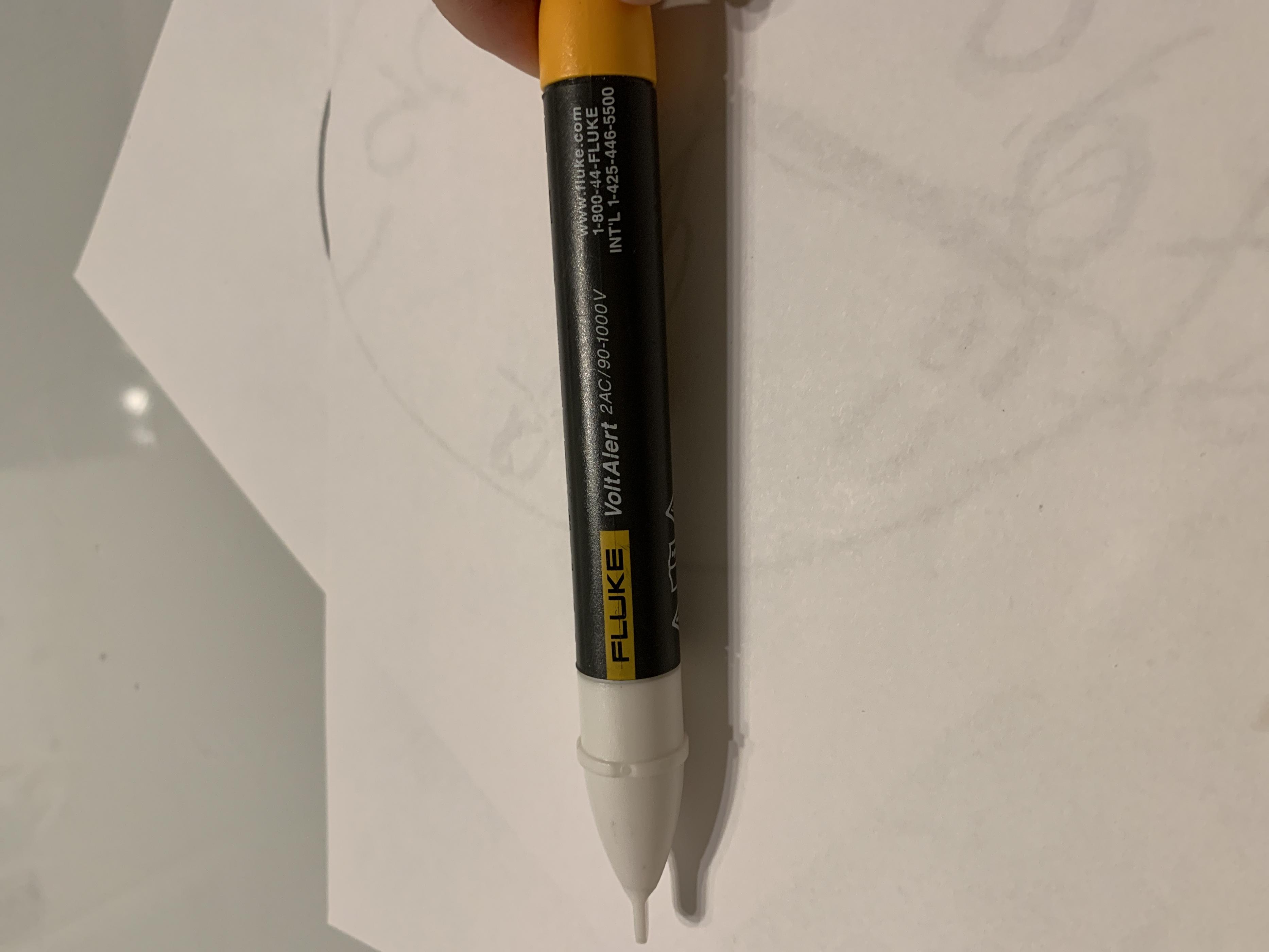

Ok, back to the hum problem. A thread in other forum mentioned to short the 10 ohm resistors at the input. I did that and the hum was down quite a bit, but it was still there.
I oscilloscope the output. The hum is about 10mVpp, mainly 60Hz, also see 120Hz components. Based on my calculations, the SNR is only about 60dB to 70dB in my case. On the manual, the SNR should be 90dB down.
You probably are correct. Probably I will change it to 3 prong cord.
Side story, I don’t trust the ground coming out of my house wall, which is built in 1960s. My computer’s UPS reports “Faulty Wiring” on those outlets.
They probably have Hot and neutral reversed. The narrow slot to the ground pin should read 120V.
