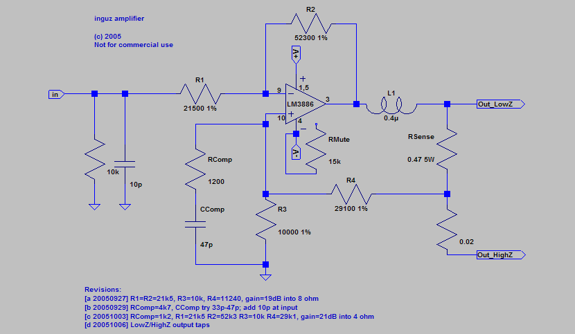

The inguz amplifier is another variation on LM3886 topologies:
Gain ~18dB; output impedance ~8 ohms. Inductor keeps ZOut high as Avol drops. Deliberately unbalanced Howland bridge, meaning no need for resistor tolerances beyond 1%.
The first build is a four-channel version (bridgeable, but mainly to drive bi-amped Linn floorstanders); pictures to follow over the next couple of days when it's cleaned up a bit.
I see a little instability (RF pickup) with open-circuit input. A few pF across input should cure that, but this build will be permanently plugged in to my Squeezebox, so that's not a concern.
So far this has only been running into cheap, bad speakers. But it makes cheap, bad speakers sound good.

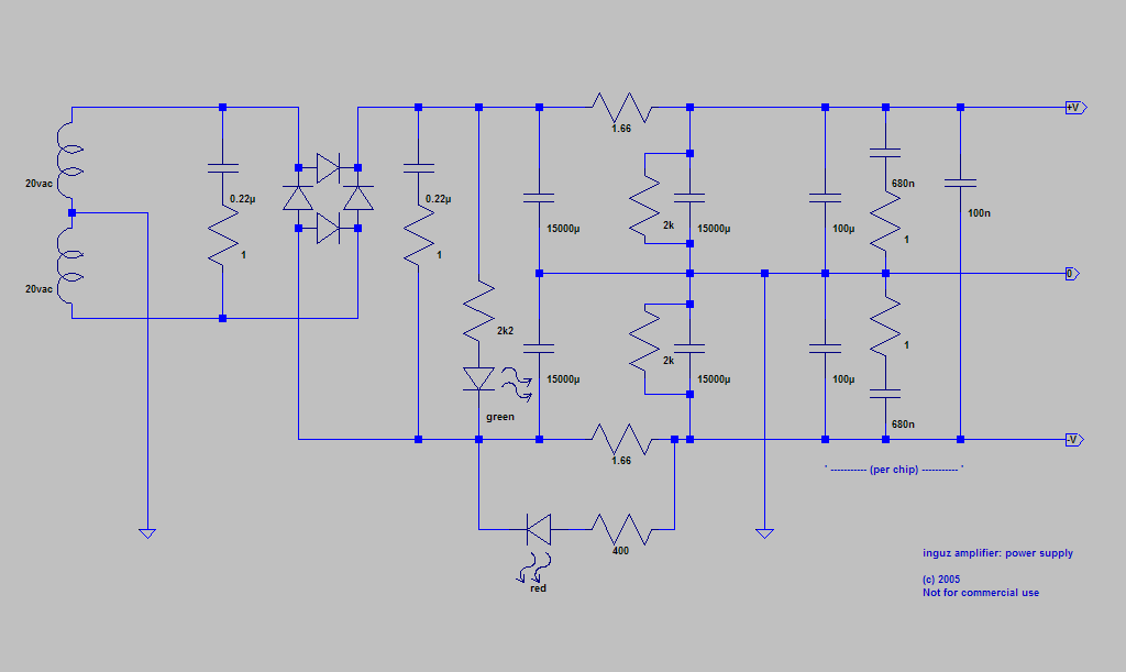

Power supply is +/- 24V, C-R-C filtered. I wanted to build C-L-C but didn't really have room for large chokes (as you'll see from the internals photos, there's barely room for 4x15000u capacitors).
PSU schematic

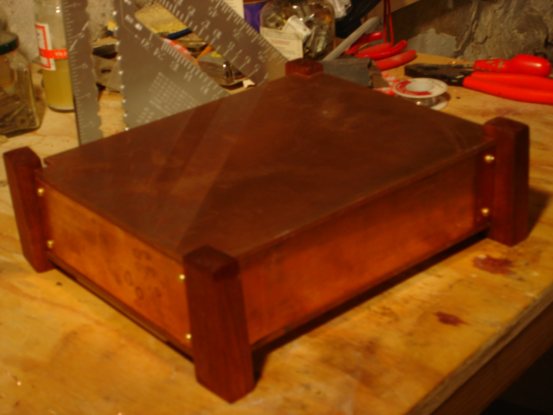

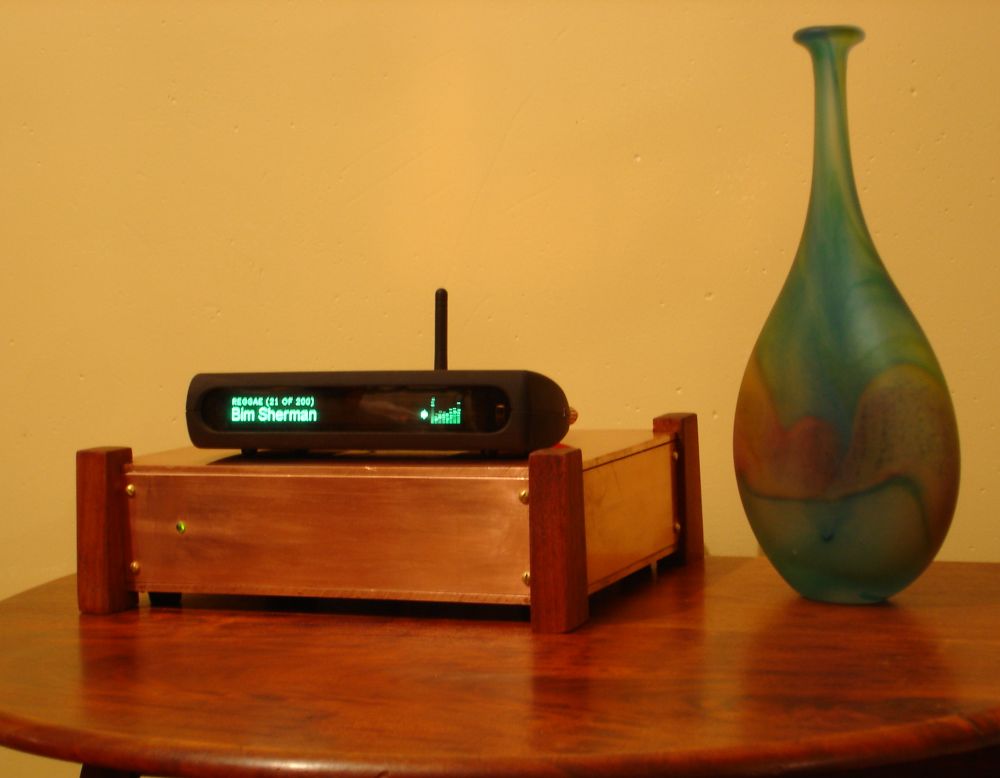

The enclosure is approx 8x11x3 inches, copper, acrylic, brass, mahogany. Here's a "rough assembly" version -- the final should look quite fine. Weighs a ton.
Enclosure (rough)

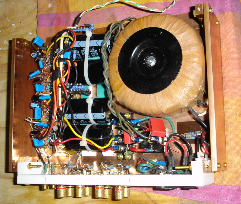

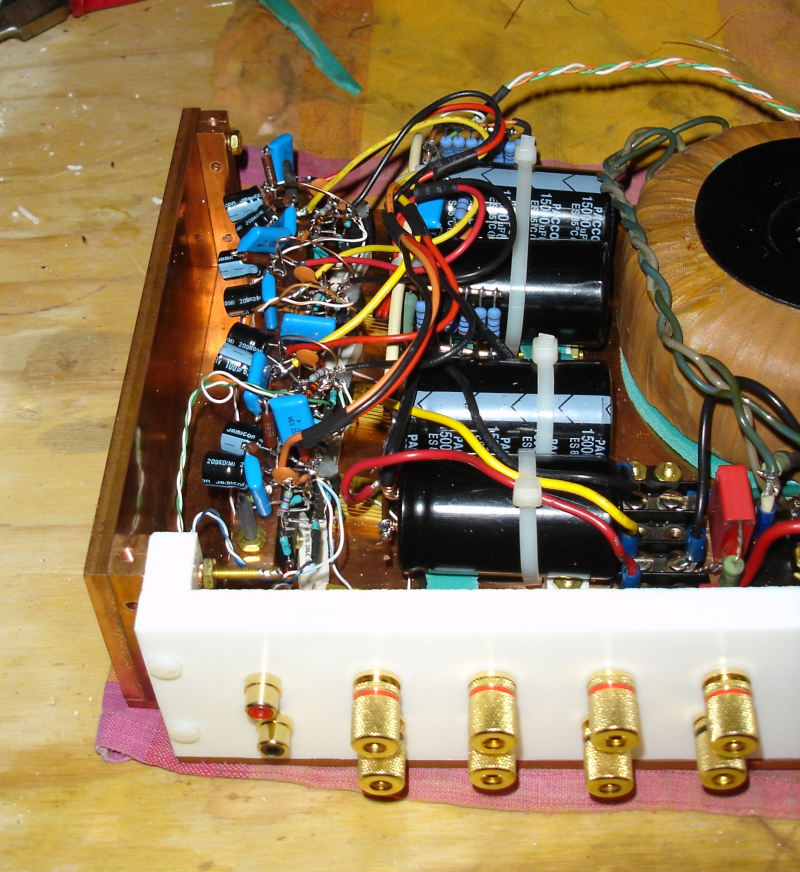

Internals: cramped. One word of advice to anyone else thinking of building four channels point-to-point: "reconsider". That transformer is pretty darn huge too.
Internals (1), Internals (2)
Enclosure (rough)

This looks very neat. I'll work my way through the .PDF tonight.
The Point to Point approach is nicely done as well. Congrats.

Can I ask you where you sourced the big p.s. 15000uf caps and the transformer?

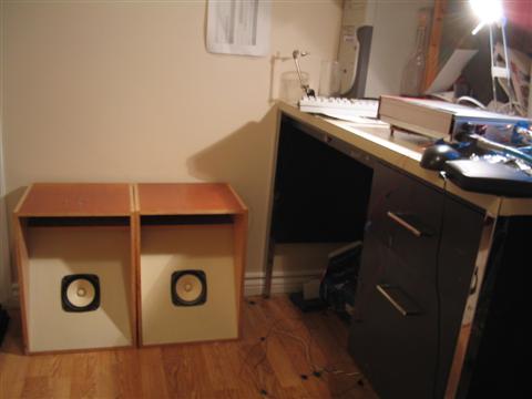

doggy [pic. of my fe126e]

Nice spks!
Thanks! Nice speakers. I want to try this on my friend's Gallo A'Diva fullrange spheres - I think he'll jump out his skin. "-)
The transformer was just lying around. In a previous life it powered a Quad405 (at 240v -> 40+40), but it was something else before that. The power supply caps came from Vetco Surplus in Bellevue WA (ten for $15, just couldn't resist...)!. But the powersupply for this amp really isn't anything "special" -- it doesn't need all that snubberized C-R-C thing to work -- I just built the best I could with available parts, in the hope that if everything turns out good I'll be able to resist opening the box up for tweaking. If you're building Mauro's Ref3, or a BrianGT, this one would work off the exact same main power rails.
Point-to-point is doable if you build each segment separately (I soldered all the decoupling caps segment into a little lump first; then the compensation R-C leg and the series feedback resistors; then wired up to the chips after mounting the chips on their heatsink/support). The first channel was a mess, and 2/3/4 went much more smoothly. Also I didn't think too hard about which direction the power leads would come in from, and now they're in the way a bit. So really I can't recommend it as a construction method... it would be much easier to put together using Veroboard or such, if (like me) you never etched a PCB before.

Updated: schematic (in the top post) now has two output taps, one for "high ZOut" (4 ohm output impedance) and one for "low ZOut" (low output impedance). That's an interestingly tweakable side-effect of the Howland nfb/pfb configuration...
Running the 4-ohm outputs bridged into my speakers sounds quite good. Running each channel with 4-ohm output separately, bi-amping the speakers, changes the tonal balance a lot; some of the mid is sucked out, and it's not ideal at low volumes. (My speakers are quite close to the walls, unavoidably; at a good listening-point all's well, but sitting near the walls is quite boomy).
So now I'm trying the bass/mids with low ZOut (voltage-drive) and top-end with high ZOut... "Carver-mode", anyone? 🙂
