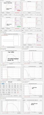

fwiw here's one method, if not a solution. I looked at the least inexpensive 21" Dayton woofer. A huge series BP6 appeared worthless.
I do like a simple low tuned 600l bass reflex with lowpass applied near Fb
