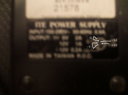

ther are 5 pins. the jacket is ground as well as the top pin onthe side which has 3 pins. below that are 2 pins which are both -5v. on the other side, -12v 0n top and +12 on bottom. this is what is written in the power supply. it seems a little strange to me. if this doesn't work for you, i'll get out my meter and check manually. it seeme like you could make a plug with an old mouse cable and pull one pin.

Hmm so all the Infocus panels are not the same, i have looked at about 4 now and they all have the standard connector, But I have seen the type you have ( the Proxima's seem to have this type also) Looks like alot of the same panels are tagged with alot of different names. Sorry for the the mislead on the PS, was asuming it was same (glad you caught it, would hate for any harm to come to your panel becuase of me)

well i tryed to make a new power cable but everytime i try to plug it in it blows the breaker in my power supply i have done some testing and found out that it is the bottom pin on the 2 min side aome one had sied that it was a -12v if this is wrong please fill me in on what it is
and what amp is the plug supose to be thanks

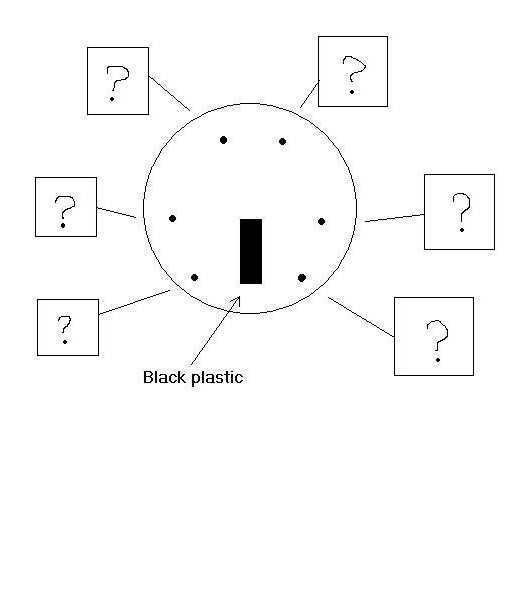

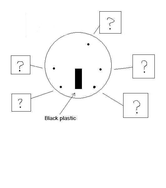

Hi, I donno if I understand, is it like that ?
Thank you, I really need a reply, I think I can use my PC Power Supply for this
BoazGonen said:Well, Its actually something like this :
icculus said:ther are 5 pins. the jacket is ground as well as the top pin onthe side which has 3 pins. below that are 2 pins which are both -5v. on the other side, -12v 0n top and +12 on bottom. this is what is written in the power supply. it seems a little strange to me. if this doesn't work for you, i'll get out my meter and check manually. it seeme like you could make a plug with an old mouse cable and pull one pin.
