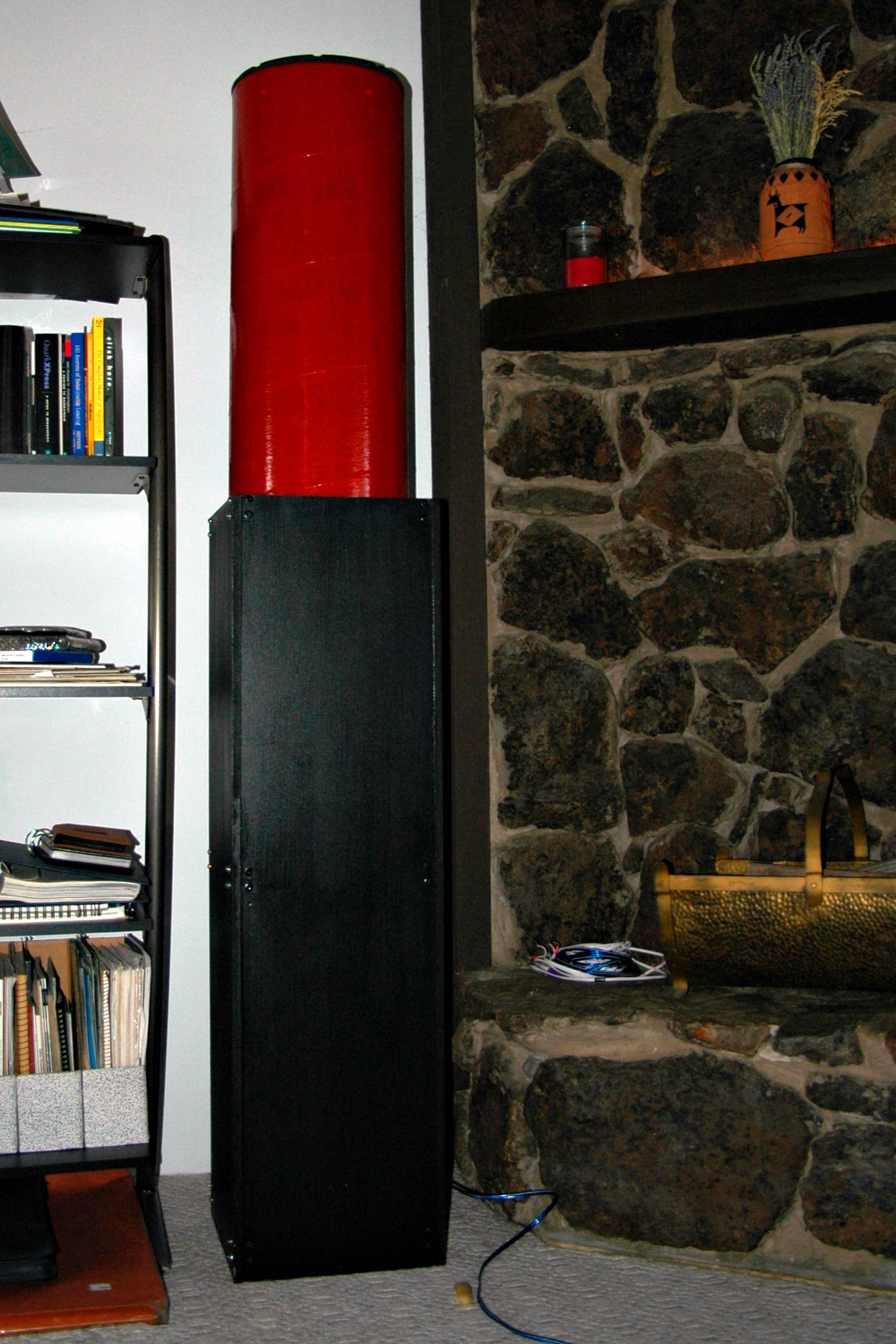

I'm wondering what would be a relatively inexpensive 12" driver to use in a 9.5' basically straight horn/TL? I'm just experimenting (playing
) now, so I'm not interested in excellent but expensive. I've been using a cheap Goldwood GW212/4 that I have and I'd like to try something with different performance characteristics. The current driver is very high Qts (~1.15), low Xmax (~3.5mm), specs here: http://www.parts-express.com/pe/showdetl.cfm?partnumber=290-330. I'm also using a relatively low power amp, either an old yamaha or a lepai, as convenient which I assume means that anything with exceptionally low sensitivity just won't work well.
Thanks for the input, and, remember I'm a novice who is looking to learn and have fun, not achieve aural perfection. Oh, and looking around, it seems like $75.00 is a better cap than $50.00.

I've already built it, and, I'm Windows-free, so hornresp is not a practical option. And, it is a wierd contraption so I'm not sure what to model without getting into the details of the simulations in Octave or SciPy.
