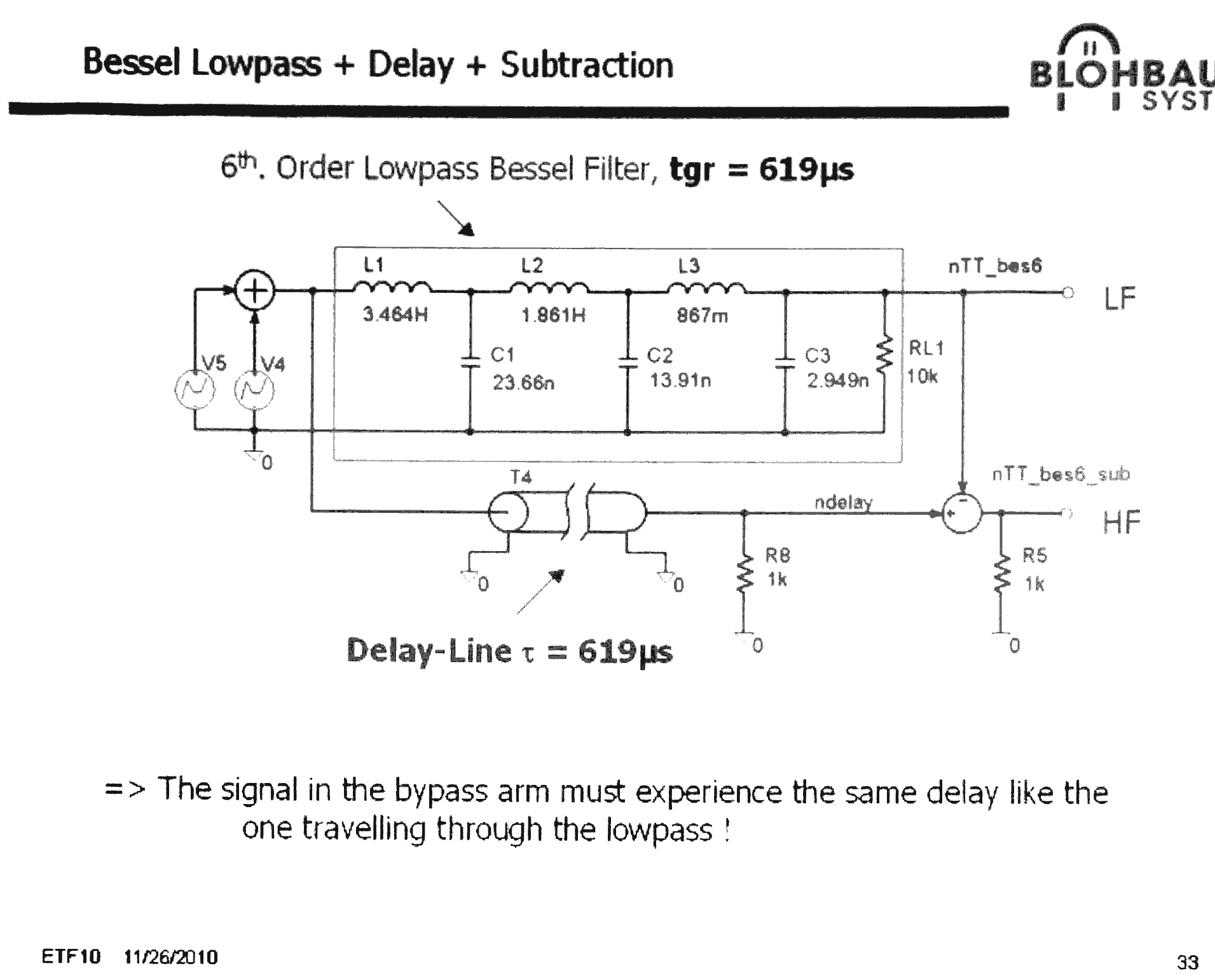

A source of small high value inductors would be a boon to making paasive line level LC XOs too...
Like the Marchand, or the attached one that appeared at ETF 2010.
dave
