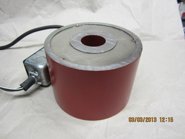

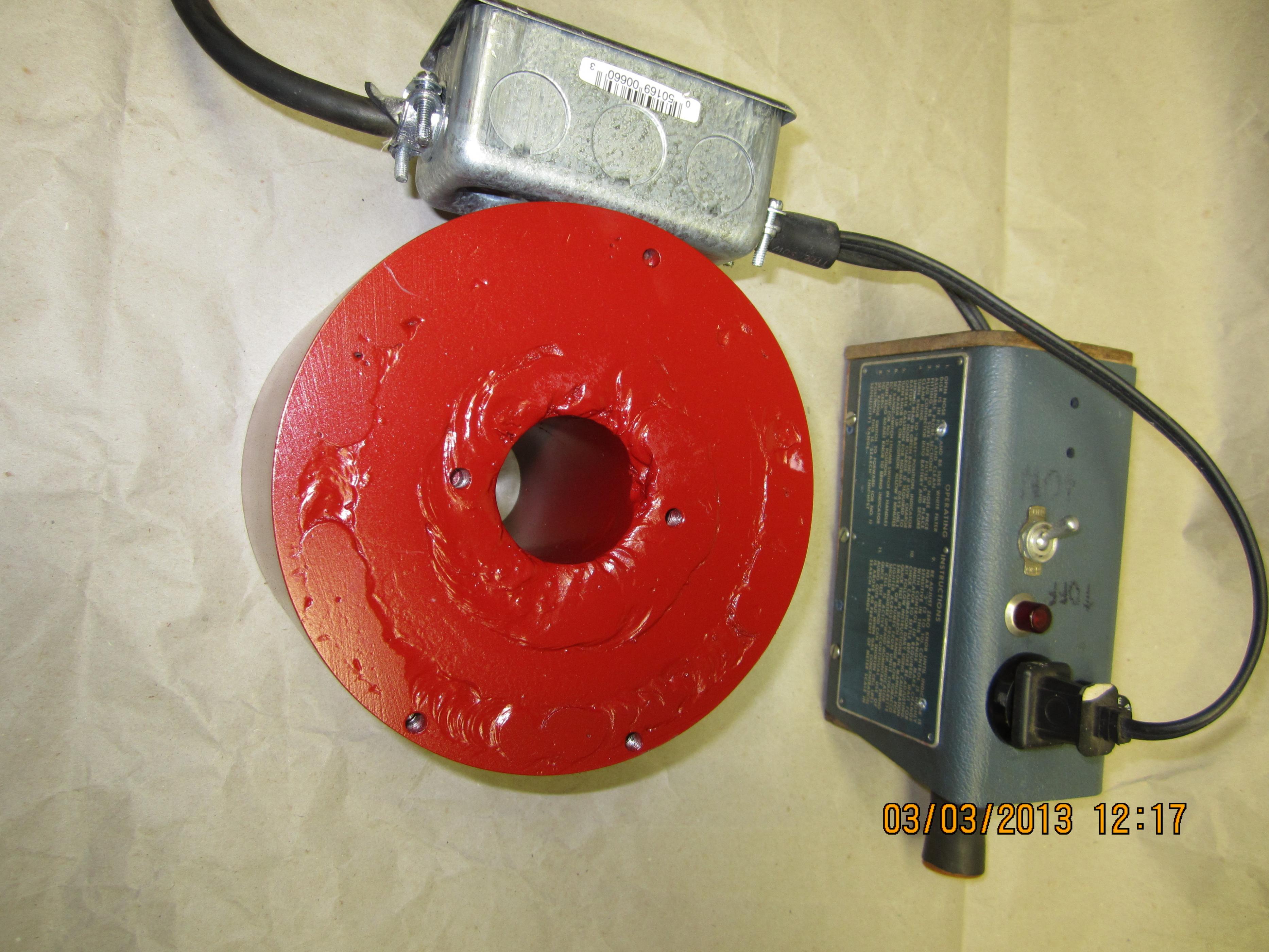

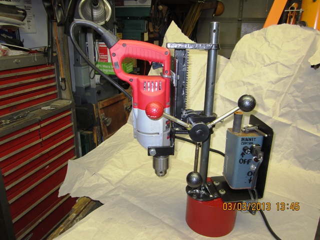

Looks like I started some spirited conversation. I appreciate everyone's input. I have recalled a few more facts, check a couple things, and am including a couple photos for perspective.
The power supply is operating at 167 volts DC from the power supply open circuit. When I plug in the magnet the voltage drops to 143 volts which with the (measured) 80 ohm magnet coil gives a calculated 1.8 amps (measured actual was 1.78) and power of 255 watts. The duty cycle of the magnet is a few minutes on at a time with equal or greater rest periods in between. In the few trials I have given it, the housing only gets a little warm after a few minutes. I don't figure I would ever leave it on long enough to overheat the magnet.
The attached photos show the magnet which is a cold rolled steel weldment. The OD is 6.25", the outer walls .375 thick, and the inner core is 3" OD with 3/4" walls. The top plate is 1/2" thick. I designed it so I could just stuff a full plastic spool of magwire into the hole without having to rewind the wire into a coil. I dug out the inner end of the wire and attached a lead and did the same for the outer end of the wire. Lined the inside of the magnet with the plastic stuff they use to line the slots in motor field windings. Stuffed the spool (trimmed off the excess plastic) sprayed in some insulating varnish to keep the outer loops of the coil from moving around too much and sealed it up with a 1/16" piece of stainless steel.

Interesting Mag base drill nice work The inductor as it is currently used will have little effect on the magnet other than to reduce the voltage slightly. What it will do is smooth out the filter capacitor charging current peaks slightly. These peaks may be 10A along with the 1.8A magnet current which might explain the heating.
Thanks for complement. Kind of amaze myself when I remember I built the basic structure when I was a teenager using a torch, welder, grinder, and hand held 3/8" drill. And a hammer of course. Reminds me of the saying cut with an ax, beat to fit, and paint to match.
