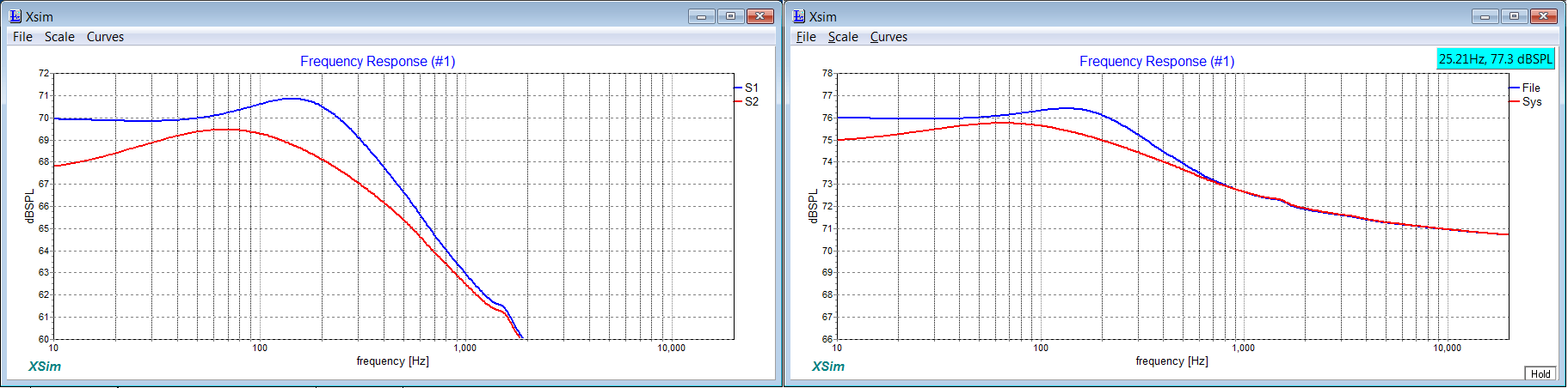

The other factor that reduces the difference is the 1.5 way. I've simmed no resistance against 2 ohms as a more extreme example.
First, the woofer on it's own showing the difference when increasing the resistance. The image to the right is when combined with the main woofer that doesn't change, and the variation is better than halved by this constant.
diyAudio Moderator
Joined 2008
A full range driver and another which is low passed at the baffle step.
Yes, the pictures above may not be clear. The first is an inductor crossover on just one woofer, with and without 2 ohms of resistance in the inductor, to show the regular effect of that much resistance.
The second is the same two when used at the same time as a fullrange is connected straight to the amp, and since the fullrange doesn't change it acts as a stabilising influence.
