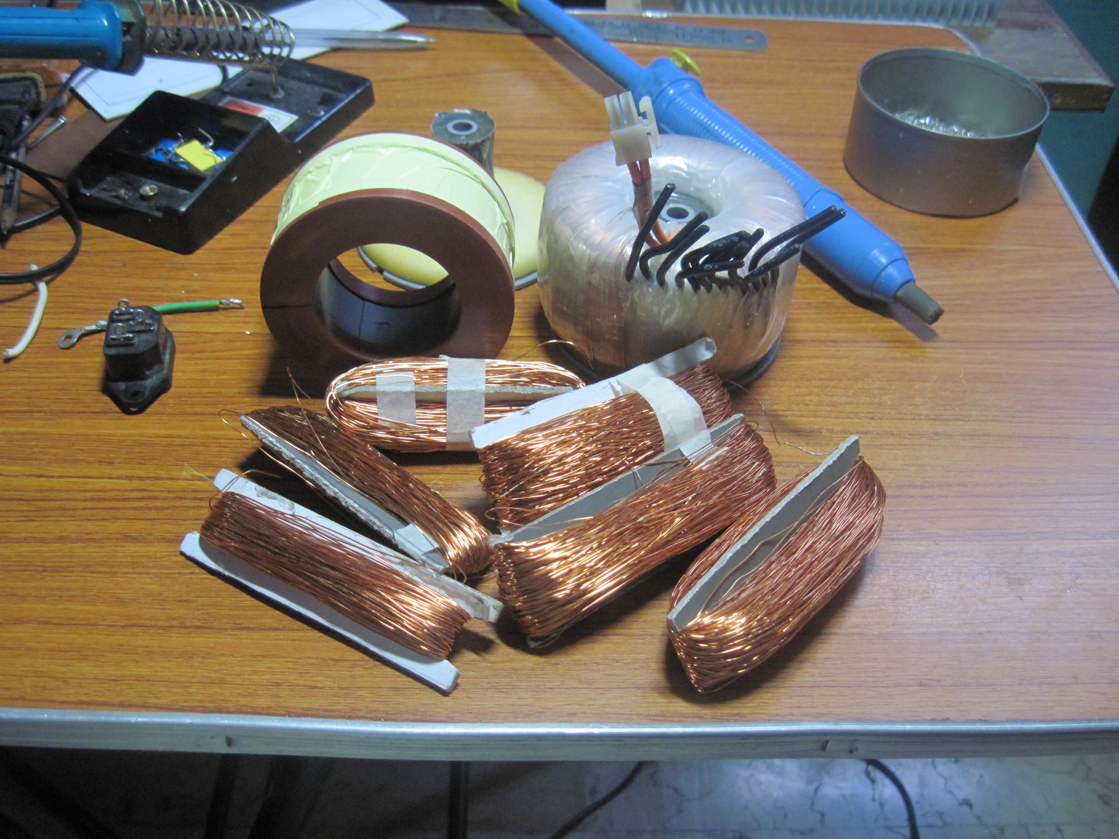

Hi I have a transformer that I want to increase the output voltage by extending the secondary windings
the transformer has taps at 20.4-16.5-0-16.5-20.4 vac
so if I wind back and cut off the copper wire back to the 16.5vac tap on both secondary windings counting the number of turns as I go
the number of turns = 4v ( 20.4-16.5= 3.9)
if I then attach a length of the same gauge copper wire to the tap at 16.5 and triple the amount of turns per side will this give me about 28vac x2 ?
also the transformer is 50mm x 100mm any guess at the VA rating ?

yes I think that would be the best option
I was thinking about removing the wrapping and soldering the extra wire to the 20v tap and cut off the fiy leads to the 16v and 20v tap so I only have 4 secondary fly leads
then re wrap the transformer with black cloth handlebar tape

I guess glen does not know the turns-per-volt rating for this particular transformer and tries to find it out that way.
No need to go that far, just wind, say, 10 or 20 turns of *any* wire, even plastic hookup wire around that core, measure voltage and then divide t/V (turns/Volts).
Then it´s easy to calculate needed turns to reach desired voltage.

Sorry if this too elementary but hey, that's my level! I wonder about the original outside plastic wrap. Now that it's covered with more winding and outer tape, is there chance of melt or fire if the transformer is run hot?
fuses should take care of this...do not worry too much, listening to music draws little current than what was tested using a resistor load....
toroids uses mylar films of about 10mm width all throughout, separators for primary and secondary coils,
they are not even dipped in varnish....dismantling is very easy....at least from my experience..
and the good news is, the dismantled copper can be reused....
