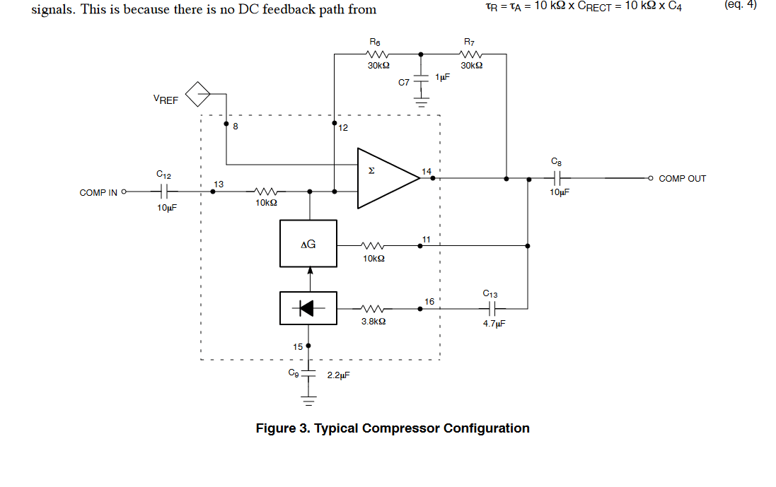

I am currently building a conditioning circuit for a microwave probe:
https://www.diyaudio.com/community/...tyle-microwave-detecting-probes.406201/latest
Despite the on-board complexity rivalling a nuclear plant, nothing is done to correct the inherent non-linearity of the diode detector, resulting in a quadratic response.
The first and most obvious straightening measure is to apply the reciprocal function, ie square-root.
A compressor is ideally suited to the task, and I opted for the NE575, mainly because some were gathering dust in my drawers.
To use the full capability of the probe, I needed to push the circuit to the limits, ie exceeding the normal amplitude range. This is possible, however the feedback from the gain-cell resulted in a low closed-loop gain, causing instabilities and HF oscillation.
The problem is mentioned in the datasheet, along with the possible cures like a compensation caps, various degenerating resistors, but the measures are weak, suited to the "normal" working range, and they have drawbacks.
As I wanted to go almost R-T-R for the output, I needed something more radical.
This is the compressor configuration:
The solution I found was to add a noise-gain network from pin 12 to GND. 160pF + 3.3Kohm seems optimal, and cures all instabilities.
Obviously, a noise gain network has issues of its own, but there are situations like mine where this is perfectly tolerable, and it can probably be used in other cases

Perhaps I don't understand? I would never "expand" a problematic signal back into unmanageable levels. I would map your compression in a (digital) table and display measurements based on a virtual expansion, not actual analog levels.

Good you got it stable.

I have to compress it actually, but anyway the AD conversion + the lookup table would be more complex than ~the third of a chip, 3 capacitors and 3 resistorsPerhaps I don't understand? I would never "expand" a problematic signal back into unmanageable levels
