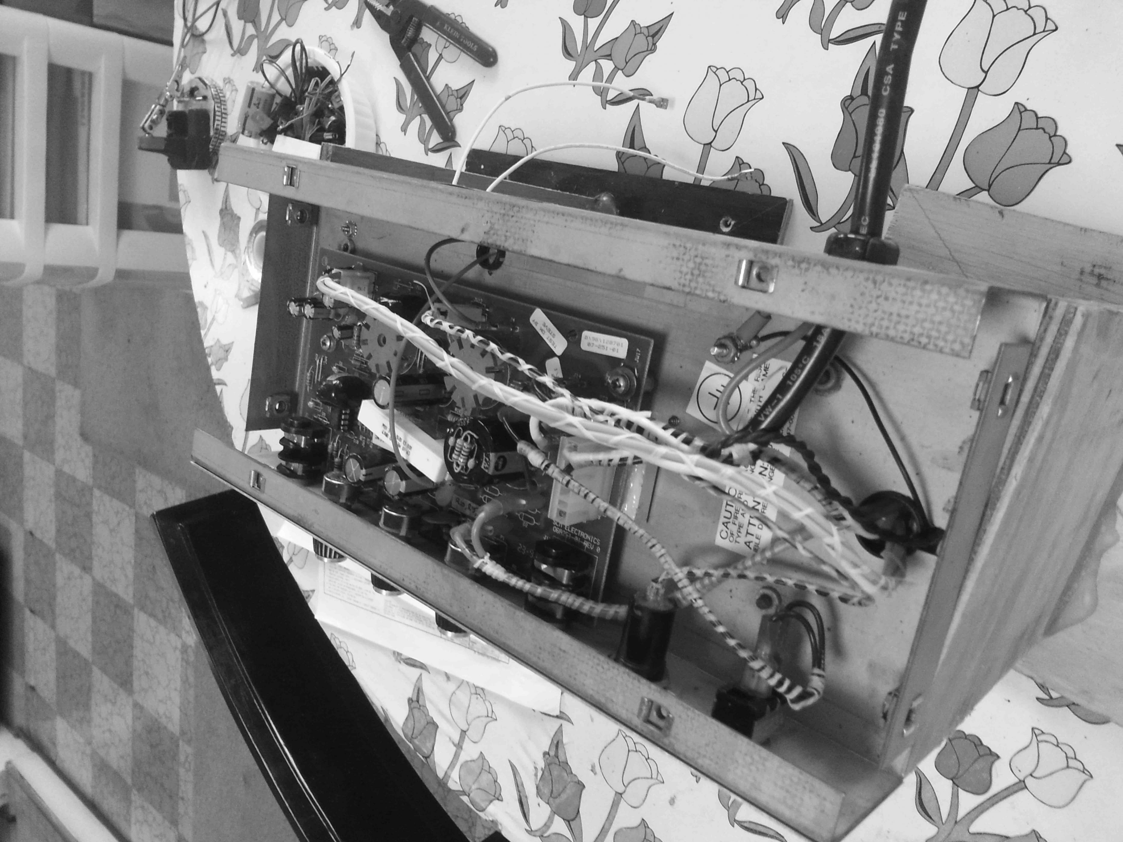

Installed replacement 1st condenser 100uf appliance run capacitor (polypropylene, non-electrolytic)
But hum comes bigger, why?
Run capacitor has sealed pigtail leads eight inches long untwisted, soldered into original capacitor's pcb landings.
How can high tension dc fed by bridge rectifier introduce bigger hum?
Can proximity wiring affect 8" untwisted run capacitor, either influx into ht or efflux out ht into susceptible wiring?
Or could it be the swapout to one meg audio taper of gain and level pots?

About changing the cap in the PSU : the legs of the cap should be virtually non-existent, so eight inches is an astronomic lenght 🙄
Come on, hewo, you've been around long enough, tell everyone it is a CRATE VC508, unless it is something else, and put up a schematic so everyone can see what you are talking about:
http://bmamps.com/Schematics/crate/Crate_VC-508_(07S251)_Schematic.pdf
You surmise changing the cap increased the hum, then only as a parting thought you mention changing pot values. What else did you change? Not sure what the new cap was going to do, but as DC it won't radiate much from its wires, or pick up anything. In post #3 you add you apparently changed the op amps. Anything else?
What does this refer to?
Pot values changed? Oh dear... Look at the first stage, gain pot P3 is 250k, and combines with 2.2k R5, that ration sets the gain of the op amp. By quadrupling that value you upset the designed gain of the stage. And later, the volume control P1 is part of a voltage divider comprising R6, R11, and the tone circuits, plus P1. Looking just at R6 and P1, they form a 10/1 voltage reduction in signal level leaving the tone controls. If you made p1 a 1 meg then you have reversed it to a 1/10 voltage reduction of signal.
So looking at the circuit, the output from P1 is meant to be a line level signal, about 1 volt. The signal is shown as 30v p-p under test conditions at the preceding plate, so with a 1 meg pot, instead of about a volt all the way up, your signal level would be a lot closer to that 30v level. That would seriously overdrive anything in the line out jack, as well as hugely overdrive the following grid. Note the plate of that following triode only expects about 10v p-p, but if you start with more than that at the grid, it won't be happy.
So it is vastly different from changing the pots on a guitar. They affect impedance, but not overall signal levels or gain.
So what you did was increase gain in the first stage, but also increased signal level at the master volume. I don't doubt the amp is not stable.

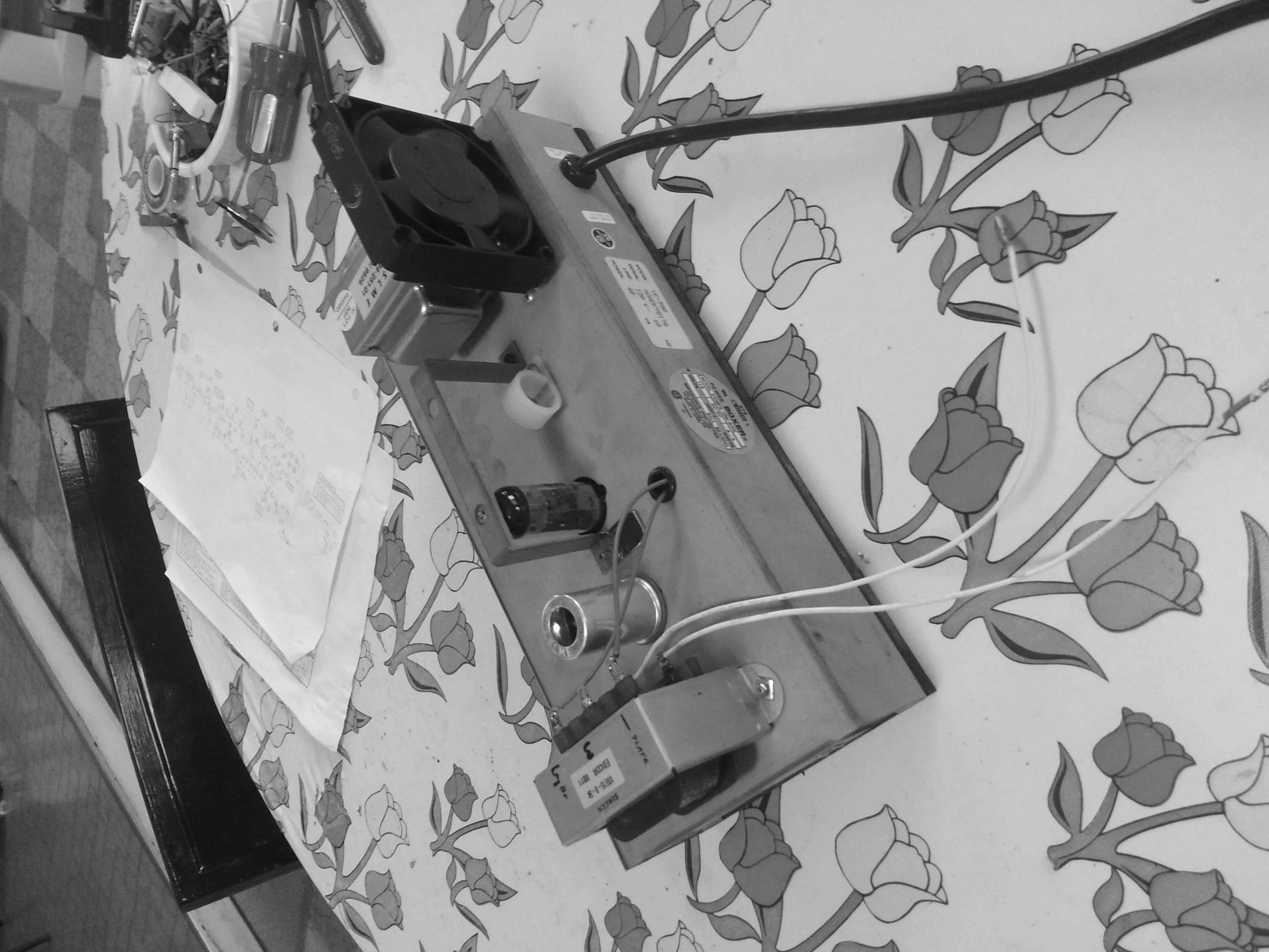

forgotten disclosure additional alterations vc508
Both ecc83 cathode resistors changed to 820 ohms each metalfilm 1% 1/2 watt.
Appended paralleled run caps polypropylene foil, 224 on 10uf 1st preamp stage ecc83, 684 on 10uf 2nd preamp stage ecc83, 334 on el84's 100uf.
Snubbed power switch paralleled 224 run cap polypropylene foil (should be 502 as 224 creates distress sigh speaker gasp on power kill), purpose of snubber cap is to kill switch spike on power kill.
Inserted series, to tone wiper, 1k ohm 42gauge wire inductor to earth, to preferentially annihilate bass frequencies unwanted esp with larger gain and larger volume settings. This required sleeving the wiper's pcb well with teflon to isolate wiper pigtail protruding soldering landing, thus exposing the pigtail and pcb landing independently isolated for inductor insertion.
increased power resistor wattage handling, r20/r18 five watts, r17 ten watts.
P1 increased to 20k linear, but gain and tone remain factory schematic.
HT rectifiers changed to those ultra fast type and greater handling current.
Tone circuit hipass c9 changed to 221 hiQ type disc, c12 tiedown continuity reduced to 101 hiQ type disc.
Both dc blocking c8/c14 upgraded polypropylene foil (bulkier because not metalized film) sounds much much sweeter.

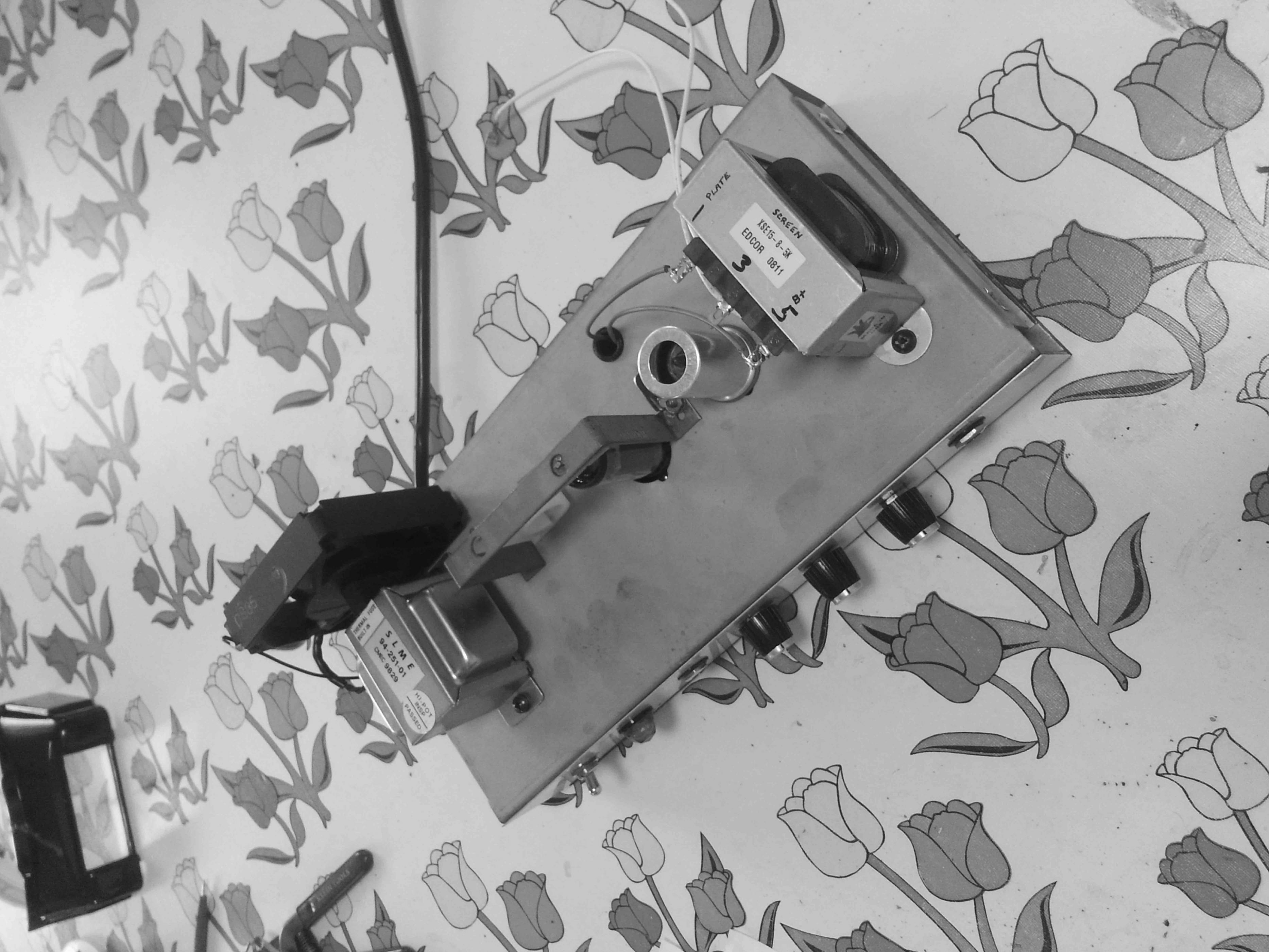

Edcor ot 18va 8ohm out, 5k input impedance, but paper speaker is 16 impedance, cleaner output but reduction power transferred.
Welded toe extension on one side of el84 brace, because slm design errored in brace alignment bolting holes.
220vac axial fan soundshort mounted (sponge mounts) to chassis impinging winds direct blast onto pt close proximity 1/2" separation.
Spare tube clamp affixed to el84 brace.
Abandoned incandescent lamp parasitic rob energies heaters, by inserting rectified heater energy into quad seagull micro led series coupled, totalized current drawn fractional milliamp!
Copper foiled backboard panel of electronic tray, as it is not made of metal, and emi can infiltrate thru pressed board.
