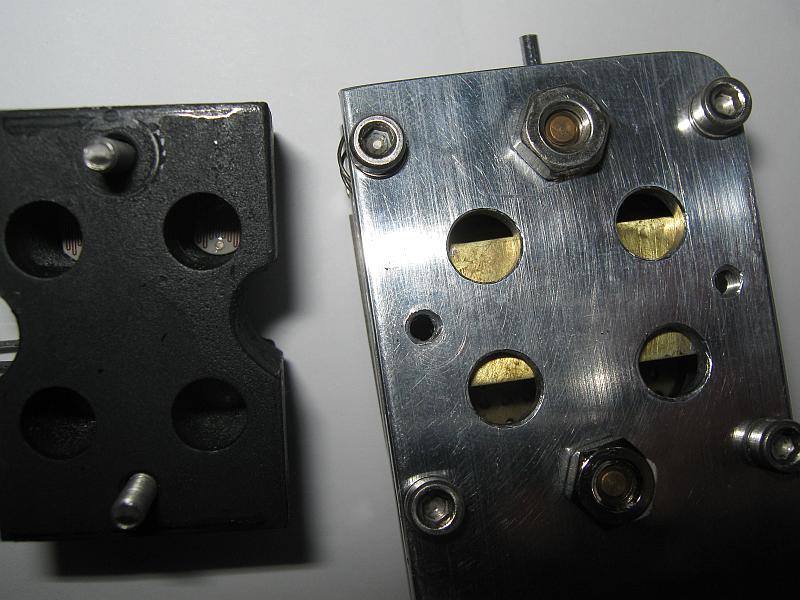

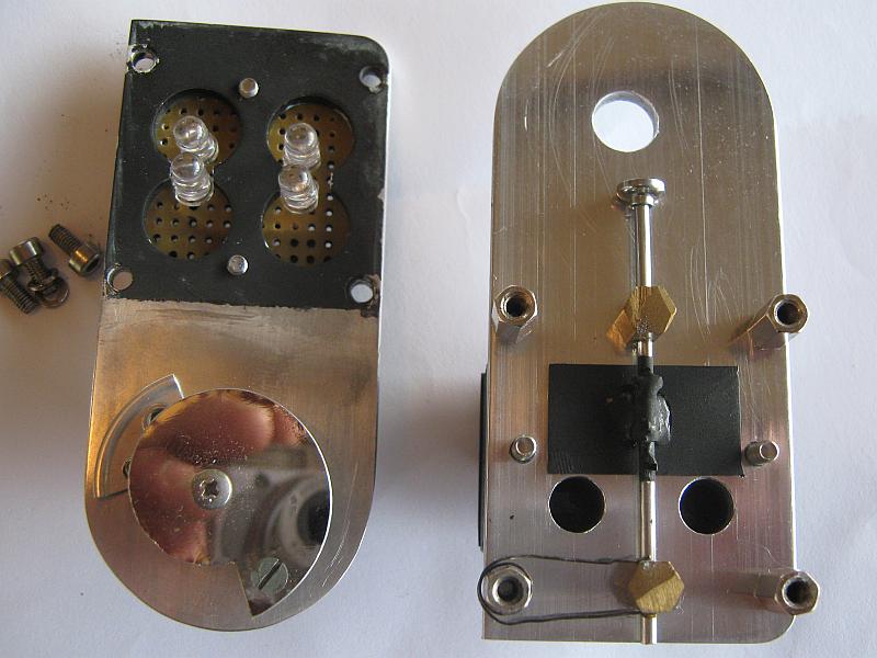

I’ m calling it a Shutter light for want of a better name. A shutter is moved across four 25mm long tubes housing the LDRs via a 270 deg cam. The four LEDs are not in line with the LDRs but offset toward the centre point. If they were in line, the source impedance would drop into the 100’s of ohms area in the centre of travel (135 deg). At the centre point both shunt and series LDRs are relatively shaded and both have 13K or so of resistance. As the shutter moves from the centre; move light falls on one and less on the other increasing the source impedance.
Alignment and channel matching is done simply by shoving the LED’s one way or another. Response can also be altered by moving them closer to the centre, or just the series one to create a log response. I’m still messing about with this and have yet to do any listening test. You thoughts?

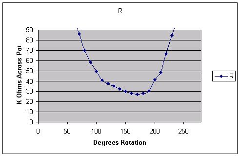

Hi Andrew. To avoid confusion just consider the LDR network as a standard pot. The plot on the left is the resistance through 270 deg of rotation Across the pot. i.e. top to bottom (the connection to the source, CD etc)

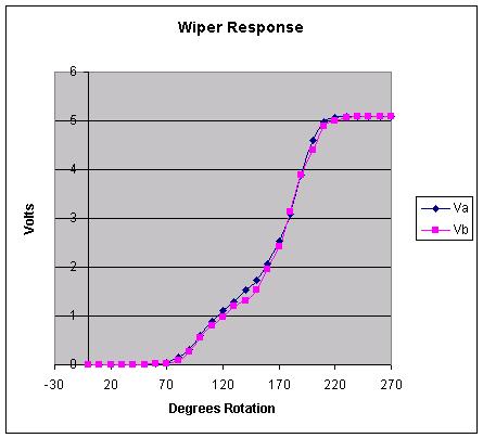

The plot on the right is of the resistance through 270 degs of the wiper to the bottom or earth of the pot ( connects to the amplifier)

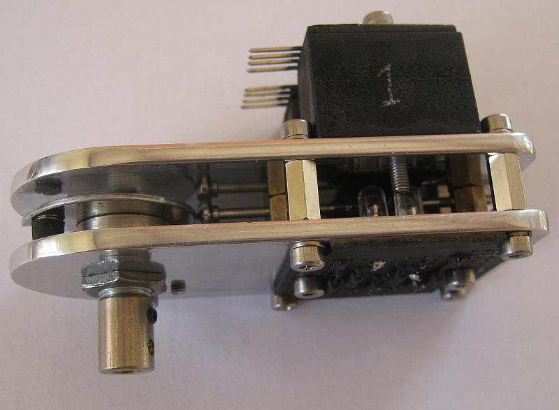

Hi MC. Sorry for the delay. Have been away working and haven't got around to doing some serious listening as yet. Will post some more images of the unit apart to give you an idea. I also have CAD drawings I used to construct it, if you are interested.

I understand the concept of your design, but if I'm seeing it correctly, it looks like both LDRs are operating exactly the same way, that is it appears they increase and decrease resistance together, whereas one should increase awhile the other decreases. Am I seeing it right?
Mike
Mike
Hi Mike. In the photo you are seeing the bottom half of both channel LDR tunnels. The other two are hidden under the shutter. Would a pic of the shutter half way help. If so I can post one.

Hi Tade. Glad you see the plot. Have got side tracked making up a UHF remote controlled stepper motor and driver board with power supply for the LEDs. Have done some listening tests with the shutter in series with the existing amp. Sounds "warm" and likable. The amp is very different and requires a lot of mechanical fitting of the shutter. The mechanical is much harder and therefore more fun for me to do being an electronics type.
