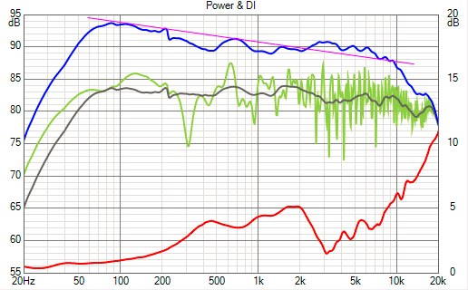

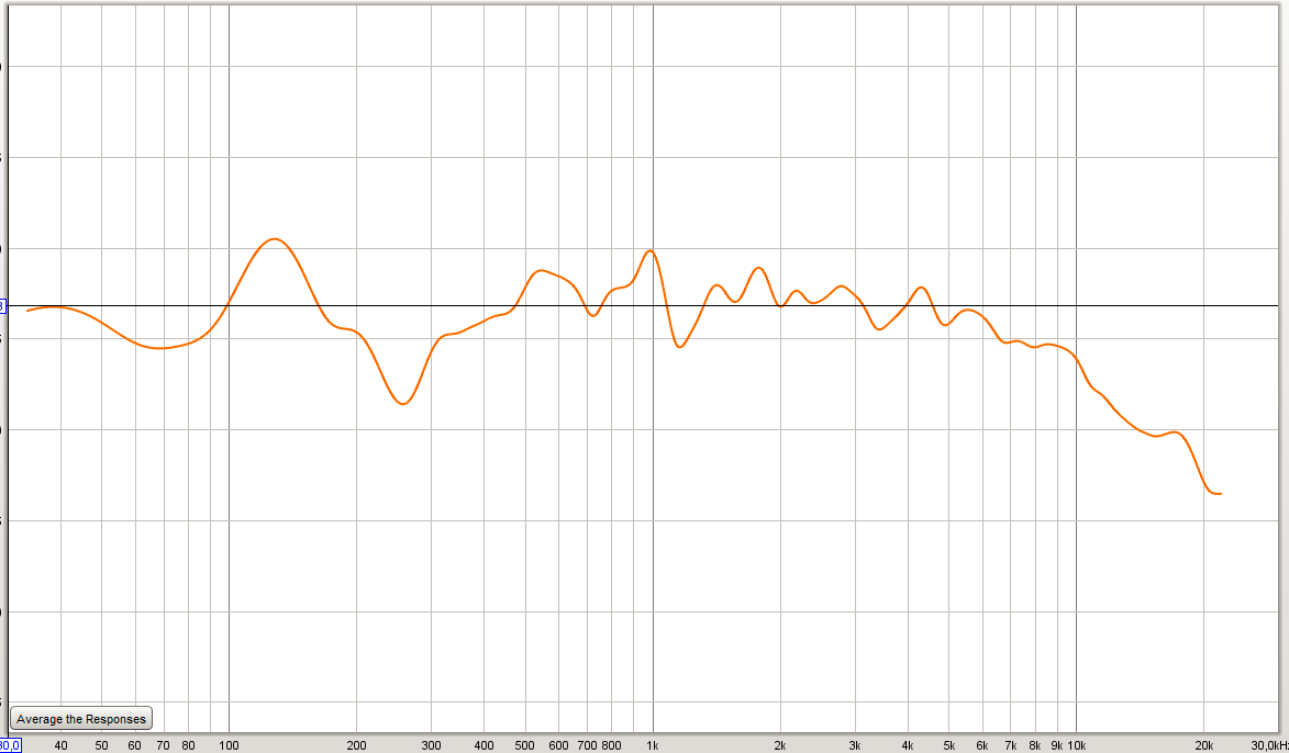

I have bass driver 45cm from groud and midrange 84cm. Unformately i wasn't simulated that with room response. That makes floor/roof reflection null to about same frequency near 300hz. And i have crossover frequency 250hz, and in the midrange this null is even worse. That can be simulated with vituixcad and also i can see it from measurements.
Here is my room response and that don't have pucnh because of missing power from 150 to 500hz. (measured at midrange level so treble top end is missing)
And here is vituixcad simulation (from my speaker). Green line is room response simulation:

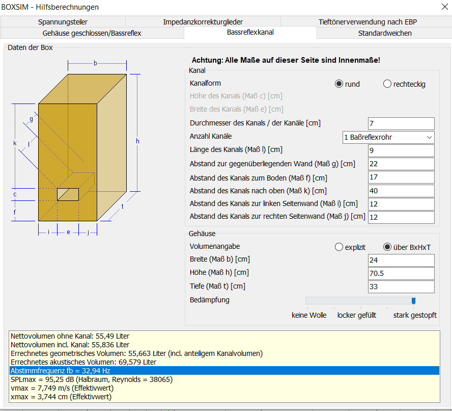

thanks again for your constructive postings!
Here an update on my actions today:
- checked the dimensions of the woofer housing: 70.5 x 24 x 33 cm (H x W x D) which gives a volume of about 56Liters.
- 2x heavy 30mm thick damping plates habe been added inside
- did new calculation for the lentgh of the FR tube. Based on the above mentioned dimensions and based on PKAudios recommendation to set FR to 20 - 25Hz, a 28cm tube has been mounted now. Boxsim has calculated a FR of 23.3Hz.

If i simulate your bass driver distances at 300hz crossover, it won't make much difference. Little bit better than mine.
But then i simulate to raise your crossover to 450hz and with 4th order. (with your driver spacing). That won't make much difference, still mising middle bass.
In my system that helps (In simulator), because my woofer is closer to floor.
Next system that i will make, will have multiple woofer to avoid middle bass weakness.

Yes, of course is good to try speaker without sandstone plate. That might change room reflections.
But also if you have measurement equipment. Please make measurement from your listening point and post image of response here. (You can try make this with your phone also)
