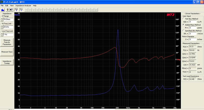

I am a newbie at this crossover business. I have a horn mid-tweeter that has a resonance at 514Hz:
I would like to make a simple high pass at 2khz with a 5.6nf cap. Is there any impedance flattening circuit that will flatten the 514hz impedance peak? I think this will be beneficial to have a closer to textbook 6db rolloff, no?
The zobel RC is only good for flattening the rising impedance but not the peak, correct?

you could use a series notch filter: Series Notch Fliter Designer / Calculator ,
but why are you using a 1st order xover...??? (& what application is the speaker for?)

Could use an LCR trap. Just add a cap in series with the RL Zobel. Will have to test with your driver for appropriate value cap.
Google "PI speakers crossover". They have a good paper PDF on horn crossover that would be of value to you.

Actually, a resistor across the tweeter, "damper" did the trick! thanks for the link to Pi crossover pdf.

Often horns have Lpads applied which provide a parallel resistor and help filter operation. A simple parallel resistor, if you don't need adjustment range, is also a good method though lossy. Best is to do a tuned trap, but those are more effort to get right.
About 2/3 of the way down, we have a dual notch impedance compensation for JBL 2426h.
