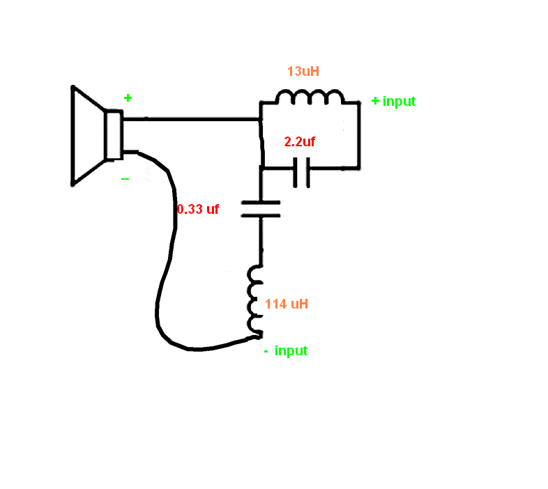

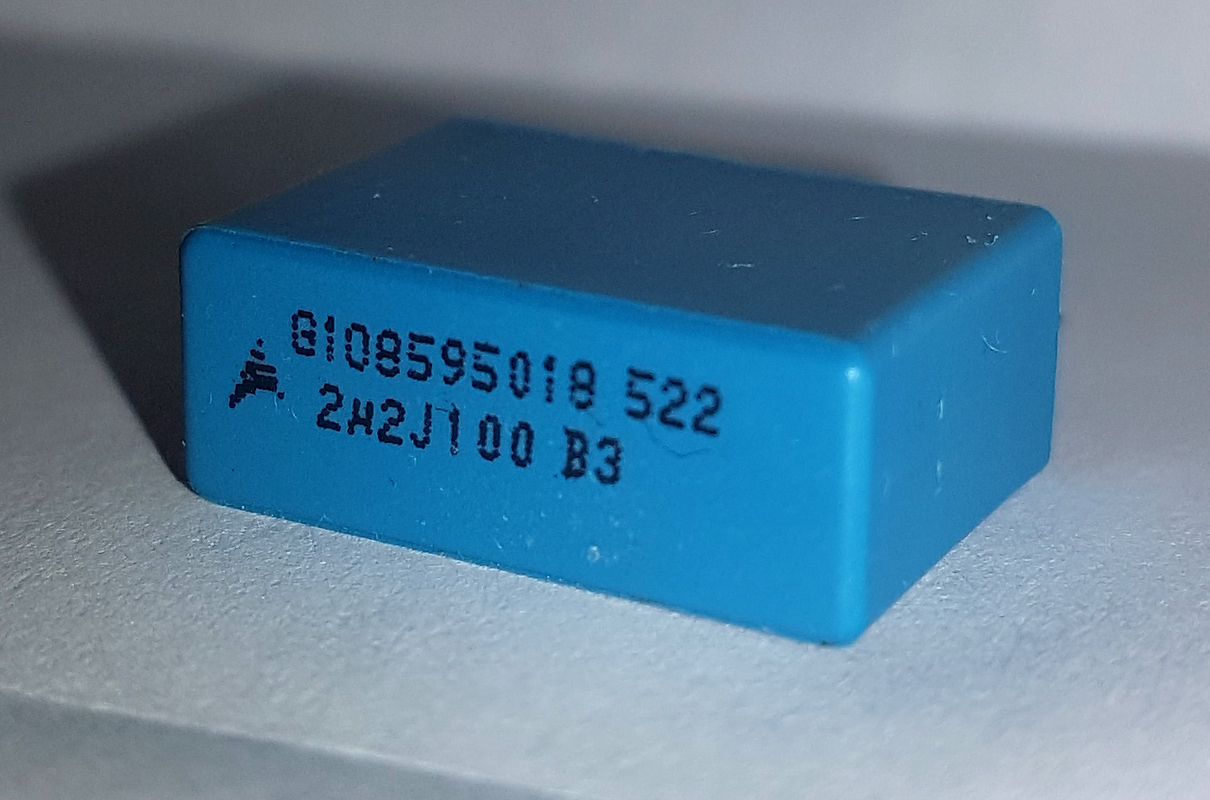

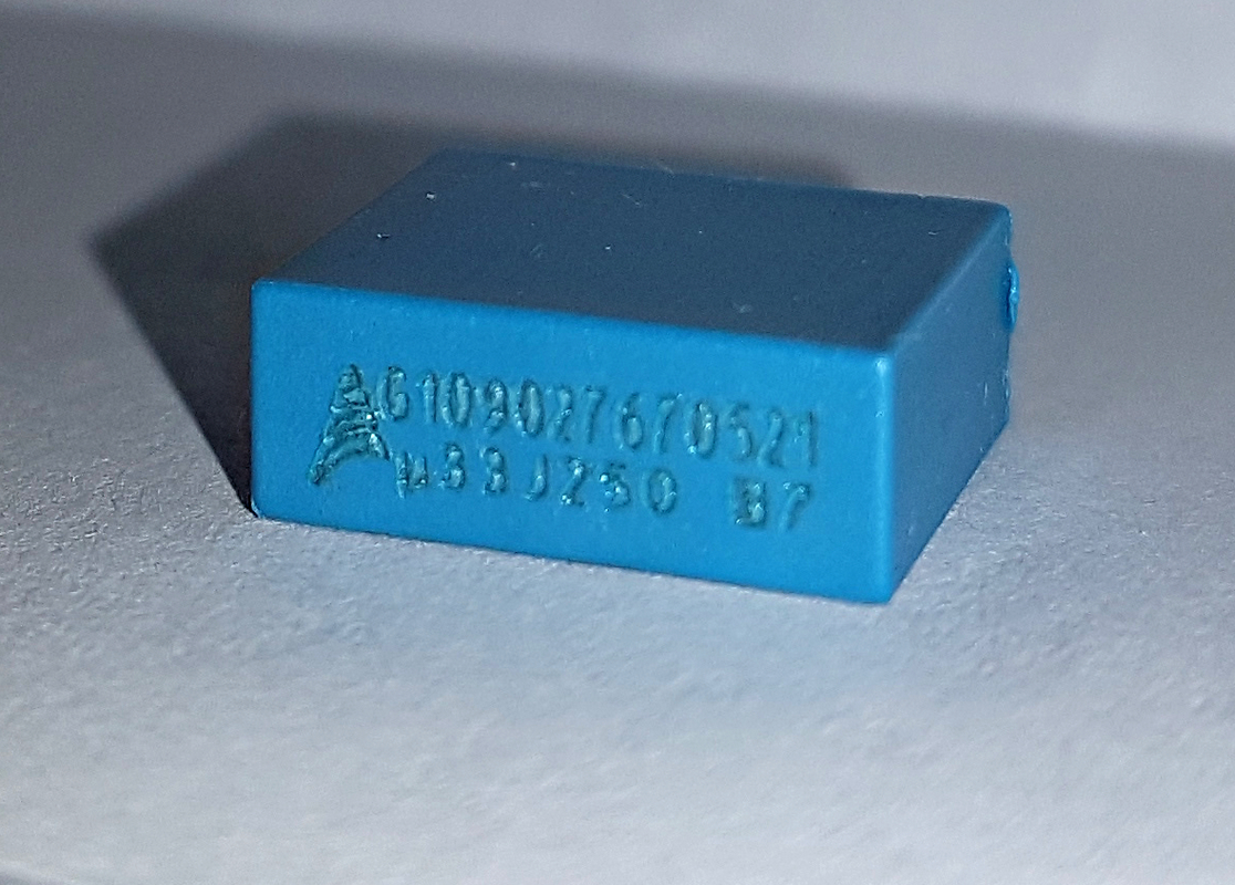

My active monitors come with a small circuit, labelled "LC trap", attached to the tweeter (Seas 27TBC/G).
The are two film caps, 2.2uF & 0.33uF and two small coils, 13uH & 114uH
* See attached photos and schematic
What does the circuit do?
Is it a filter? If so what frequency?
When the circuit is removed the sound it a bit brighter, not so dull.
Do I need the circuit?
Would installing higher quality caps be a benefit?
Much thanks !

It is a band-stop filter (also called a notch filter when it is sharp). It is set around 27kHz. Since this is beyond the audible range it would act only as a top end rolloff. The reason this type of filter was used instead of a simple low pass filter is probably because of the quicker rolloff it can provide using less componentry.
I would be interested to find out why it was considered. Is there a peak, some cone breakup, why is it optional? Is it because using it gives more of a correct response but many people prefer too much treble so it was made removable?
I doubt changing components would improve anything, but it may alter the Q factor of the notch as this is might be touchy in this configuration.
I agree with AllenB. This is a notch filter designed to deal with breakup above the frequency range of the tweeter.
If you look at the plots for that Seas tweeter, there is absolutely nasty breakup right at the range this was tuned to remove. The lack of higher frequency rolloff than 27kHz (notch recovery area) is irrelevant because the tweeter dips sharply after its breakup spike.
Higher quality components are unnecessary. Film capacitors of any sort will work fine here. This is much above the audible spectrum, and wasting money for components that serve to merely keep the speaker from creating distortion well above the audible range is unwise.
The only possible improvement would be improving the circuit to strictly remove the breakup above 20kHz without the high frequency rolloff that a low-order notch gives - More components and higher complexity, for marginal gain. Something probably has to be done about the large peak around 25-27kHz, but it's up to you to decide what.

Seems like a misguided attempt to notch out the peak of the tweeter. There are actually two notches, because there are two LC filters there, ones series, one parallel.
The impedance drops to almost 1ohm because of using both series and parallel filters, which seems a bit risky.

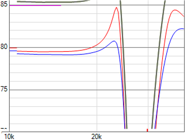

TMM, what have you used for capacitor ESR and inductor resistance. These will be critical in a circuit like this.
By and large, frequencies below 27kHz will primarily go through the inductor.The caps that are there now,
I wouldn't change any caps unless you can measure first, so the ESR effect can be accounted for. Since you are measuring you can tune instead, to give back 20kHz but leave 27kHz down.So I dont know if I should replace the circuit as its, remove it completely, or use it, but install higher quality caps so as not to affect the rest f the "audible" range.
The with and without comparison may not be the easiest choice, simulation is bound to save time. The filter seems to take a little from the lower top end (80dB baseline), some potentially due to the resistance of the coil. I have two traces compared, one has minimal resistance, the other 100m caps and 200m coils.

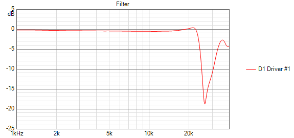

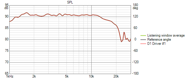

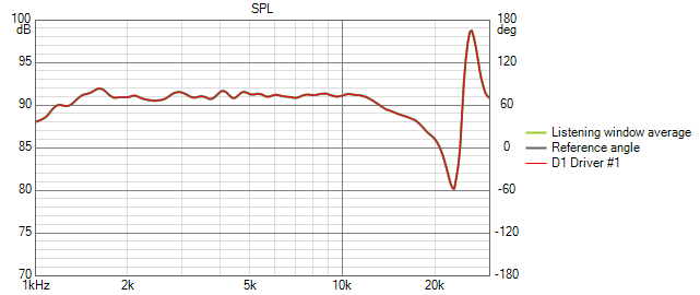

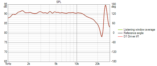

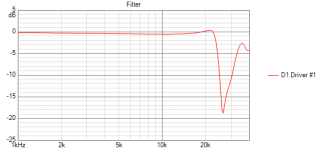

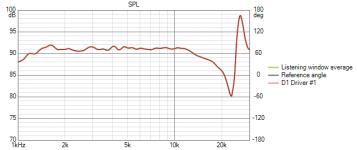

Here is a quick and dirty simulation in VituixCad.
1) First image is SPL trace from datasheet.
2) 2nd image is with series notch.
3) 3rd image is with both series and parallel filters in circuit.
4) 4th image is the filter response
Going by the filter response I say that it's a 20db notch filter. As mentioned by others the capacitor's ESR and inductor resistances will play a part in the filter response.
