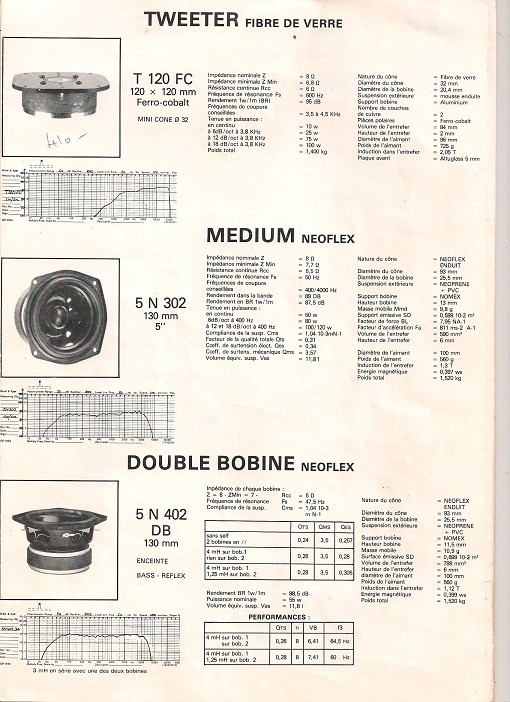

The internet seems to think that is a KEF B110 driver, which it looks exactly like. Seems Focal offered speaker kits back in the day with these drivers.
jeff
jeff

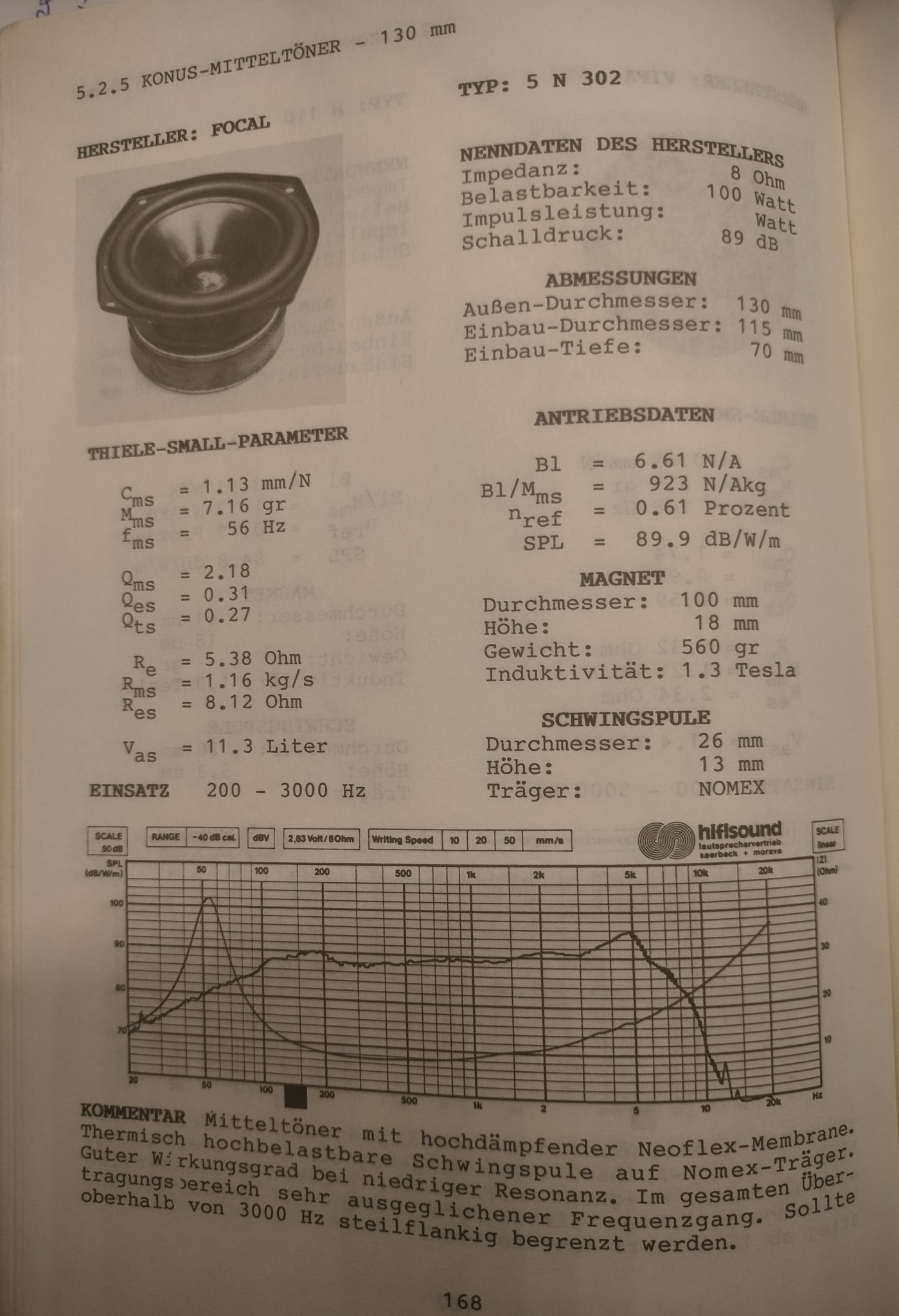

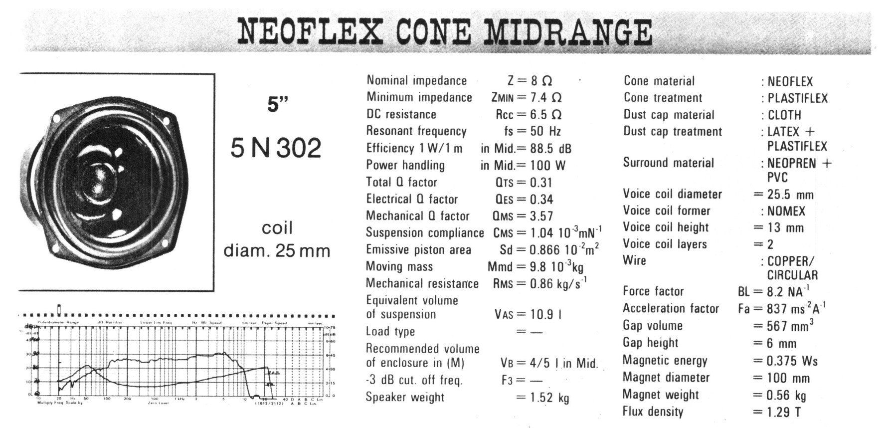

Nice work. Very interesting, these drivers are a bit different that your typical B110.Found the alternative
jeff
Thank you for the material posted.

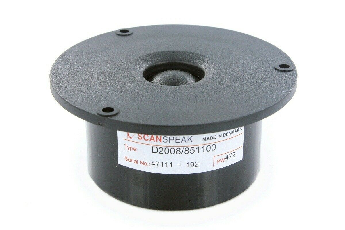

I would like to build a pair of loudspeakers similar to LS3/5a, ProAc Tablette, etc. in a closed box (no reflex). In combination I have a pair of Scan Speak D2008/⁄851100 (without ferrofluid)_89 dB.
To connect to an amplifier Single Ended with a 300B valve integrated amplifier.
I think an internal volume of about 8-10 litres is fine.
I am grateful to anyone who could provide me with a crossover diagram, as I have no knowledge of the design of this.
