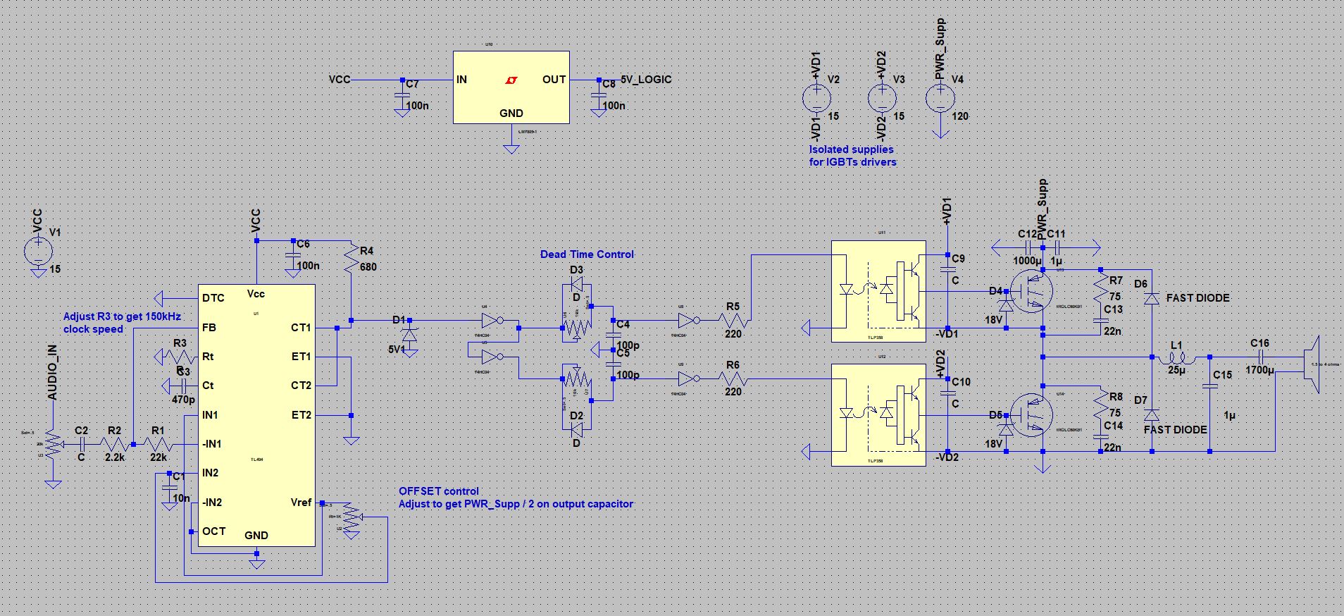

Sharing this new proto of amplifier made with...............IGBTs. Lot of people will say "cannot works! Mosfets are better" Yes, but, why not try.

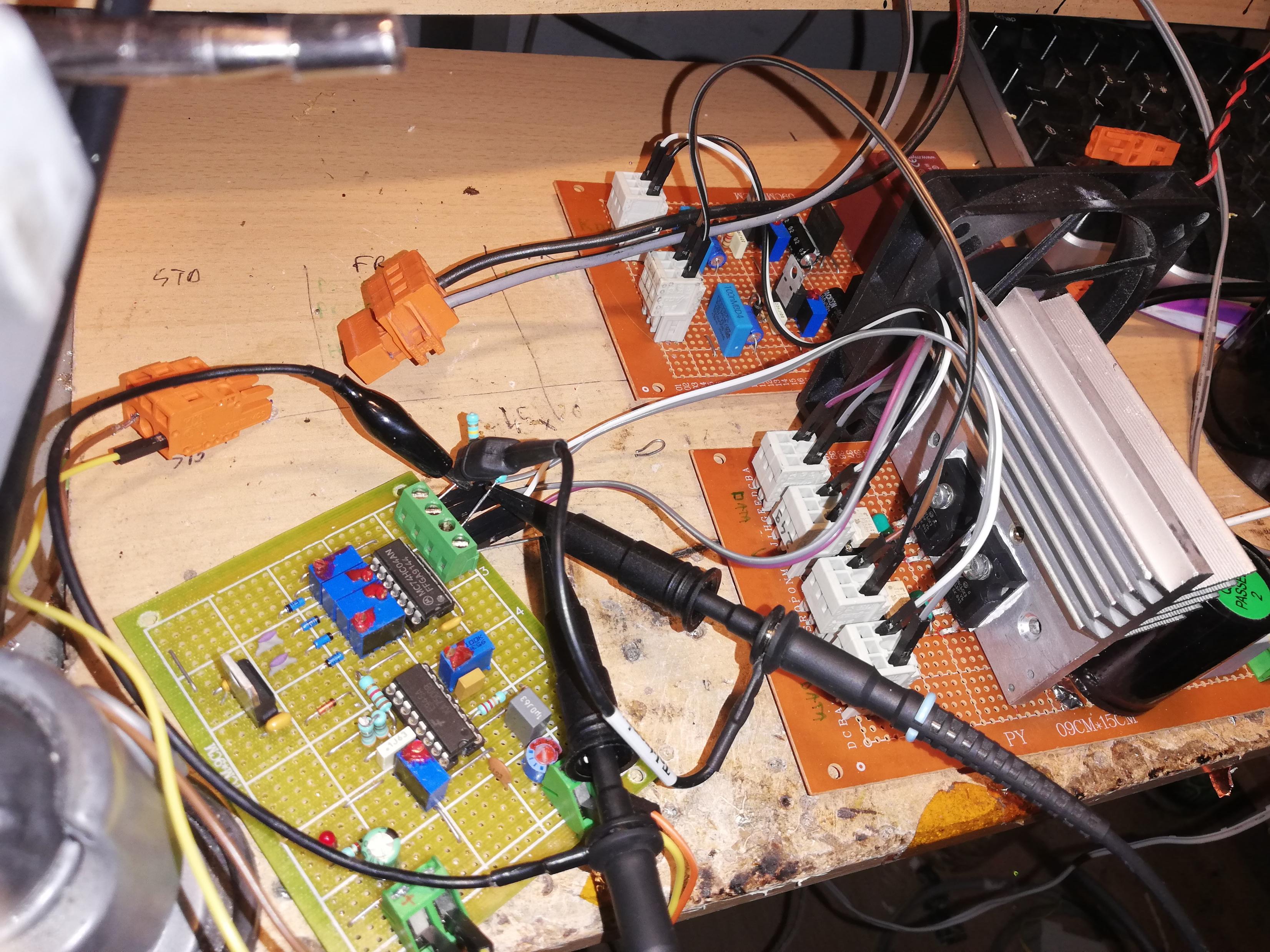

Structure used is build around TL494 working for PWM generation and high current opto drivers (TLP358) driving high speed IGBTs (GW30NC60)
At this step, with 110Vdc supply, it reach 550W (29Veff) into 1.5ohms load.
Will try to increase little more output power (to reach IGBT maximum rating).
Sound is quite good, better than some chinese amplifiers 😀

Which is the frequency of the PWM? This is the key point. IGBT's are intrinsically low, in fact "High speed" units for arc welders and ultrasonic cleaners are rated up to 33KHz, very bad for audio.

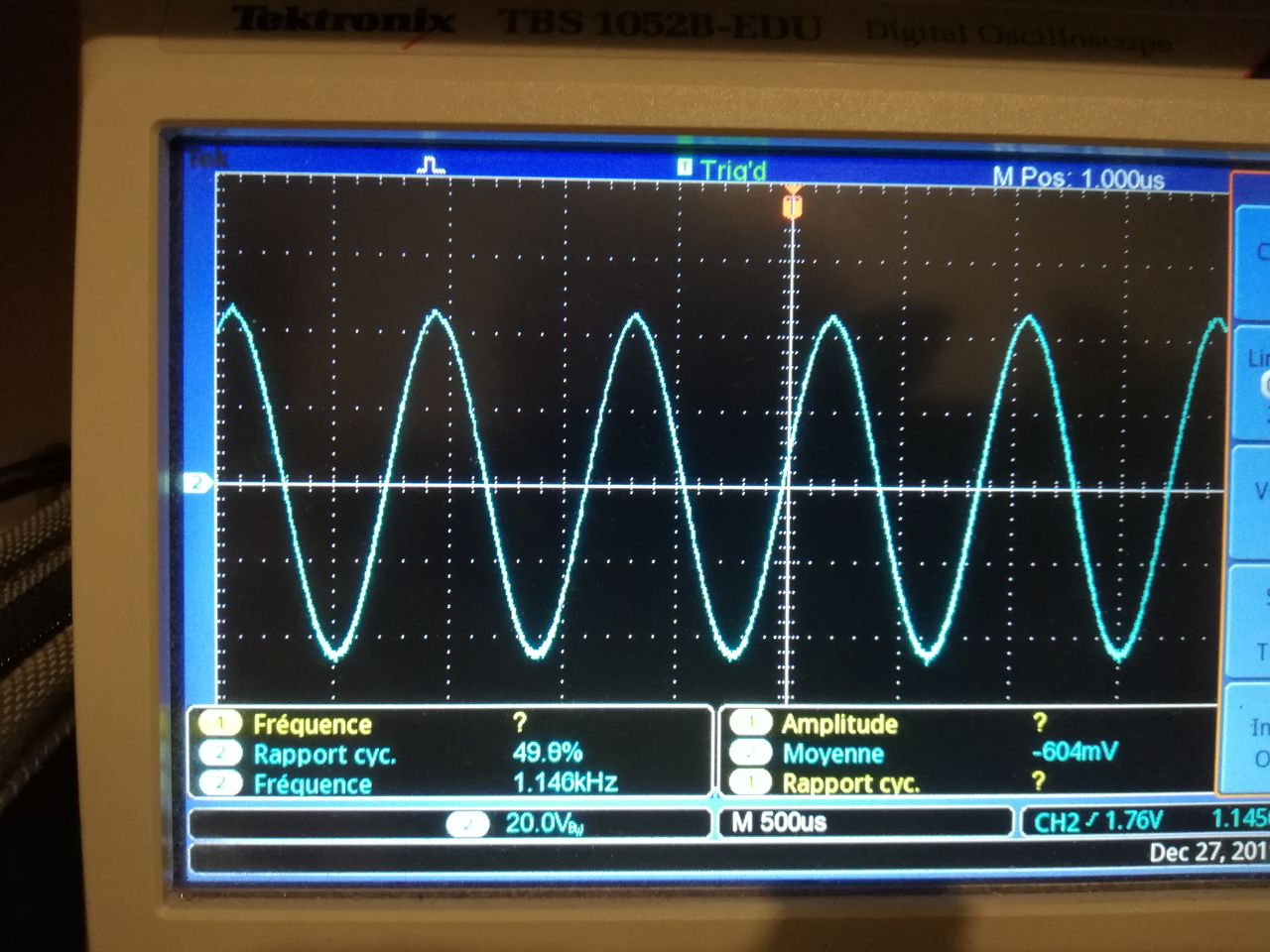

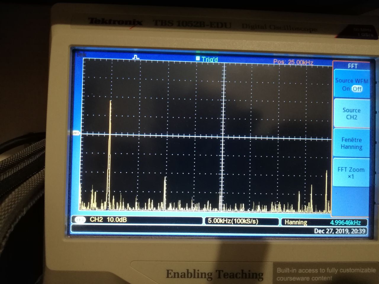

.. maybe some measurments of said amplifier?
Of course!
Pic1 : supply voltage
Pic2 : Sinus rendering

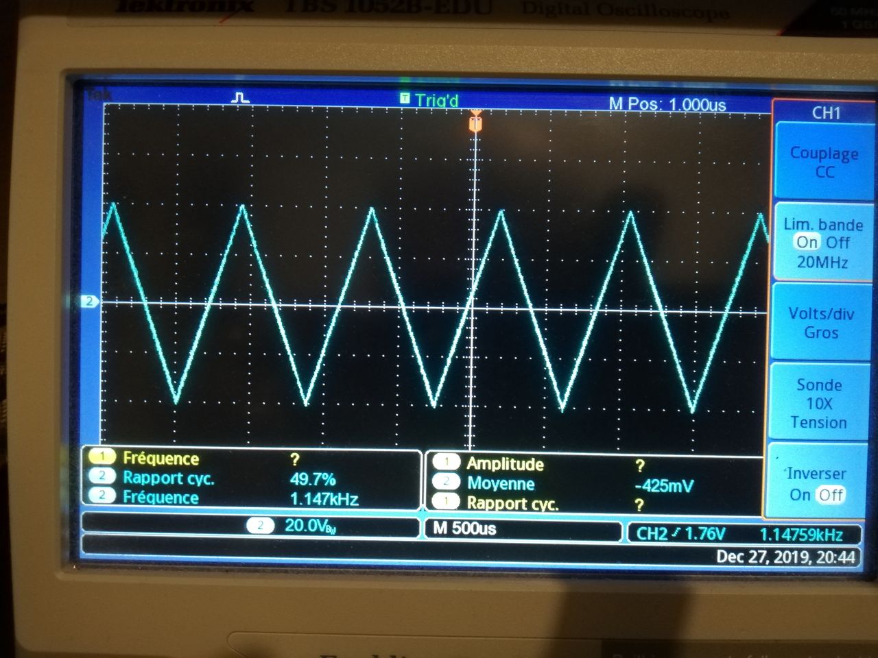

Pic3 : Triangle rendering

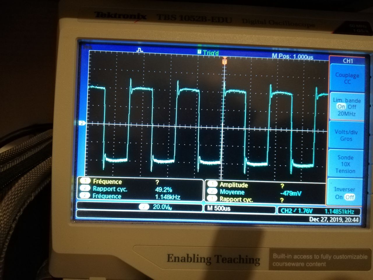

Pic4 : Square rendering
Pic5: FFT sinus 5kHz
Pic6: FFT sinus 10kHz

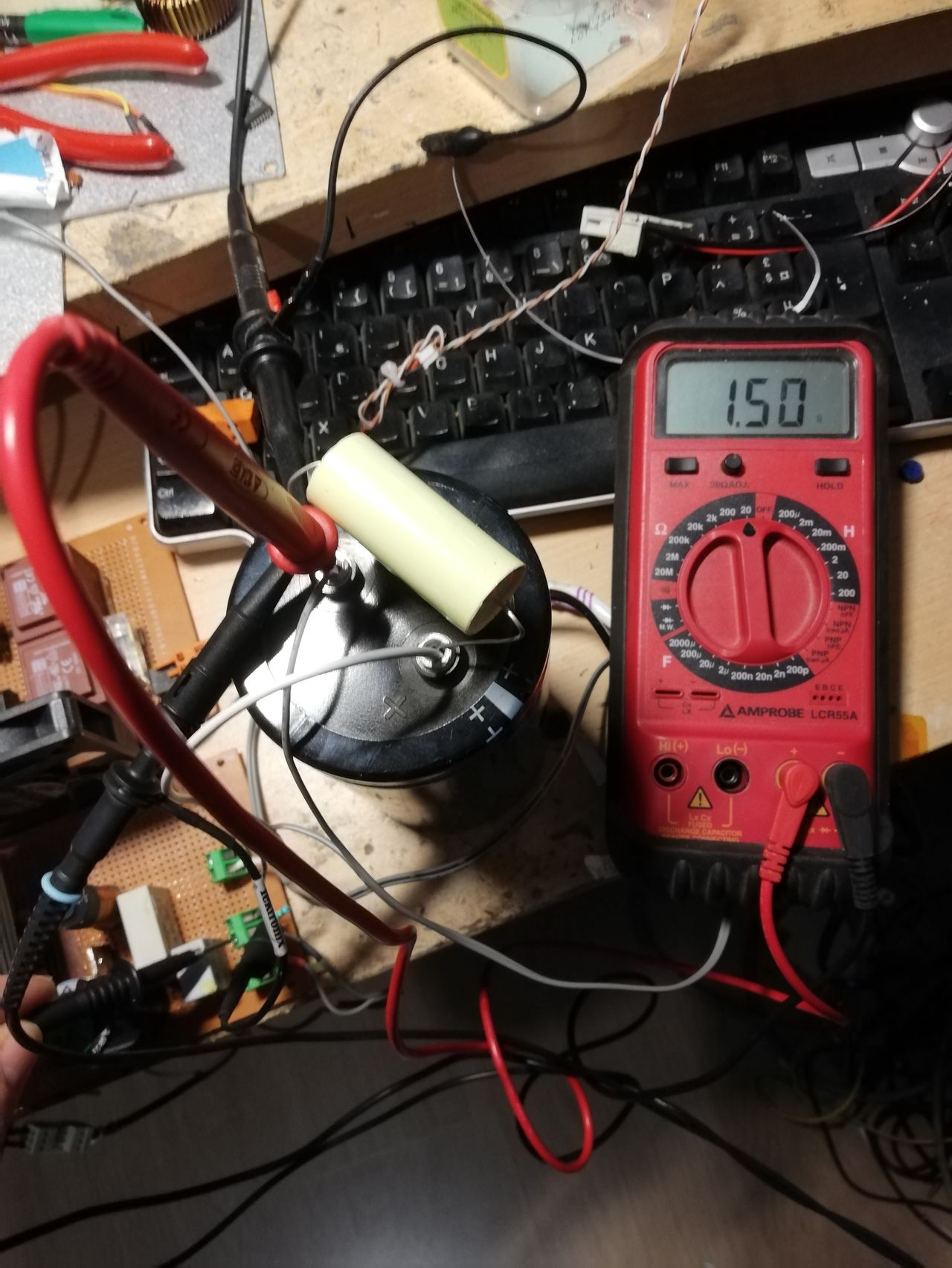

Pic7: Load DC resistance

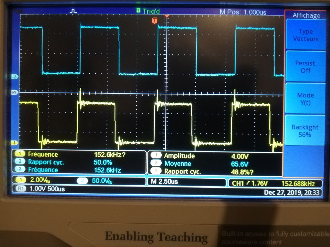

Pic8; Output voltage before LC filter (thanks to the snubbers 🙄)
So quite good result; just to much 3rd harmonic, but sounds (very) good.
I'm aware that is not SuperHyperMegaPro HiFi of the dead, it's just a simple experience to show that we can build amplifier from parts used in washing machines...

PA Discrete Class D Amplifier Schematic
The design is UCD self oscillating with post filter feedback. 270K is presumably the zero output switching frequency.
