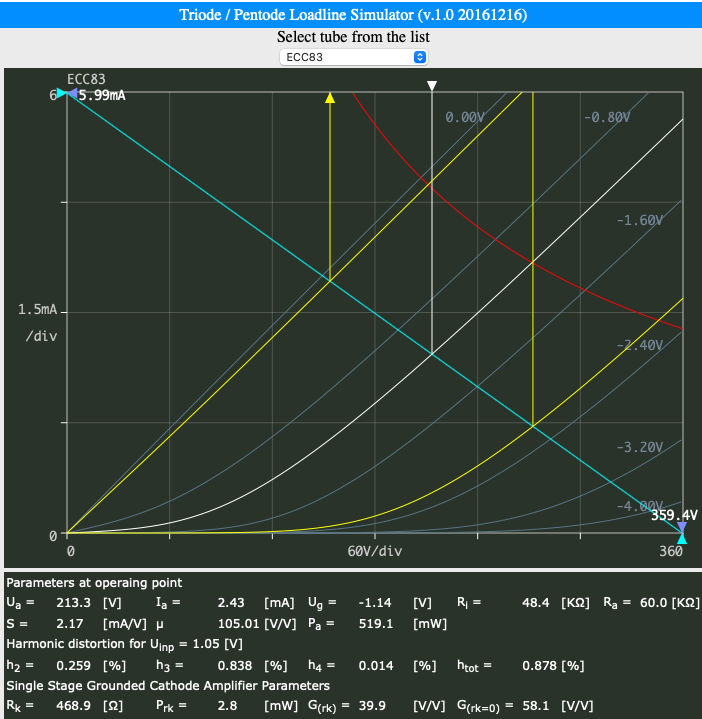

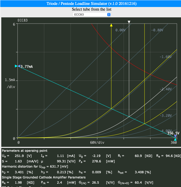

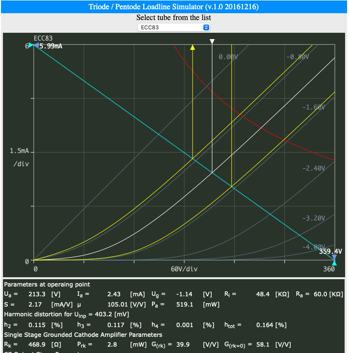

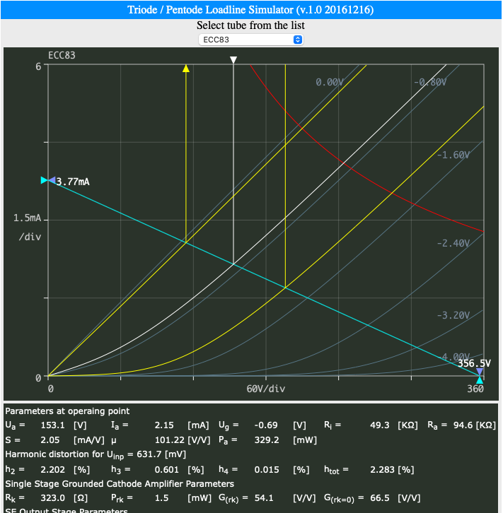

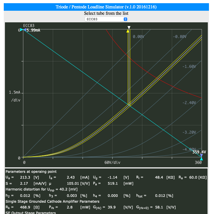

Normally the more B+ the lower the distortion, also the lower the current swing (ie flatter load line) the lower the distortion. Lastly feeding back through a cathode cap causes high amplification at the cost of increasing distortion (not sure if this is simply due to the larger input signal or the fact that the positive feedback is shifted in phase), or additional harmonics input.
If you look at the parameters in these photos, under harmonic distortion:
The increasing size of the input wave form incurs a larger distortion.
Now have a look at the same rough size input and moving the operating B+ voltage - however the web page is flawed in that you can't move the OP closer to the dissipation line thus you end up in the non-linear area and hence more distortion compared to real life:
