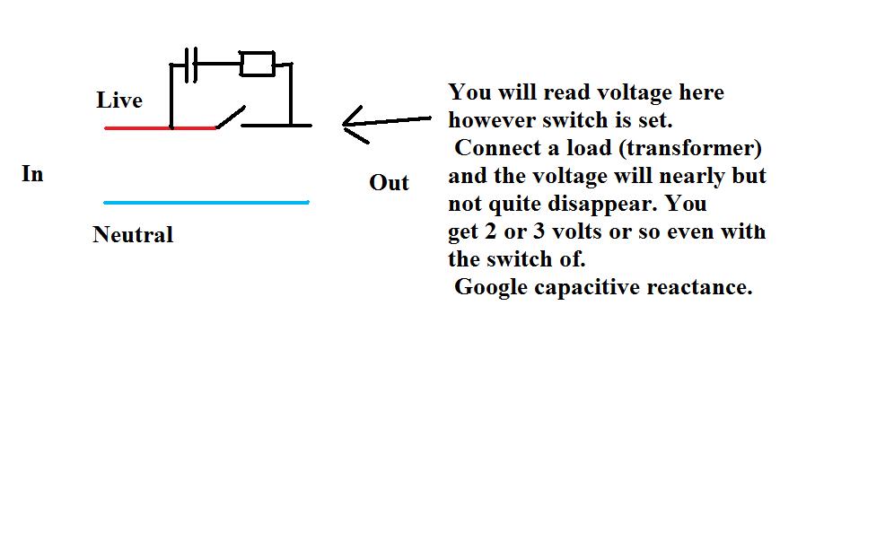

Not good with the drawing of circuits so I'll try to draw a word picture:
All I've done is replace a normal IEC inlet with a filtered one and now when I measure accross the Neutral & Live wires inside the amp that connect to the trafo I see voltage there even though amp power switch is off.

Just draw it !! 🙄 You are probably reading through some caps or something. A 0.1mfd across a switch will show voltage on the switched side with no load connected but there is no "current capability" with it. See how hard it is to explain without pictures 🙂

I think the issue is the cap across the power switch leaking tiny current causing a voltage to be read by a high impedance digital meter. The same effect should happen with a normal inlet.
However, thinking about it again, the low impedance of the transformer should stop this happening. If the unit is not actually on and working when you are measuring this voltage then I suggest you may be measuring wrong or have a faulty meter.

Is the transformer actually connected when you are getting these strange readings? (ref para 4 in my last post)

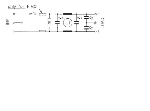

Sounds like leakage current. The FN-9246 series is rated with
373uA to 797uA leakage (depends on size of filter) if you don't
have one of the medical rated ones (FN-9246B series) which
are rated for only 2uA leakage. I doubt that the salvaged model
is one of the B series devices?

Aha, it turns out that the tap on the tranformer I was connecting L to was just a dummy tap (not connected to anything). Whit transformer properly connected up the voltage is correctly reading zero when switched off.
So just to clarify for my understanding: without any load the N & L will read nearly full voltage accross them but at very low current due to the cap accross the switch?
