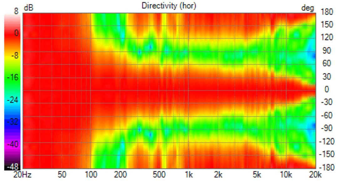

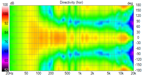

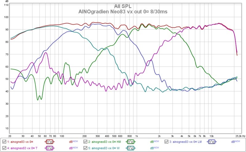

My application 10 years ago and still going strong https://www.diyaudio.com/community/threads/aino-gradient-a-collaborative-speaker-project.231353/
ainogneo83 vx out 0¤ all ind 112.jpg ainogneo83 vx out 40ms 112 Directivity(hor).png ainogneo83 vx out 40ms 112 norm Directivity(hor).png

I decided the same years ago. I think this idea or something like it would be most interesting to a 2 channel and/or "no sub" purist type of audiophile. Although I wasn't ever really a 2 channel purist, the goal for me at the time was to have dipole mains with solid response down to 30-40Hz without quite the massive size required for traditional dipole baffles at those frequencies, and a smooth (cardioid) transition from the narrow dipole response to omnipolar sealed response, so that crossing over to a multisub system distributed around the room at ~60Hz or so would also be mostly seamless.
But the idea never made it past thought experiment to explore the practical implementation and tradeoffs. I did have an email exchange with Linkwitz at the time. I would summarize all of his comments as "yeah, maybe". 😂
Instead I shifted to a variant of Keele's CBT. Still a glutton for punishment I suppose.
