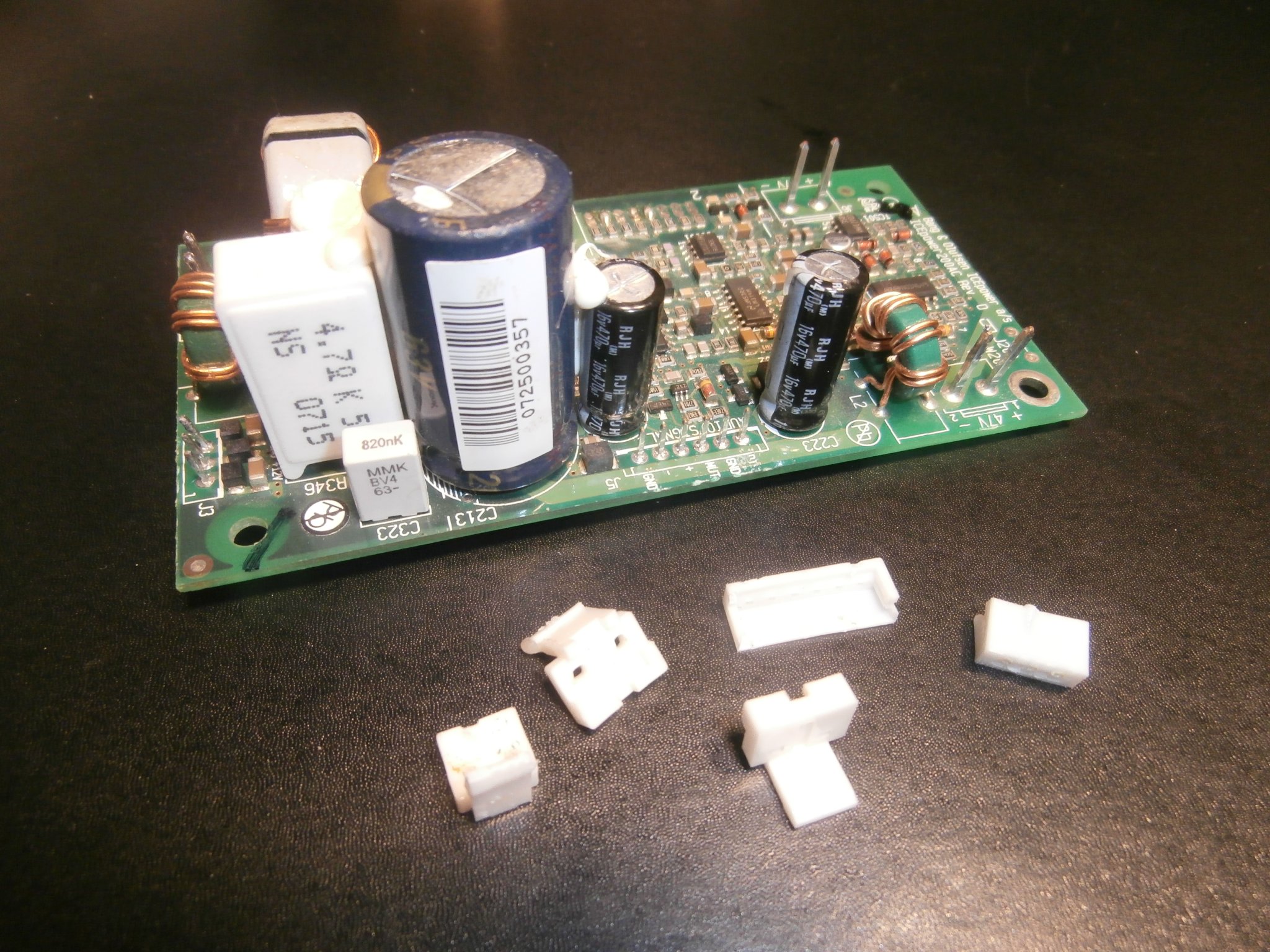

JST Plan B:
Just remove the JST headers. Heat the white plastic, and it pulls off without much difficulty. Then unsolder and remove the individual header pins. Solder wires directly in place or solder terminals. Soldering is always a better connection.
Any thoughts?
Any thoughts?
Plastic part of the headers removed.

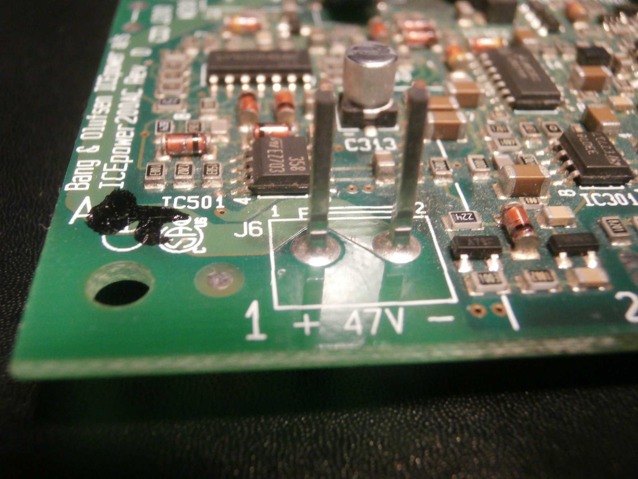

Detail showing the dent in the pins which helps retain the plastic piece.

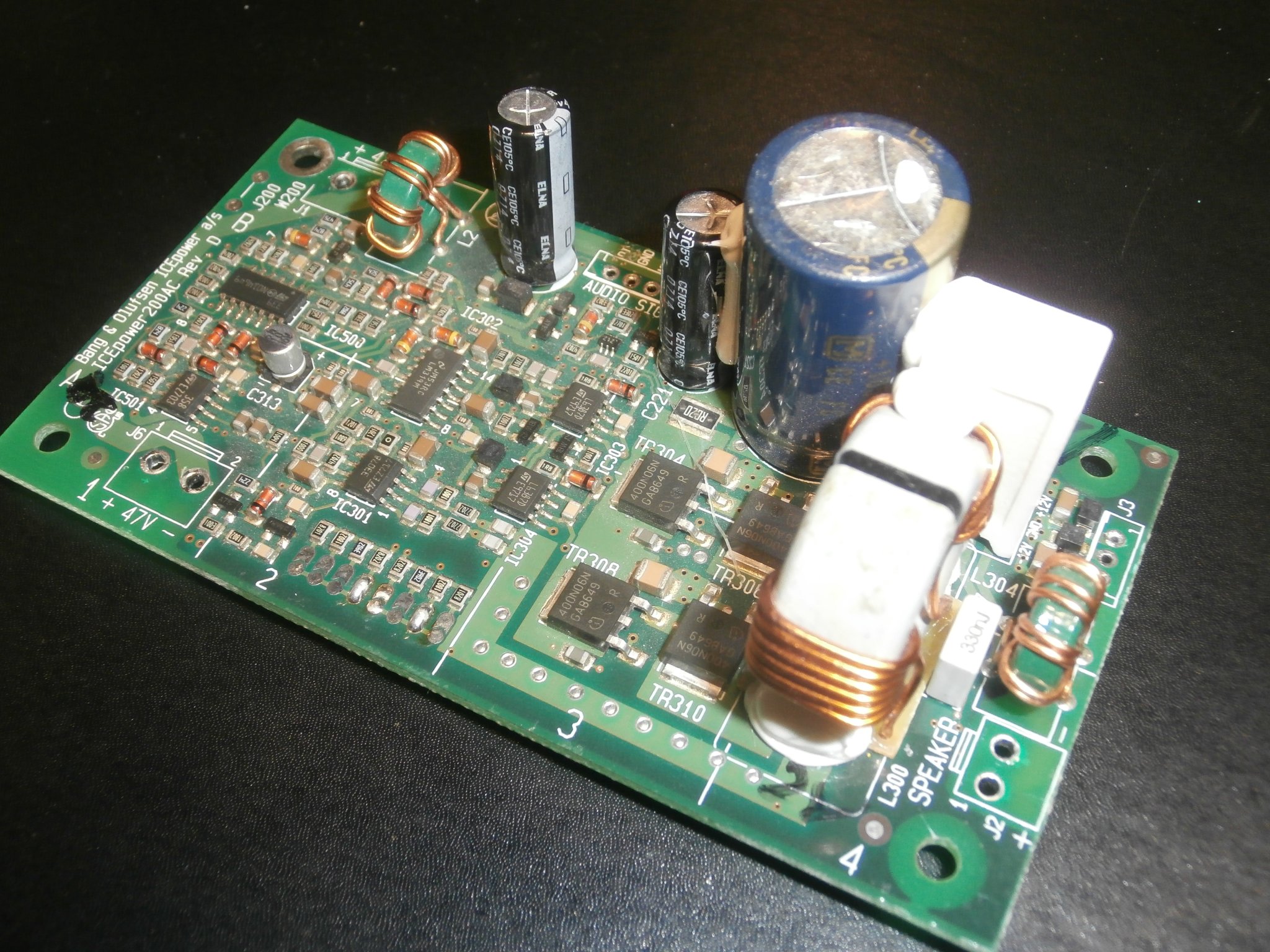

Icepower 200AC JST free.
VH holes measure 1.5mm (0.059") with approximately 0.25mm ring. It would probably pass 15 gauge wire.
NV holes measure 1.5mm (0.059") with approximately 0.5mm ring.
EH holes will easily pass a 20 gauge wire 0.81mm (0.032"). It would not pass an 18 gauge wire. The hole is probably 1mm.

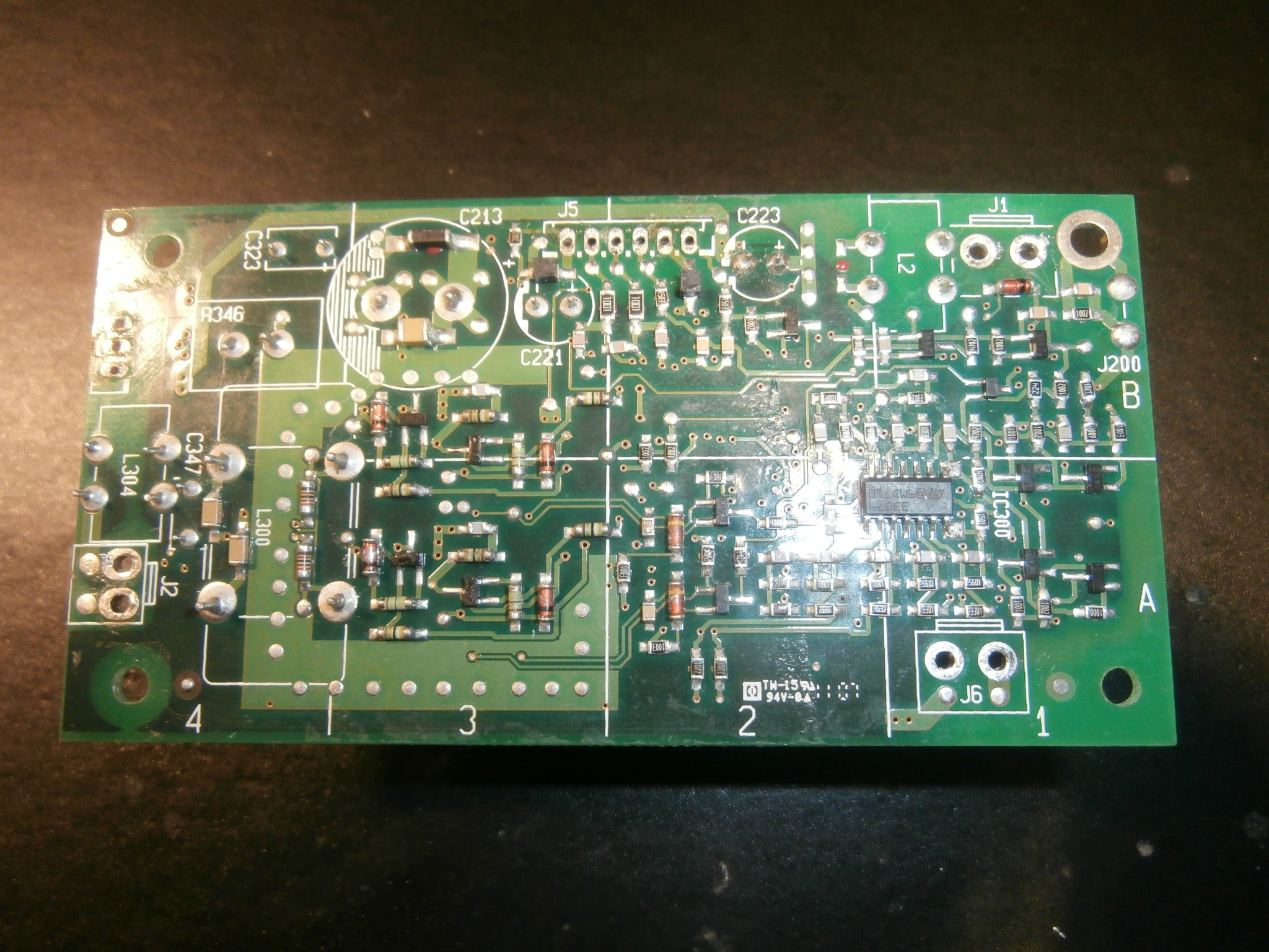

The above ring dimensions are for the top of the PCB. On the bottom:
VH ring is oval 1mm top and bottom at the widest portions. Pad is 4mm x 3mm.
NV ring is 1mm and round. Pad is 4mm x 4mm.
EH ring is oval 1mm top and bottom at the widest portions. Pad is 3mm x 2mm.
