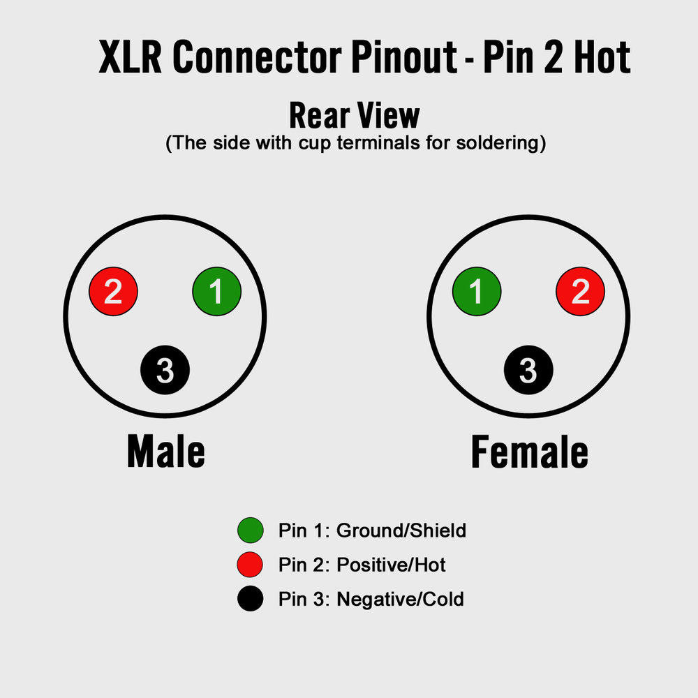

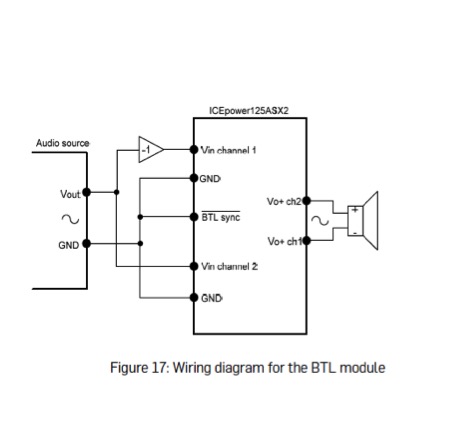

I am building two Icepower 125ASX2 amplifiers and I have a question about the wiring in BTL mode figure 17 in the data sheet (see attachments).
Does the little triangle (-1) means that Vin Channel 1 is to be connected to the Negative (3) on the XLR connector (see Attachment).
The longer I look at it the more I doubt, so a conclusive answer would put me out of my misery..

The small triangle in the ICEPower diagram indicates Inversion ... For a Bridge Tied Load to work you need two signals 180 degrees out of phase so that one amplifier is going positive while the other is going negative with identical signals... the speaker is then connected across the positive speaker poles.
There are a number of ways to achieve this. The best is with a dedicated phase splitter built into the same chassis as the amplifier board.
You can also cheat as @riritronic has suggested. It will work, but you may lose some of the noise immunity of the balanced/differential output of your dac. Pin 2 to left channel, Pin 3 to right channel, Pin 1 to ground.

If your pre amp is symmetrical, you do not need to use it in an asymmetric way and then use an additional stage to make it symmetric again. Your signal does not get better from another hand full of op-amps switched in between.
Just go direct from your pre into the ICE amp, one half with hot, the other with cold, ground if desired. Don´t forget to set the BTL sync jumper.
The picture you posted, from the ICE manual is for an asymmetric signal source, where another inverting stage with gain 1x has to be used. This is not your case.
Ah! Thank you for your explanation. I will go ahead with the build as you described.
Sure thing ... it will work nicely. The only drawback is, no gain controls, but that's not a big problem so long as you have a volume control somewhere before it.
I would suggest you do need to hook up the grounds. You are likely to get a fair bit of hum if you don't.
I am doing the same...question where does the ground wire go to from the board? It seams like it is redundant since the board is grounding it to the chassis too. I am not an electrician, and a friend of mine is wiring it for me.
Does the 3rd pin on the XLR get hooked up too or is it left unused? If it is to be hooked up...where does the 3rd wire on the XLR go to?
