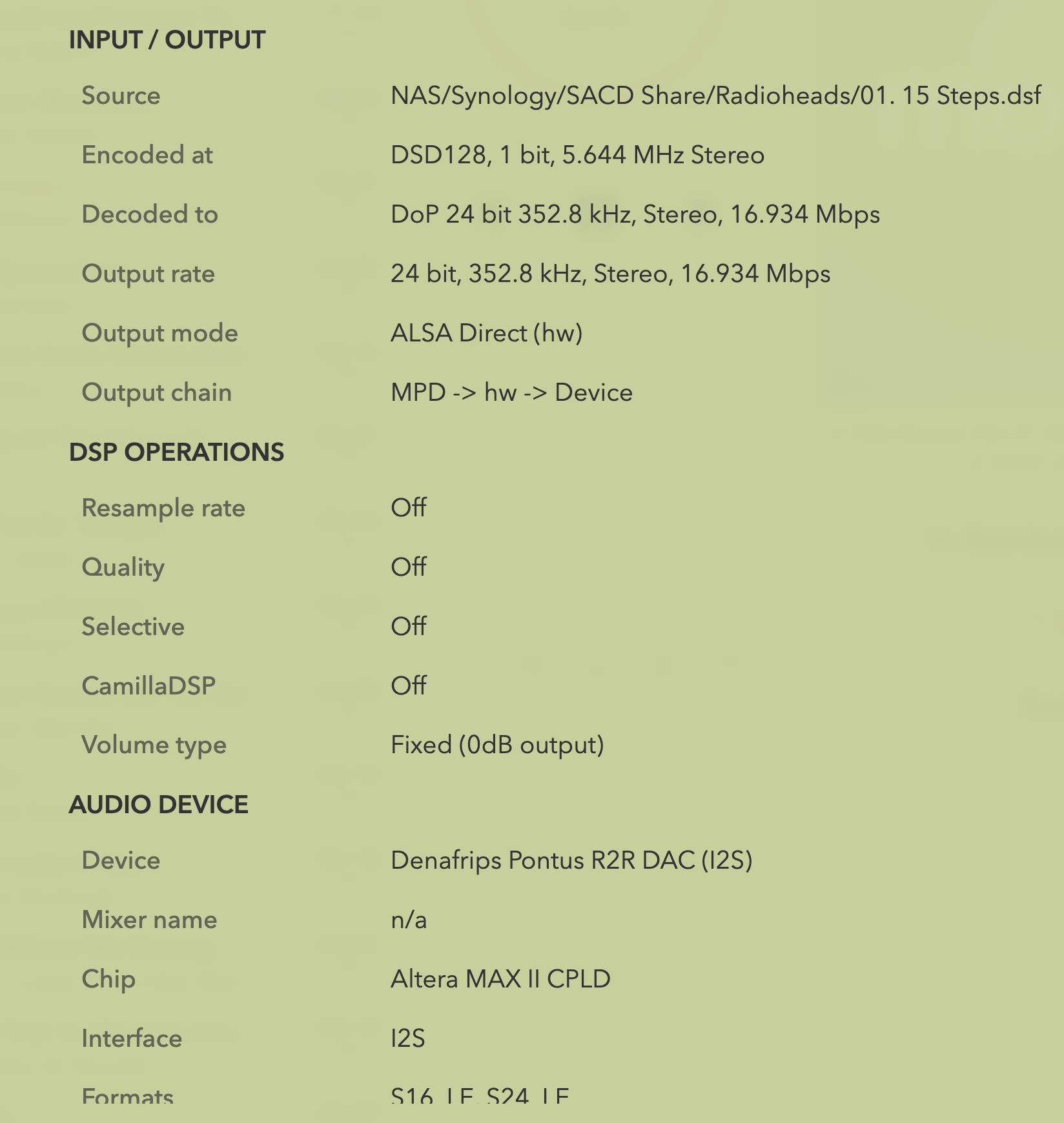

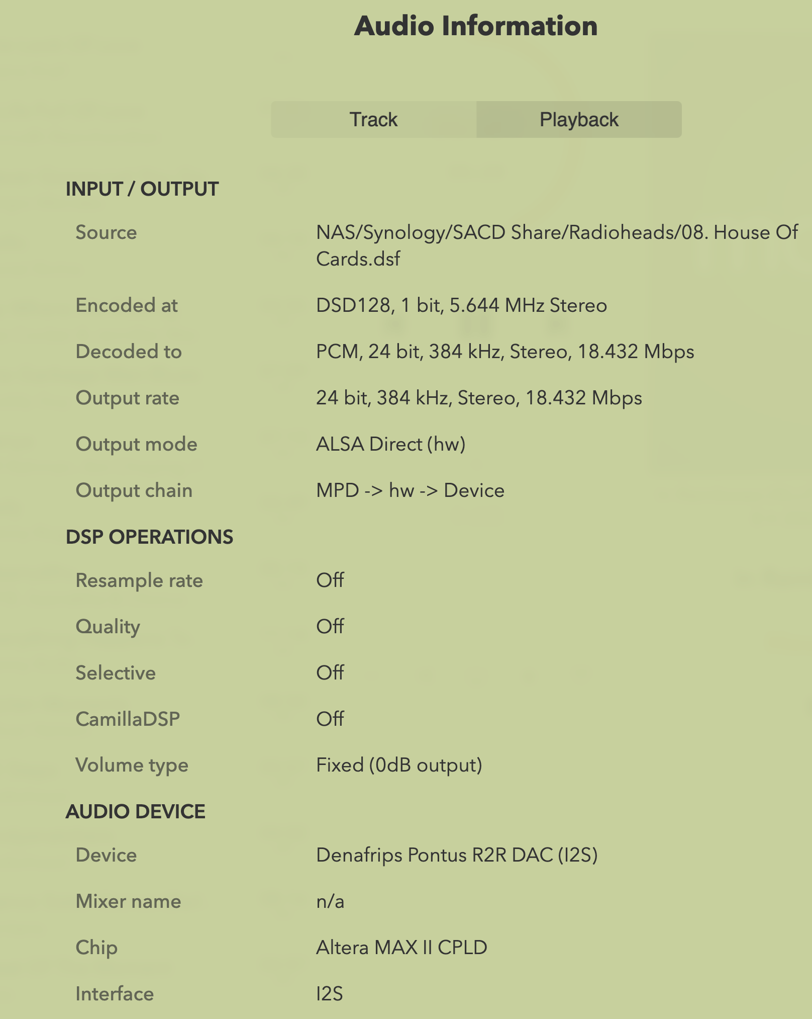

@Thorp @MarcelvdG this is exactly what is happening in Moode. PCM conversion is happening, likely because I chose Native DSD. Alas I'm not able to set to DoP 🙁 Kinda stuck on next steps.
@Thorp @MarcelvdG This is what is happening when I choose DSD DoP, it looks like the output is in DoP and transmitted as DoP, but for some reason Pontus DAC is not handling it well? Because is no sound at all from the speakers. I believe Pontus support DOP over I2S.

Please note that you can't play that file, Houese of Cards.dsf, which is DSD128 on this HAT without software re-encoding to PCM! It is a false advertising on Alliexpres. You can read the real specs. here , same board and layout as your board, different PCB colour.

The board looks similar to mine and says supports only DSD64 with a max bit rate of 24/192 khz. But in my screenshot above when it converted DS128 to PCM it was able to hit 24bit/384khz, so I'm a bit confused.

DoP conversion must be provided by the player, the RPi I2S drivers do not change the data stream to convert DSD to DoP.
