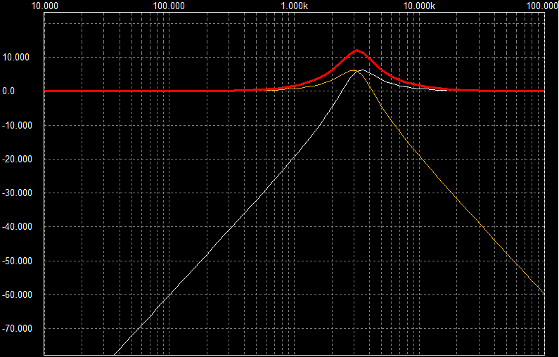

going from a 6db/octave butterworth lowpass @ 3200Hz to a 12db/octave chebychev @ 3200Hz made the midwoofer brighter, alot brighter.
I thought it would have cut out more of the higher frequencies not let more pass, what gives?
reason for going from butterworth to chebychev was that's what parts I had lying around to play with atm. same coil but added a 12uf cap.

Is it possible to see the xover diagram? I think Chebychev have some ripple in the pass band don't they? If you got a few db peak around 3k Hz where the ear is sensitive you could well get a "brightening".
With using the Chebyshev, you're getting a summing at the crossover frequency of around 6dB. If you want to use that crossover, don't crossover the woofer and tweeter at the same frequency. You'll get better summing by crossing over to the woofer lower and the tweeter higher by a factor of around 1.5.
So the woofer is calculated at 2133Hz and the tweeter at 4800Hz to give the best summing at 3200Hz.
Odd choice of crossover... any reason you went away from the 1st order and went for the 2nd order Chebyshev? Just curious and not being nasty.

here are the screencaps of harris tech x-over 2.0 I used to design these x-overs ....
I went from 1st order bw to 2nd order cc cause that's what parts I had lying around to play with until I order some new parts for a 24db/octave lr x-over. After listening to this 1st order bw for a while, I might just order some good parts for it and leave it like it is, sounds pretty nice.

After 2 weeks of daily banging my head off a wall, i can tell you to measure and build those passives for your drivers exact impedance dude. They will not be the same at all if you tell it generic drivers.
That's right, Chebychev filters have ripple in the crossover region.

I forgot to mention the fact that the tweeter wasn't hooked up during the test, I just wanted to see what effects the crossover had on the woofer. Seemed to remove some bass and let alot more treble through.
Madmike2 obviously you've never used x-over 2.0 ... I just put in "generic woofer and tweeter" for the name, specs are correct, just did that quick for the screenshots.
😱 I C no i never used it. Just assumed from the screen shot that it automatically assumed car audio spec 4 ohm drivers. Which you know as well as i will not be even close 😀

From the diagram it seems that the 2nd. order crossover has no impedance compensation on the low pass section. This can cause the shunt capacitor to resonate with the upper roll off of the driver causing a peak, including a zobel in the woofer circuit fixes this. In cheap commercial systems they just double the capacitor value. I hope this helps.
