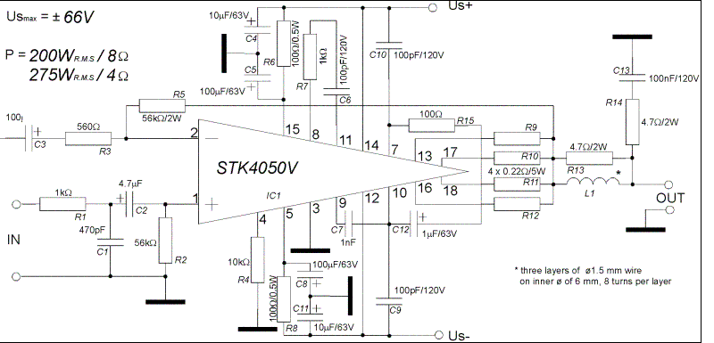

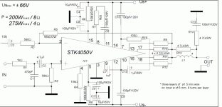

but in the site not have a circuit of STK4050V
STK4050 is there.. You didn't look very carefully did you?
http://www.datadart.com/al/sanyo/STK4050V.pdf
