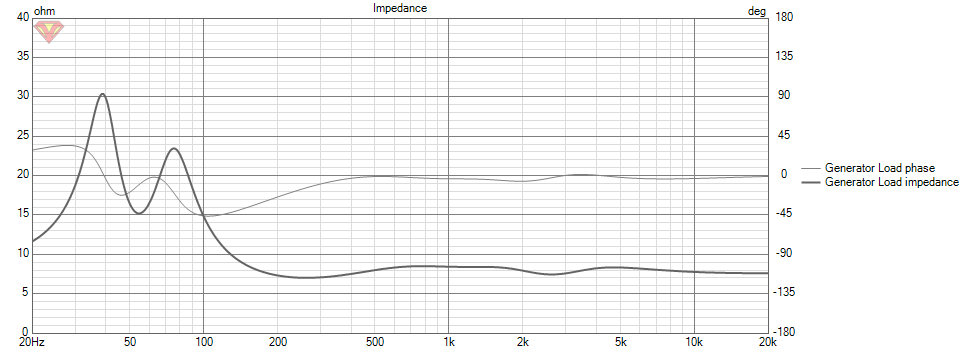

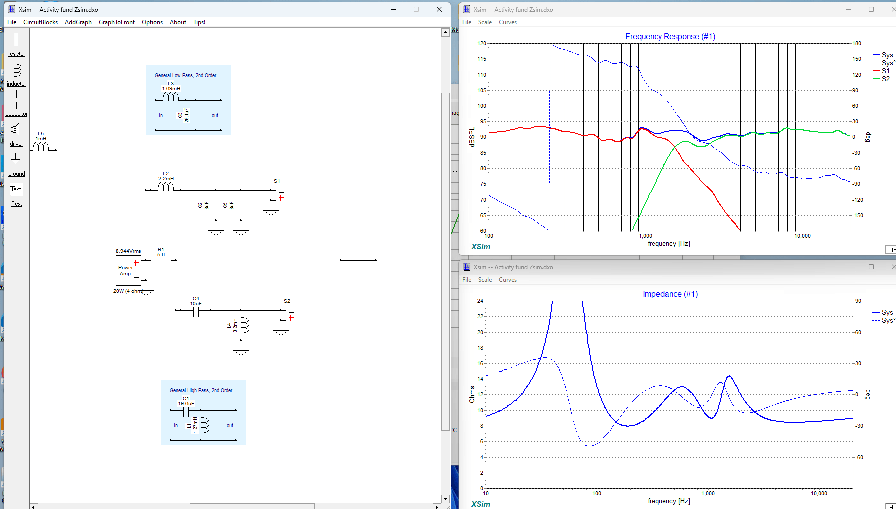

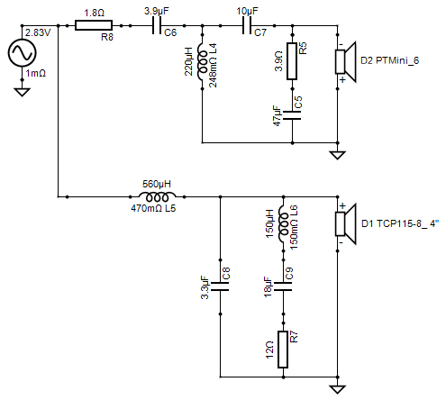

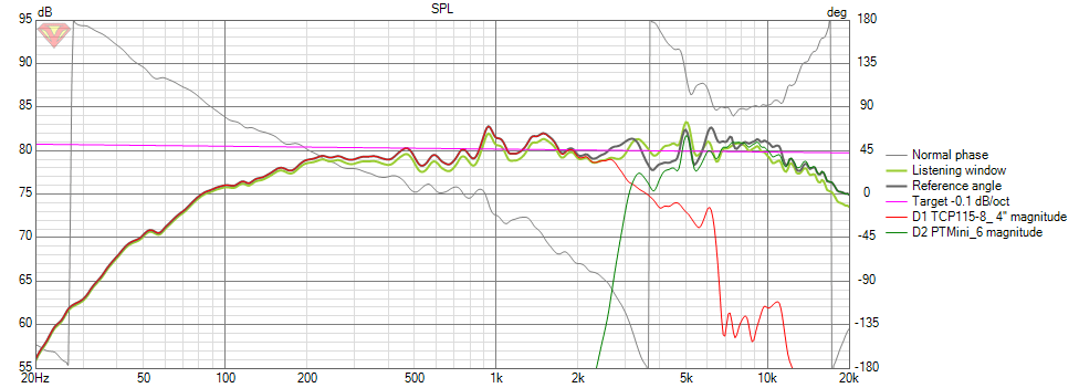

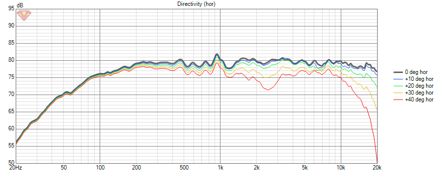

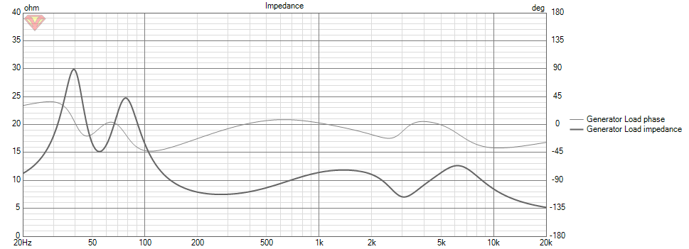

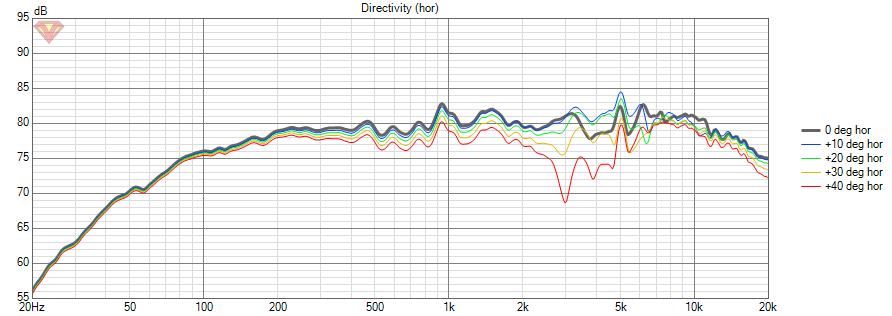

I need help with the impendence of this Xover

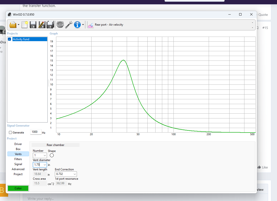

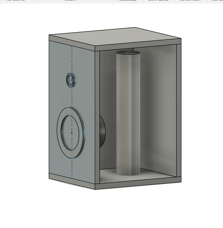

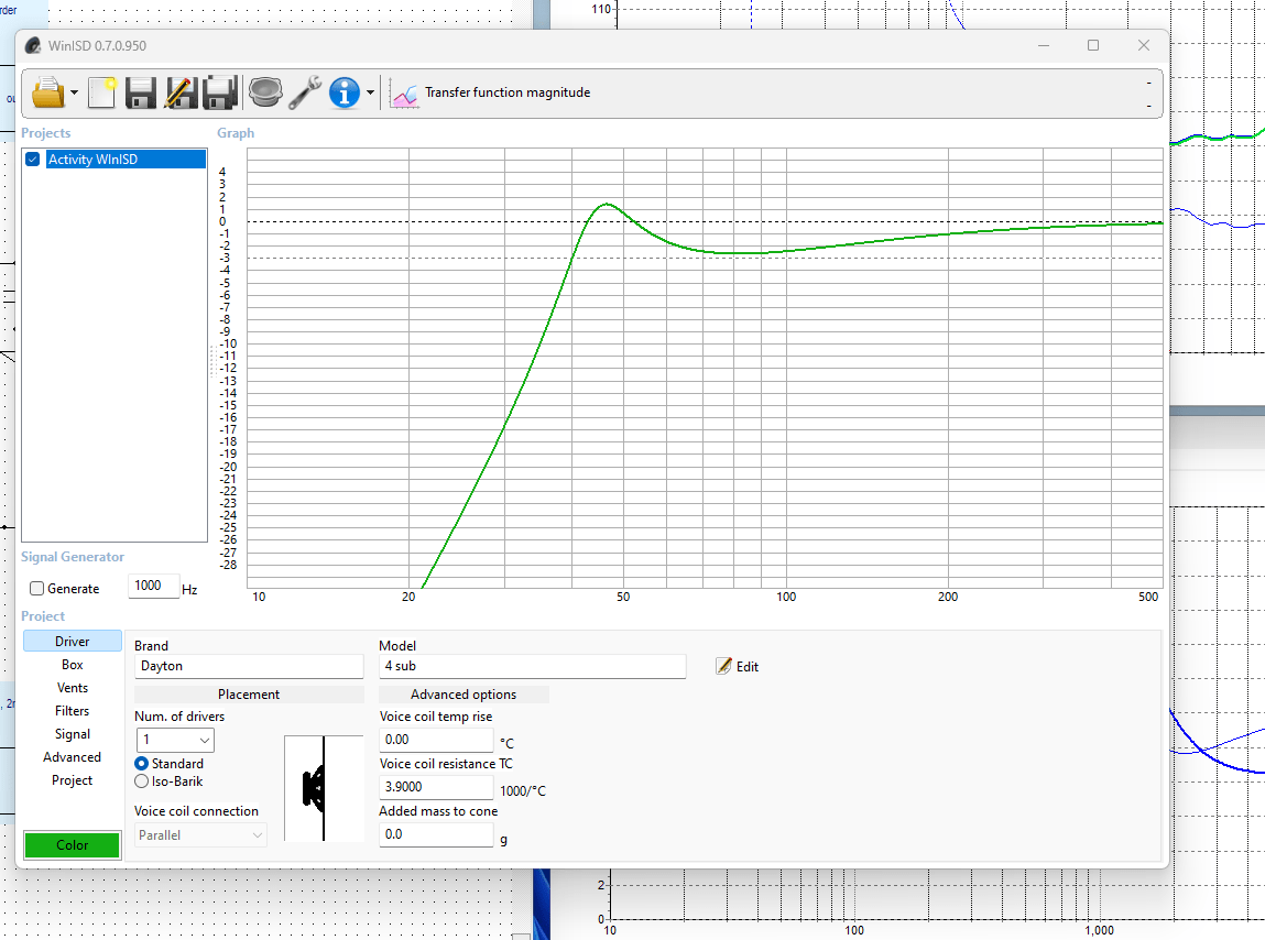

Yes, the port is on the bottom. Of course there will be rubber feet on it. How else would I create a down firing ported enclosure?
Are you suggesting I was planning to put all of this work in and then place the port flat onto another flat surface?
