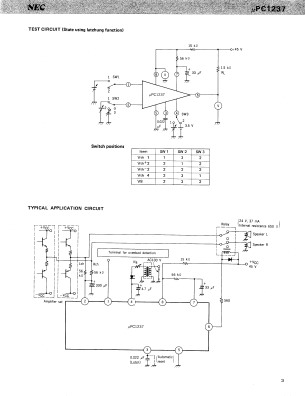

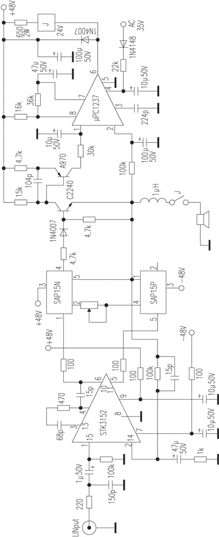

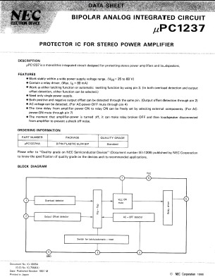

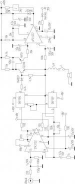

Scmatic you have requested
This is all i can find about the STK chip. I was interested too but i can't figure out what is the attached schematic for. I found it on a chinese page and as long as i don't speak/read chinese... Maybe you guys figure it out and post the modifications.
Bye!
Bye!
Sorry for looking stupid in my early message. I was in a hurry. My boss was coming and I had no time to look at the schematic and understand it. You can get the SAP's datasheets from http://perso.wanadoo.fr/jm.plantefeve/comp.html.
Bye.

id say the 3152 is infact a pre amplifier ic
... ill have to look into this a bit more... wonder if it is interchangable with STK3041 or 3042 etc.... maybe the 302-000 or 305-000 ic series... mmm one must wonder...

by the way...the STK3152 I II III is a voltage amplifier driver...you will need a power darlington transistor to complete..maybe this can help you...i'm not guarantee you if it's working....sansui and yamaha amplifier is the one who make this in their maniufactured power amp...
