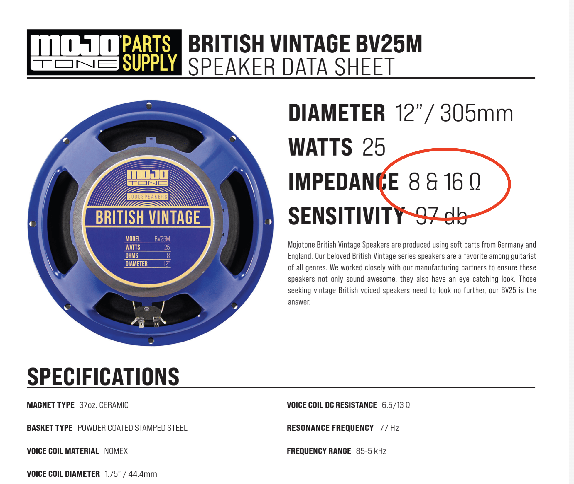

The speaker was going to be something like a Mojotone BV-25M 25W speaker
https://www.mojotone.com/British-Vintage-Series-12-BV-25M-Speaker-16-OHM-25W-1-5

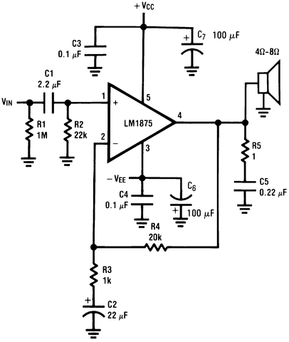

I think that I will combine the provided schematic, with this schematic of the LM1875. Is this possible? Just so that I am able to keep everything on one PCB.
There are LM1875 boards available on ebay. There are no single supply boards, only split supply boards. +-15 at 1 A would be suitable.
You can also buy with the parts loaded, but the IC might be fake. You get real LM1875 from newark, digikey, mouser, alliedelec.
Okay, notice it is a 16 ohm speaker? You'll need a higher voltage drive in order to get the power you expect out of it. That chip will drive it fine given a proper heat sink.
I see it's out of stock as well, but 97 dB/watt is an easy load at least. If they have an 8 ohm version you would be better with that.
