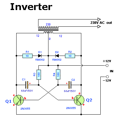

in my project the capacitors always overheat and explode ( i us in 160V 68uF ) what can i do that the capacitors don't overheat and explode....????
the parts:
R1,R2 = 10 ohm, 5 watt
R3,R4 = 180 ohm, 1 watt
C1,C2 = 68uF, 50 Volt (or higher volt)
D1,D2 = 1N4002
Q1,Q2 = 2N3055
T1 = 220 / 24ct Transformer

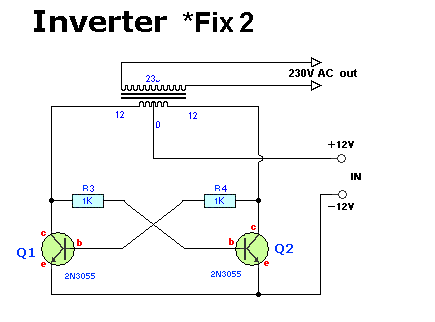

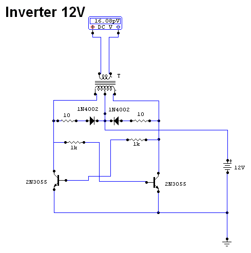

The way i used to build these, C1 and C2 did not exist.
The base resistors were 1k and went to the collector of
the other transistor.

Delete R3, R4, C1, C2
Tie resistor 1K from base of Q1 to Collector of Q2
Tie resistor 1K from base of Q2 to Collector of Q1
You probably want to delete R1, R2, D1 and D2 too.
Its about 50/60 hz, and is definitely NOT a sine wave.
Exact frequency depends on the transformer.
Very similar to the heathkit inverters of years ago...
What do you want to do with it???
With the transistors specified it is good for about 200 watts
max.

I agree. You are going the wrong way down a one-way street...and there's no exits for miles. The schematic, either one, will not be high enough power to do what you want it to do and I recommend just getting a car stereo amplifier. As a side bar though: The home equipment should work fine with a squarewave 50/60 Hz but it is not recommended. The original schematic was an attempt at a astable multivibrator, also called an emmiter-couple oscillator. The "fix" was an attempt to change it into a similar circuit called an Royer oscillator. A "Royer oscillator" is a low power converter type circuit. Usually working a few kilohertz to a few tens of kHz. This would not be the type of circuit t use for a 12V automoblie system. You need a supply that is regulated and used a full-bridge configuration.
